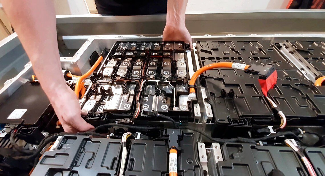

To be fair, I don't think there any batteries that have the thousands all in the same pack, but those smaller packs are all in the same overall metal container and even with the fireman port, it does assume that they can actually arrive at the scene before the battery gets to the thermal runaway position, which is just minutes or even seconds as can be seen in many of the online security cameras that capture many of them.
The modules are still packed extremely close to each other as can be seen in this photo, so it doesn't take much to set the other modules off.
close-up-of-a-mechanics-hands-disassembling-an-electric-car-battery-inside-a-mechanic-shop.jpeg
EV's have been made with cell to module, module to pack method.
There's innovations to switch to cell direct to pack. Example is BYD blade battery directly into a pack.
There's also a design (name escapes me) that is doing cell to module and then use structure of the vehicle as pack boundary and support.
