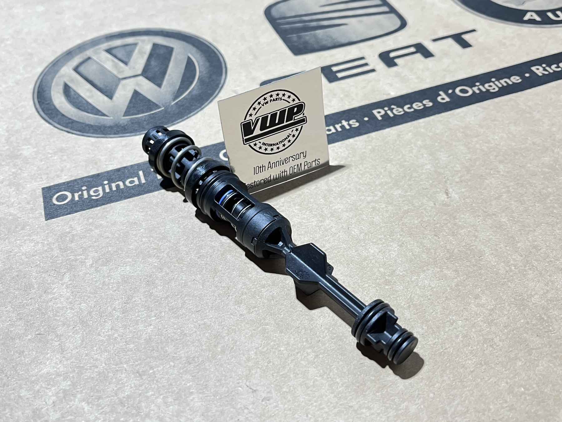

I know you changed the filter earlier but the drain rod that sits in the centre and connecting to the inside plastic filter housing cover. It usually comes out when you pull out the cap.  Does this look intact and orings ok and fit positively into drain recess beneath oil filter when you remove / refit? Definitely?
There is an updated spring tensioned version rather than the stick version my my16 came with but if it is sealing either version should work. I put the newer version in mine.
If it does not seal the drain below the filter it will cause oil pressure problems 100pc. It allows the oil to drain out as you remove the cap.

I know you changed the filter earlier but the drain rod that sits in the centre and connecting to the inside plastic filter housing cover. It usually comes put when you pull out the cap.  Does this look intact and orings ok and fit positively into drain recess beneath oil filter when you remove / refit? Definitely?

The filter itself is just a cartridge type. Has no integral valve. The housing and screw on cap uses a drain stick that releases the oil as you remove. That's the bit I'm interested in.

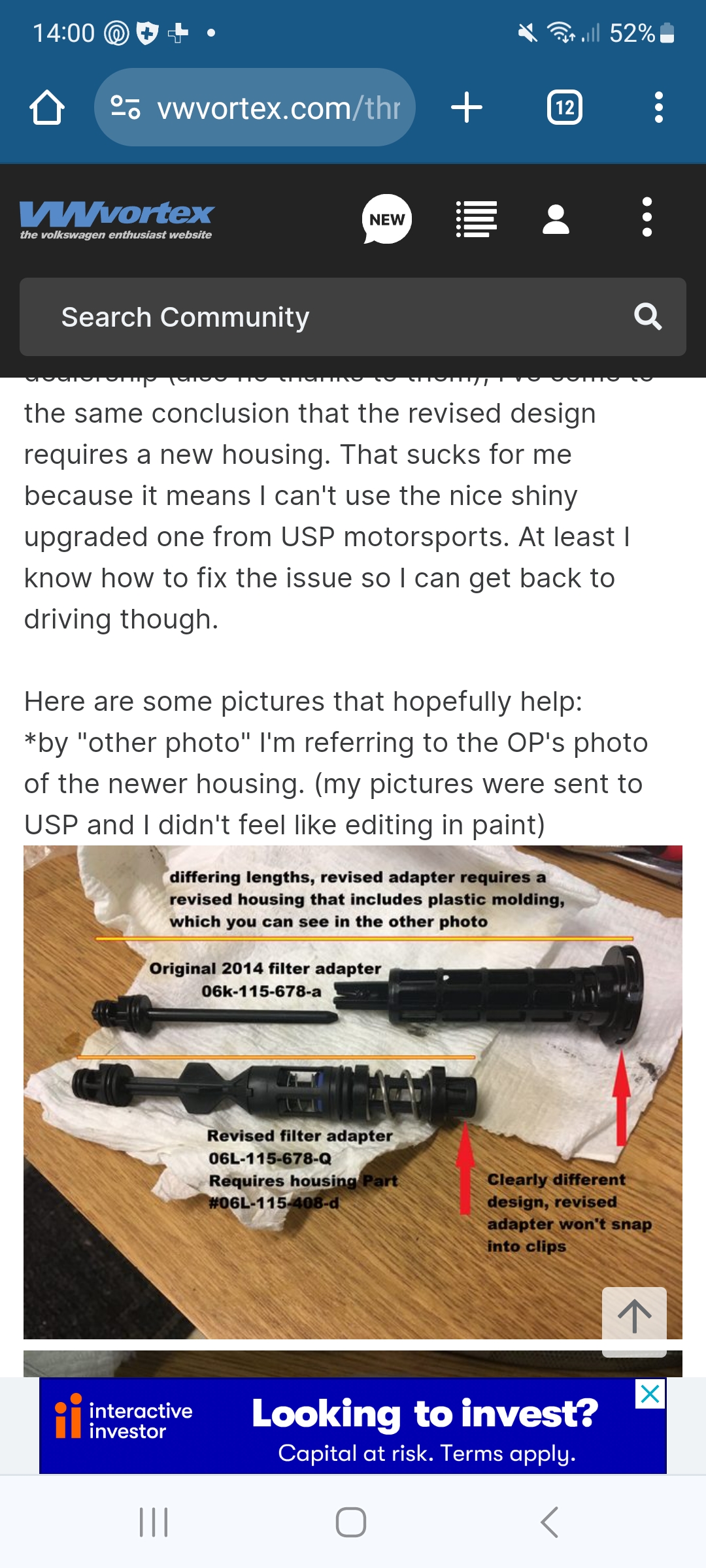

There was an older version with just a stick and O rings.
But importantly both versions require an accompanying plastic filter screw on cover. Not interchangeable.
But if it were not sealing at all you would probably have oil pressure light on all time. But if an o ring is just partially damaged? Worth a check. Also make sure it is correct length to and seems to fit in place by testing without screwing on cover.
See photos in this thread of different version..
https://www.vwvortex.com/threads/oil-pressure-light-after-switching-to-revised-oil-filter-housing-adapter.9253937/
I have that newer one for sure, where would the O ring be? I replaced the one around the housing.

There are two at the bottom. Non spring end. Edit. It also needs to fit so that as the filter housing is screwed in it gets compressed and seals the two orings in the drain hole bottom of the oil filter bracket beneath the oil filter!!!

Having done more oil changes on my VAG TDi's than I have had hot dinners I am very familiar with the stick and O rings but to my shame I had not appreciated its function as an anti-drain valve until now.
I gave up replacing the O rings some while back settling for a visual inspection due to the frequency of oil changes, now I know whats at stake I will be looking very carefully.
I dont think mine has the spring, you can feel when tightening and loosening when the O rings are forced into the bore, I think there is at least 10mm of engagement, a spring loaded one seems like a backwards step but perhaps there were other issues perhaps with the O rings becoming displaced, thats another reason I started leaving the old ones in place if they were undamaged, some of the new ones even on VAG filters from TPS were very resistant to enter the bore and required too much tightening torque, I was concerned they might get damaged or displaced.
Why are there two of different diameters, - belt and braces?
I don't know why there are two orings and therefore 2x bore diameter at bottom. As you say, I guess double seal!!!
I suspect the valves main function is to bypass the oil filter if it is clogged and has a neat secondary fuction of retaining the oil in the inverted filter and allowing it to drain down as the filter is being removed.
On my next oil change I am going to unscrew the housing until I feel the O rings release then go for a cup of coffee, hopefully then for the first time in 3 decades the old filter will not drop oil everywhere.
I think I will owe a debt of gratitude to TheClient!
Editted, later spring loaded shaft is almost certainly for clogged filter by pass, I can't see how the solid one can acheive that unless there is an internal spring, as they are interchangeable (with new plastic housing) then there cannot be a seperate one built in to the earlier oil pumps.
Edited by J.R.
Right, I don't recall there being any.
I'm going to double check properly once I have it back
Ha. Yes. The spring must be a bypass. But my car just came with the stick originally which can't do such a thing for sure as you say at original as supplied mfr.
Edit. In the new version part there's 2 different springs as well!!! A lot of complication for what was a simple stick and oring drain plug!!
I "upgraded" to the new part just because I read in several threads that it was improved, but there was never explanation of how, why!!
