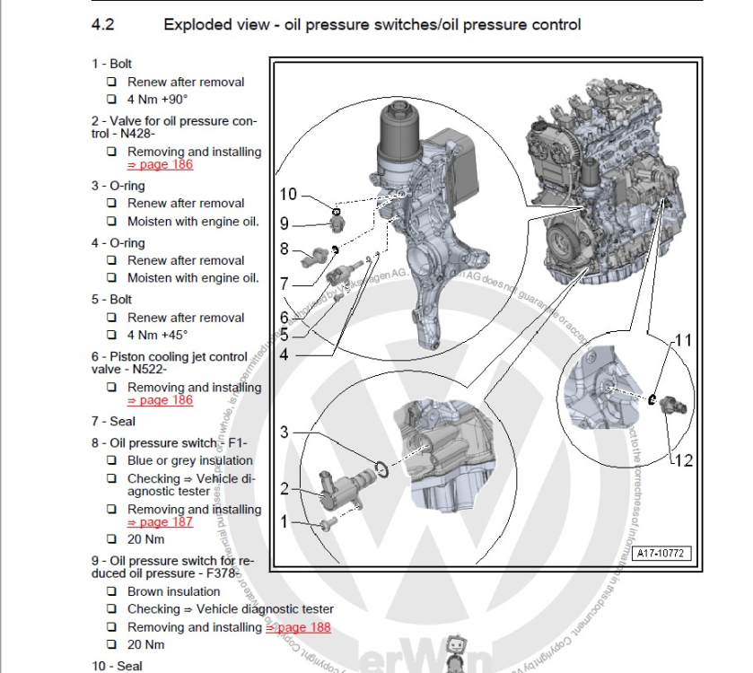

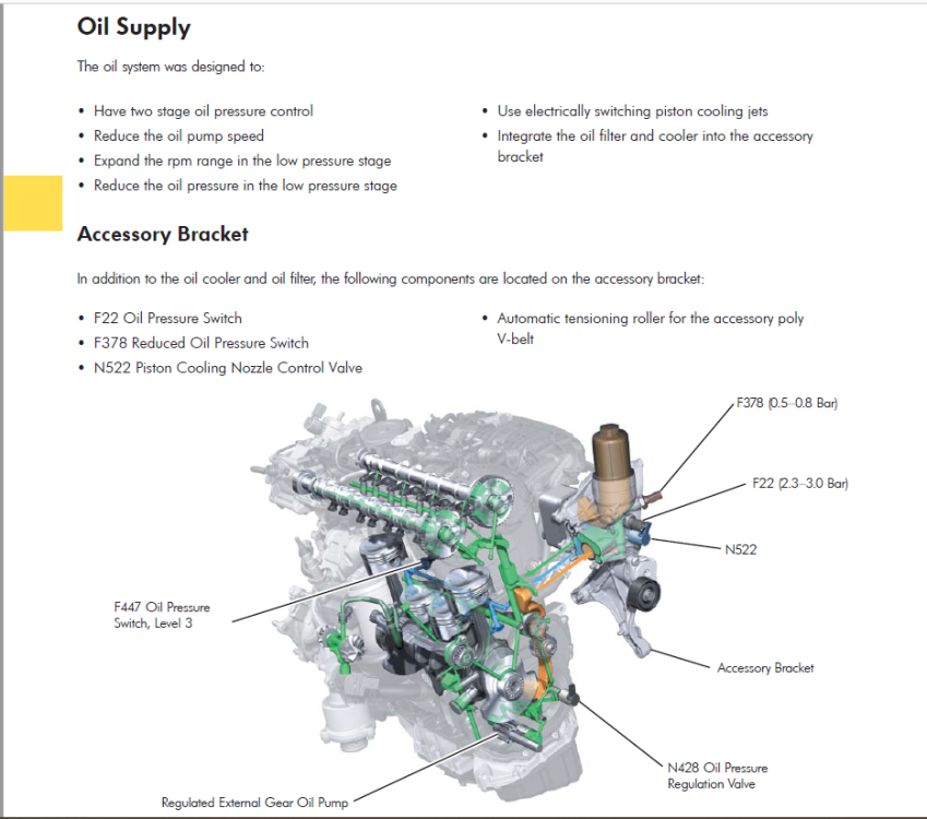

Looking at the self study vw guide, which is quite informative, although may not be 100% accurate on every engine derivative, it indicates what it calls a Level 3 oil pressure switch around the back of the engine, near the timing cover and exhaust cam (uk) driver side. It will be hard to see if it is there, because of the Turbo and the need to look up and over the back of engine...
See below self study posting.  What the guide also caveats with is,  not all gen 3 ea888 derivatives have the piston cooling jet control system and this extra oil pressure sensor is there to monitor the functionality of that system activation. I.e. confirm piston cooling jets are getting oil at appropriate pressure when called for.  I can say the golf r that i have does have the piston cooling jet system. As for Octavia vRS I would assume it does so, as mk7 golf GTIs have it but I can not guarantee it.  Looking at parts listing for the Oct vRS for the N522 would confirm it.
What is also a little strange is, in the Golf mk7 R workshop manual it seems to indicate the position of the L3 oil pressure switch is actually besides the waterpump on front of crank case.  This clearly contradicts this self study location. I will post the workshop manual excerpt separately so you see what i mean.
Item 12 in this workshop manual diagram. Completely different location!!

My concern is that description is very specific, and is the exact description used in the workshop manual for the lower oil pressure sensor on the oil filter bracket in both the self study guide and workshop manual.
I.e. The brown unit. See above diagrams for F378.
The two units are used due to the two stage oil pump pressure.
