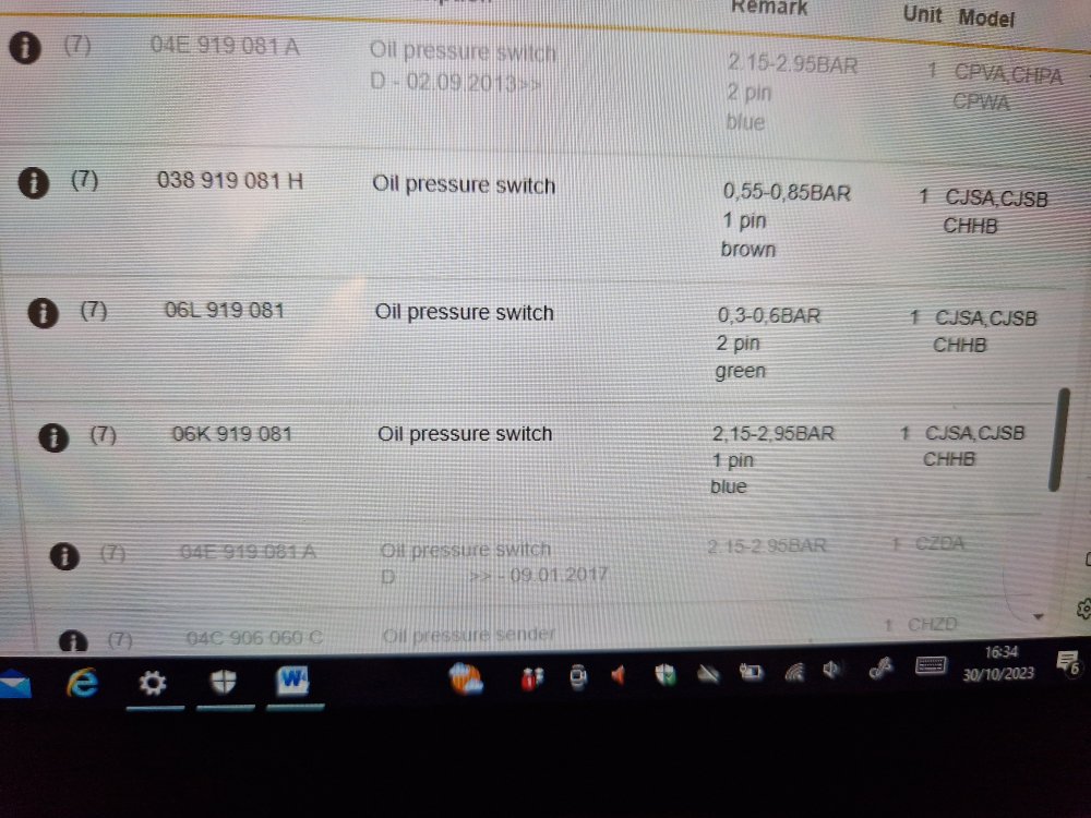

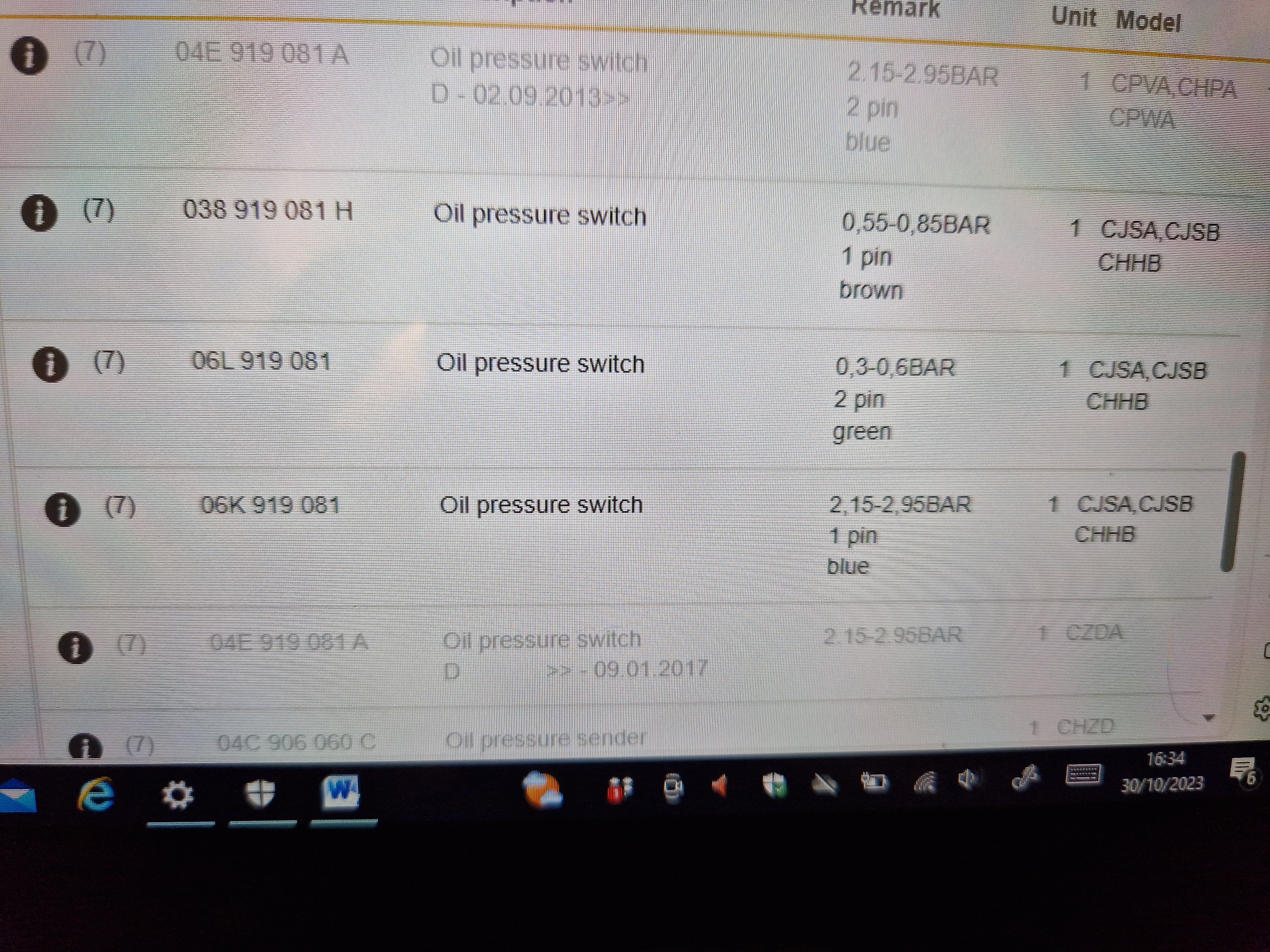

The ones that aren't greyed out should be on your engine. 038919081H seems like the correct brown one. £15.33 inc VAT at dealer. I guess the green one is the one that's physically located away from brown and blue.
  • Sponsor
Just noticed that the green one is listed as 2-pin, that's unusual. Does it fit into plastic?
Those codes for green/blue are the correct ones installed, the brown is not.
It shares the same part number - but not the same bar range.
Will have to order and try that.
Thank you
Yeah IIRC it was 2 pin, and it did fit.

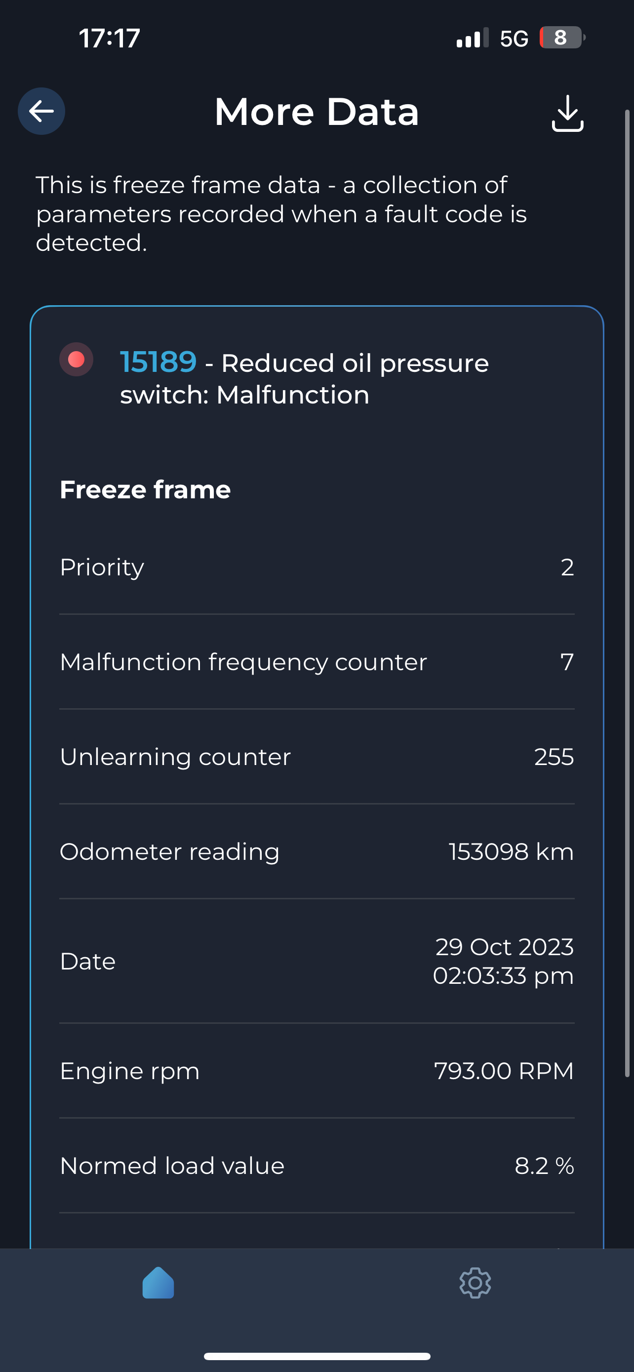

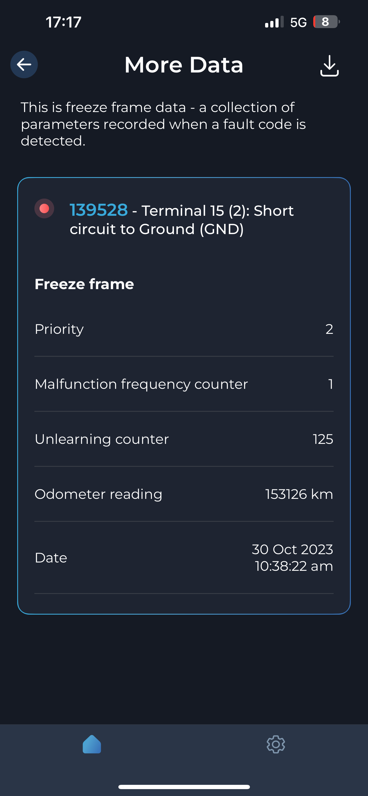

1 hour ago, TheClient said:
Yes. I'd try a genuine one if - when you remove the connector and cycle the ignition and the ecu reports reduced oil pressure sensor - open circuit fault!
Have just done this, see attached.
After looking at the code, every post says a sensor fixed the issue for them.
Edited by vRSRutty
Not really what I expected. Presumably the oil pressure switch malfunction is from before and you didn't clear? Before trying car with connector  disconnected? 29.10-  2.03pm date stamp.
The other error, I think is an ecu relay or starter fault. Is that time date stamp correct? 10.38am this morning? Maybe that is a red herring.
You could retry by clearing codes. Turning off ignition. Disconnecting brown sender plug. Turning on ignition  and if nothing still shows start engine. Keep hands amd connector away from ancillary belt and pulleys. Re run scan..

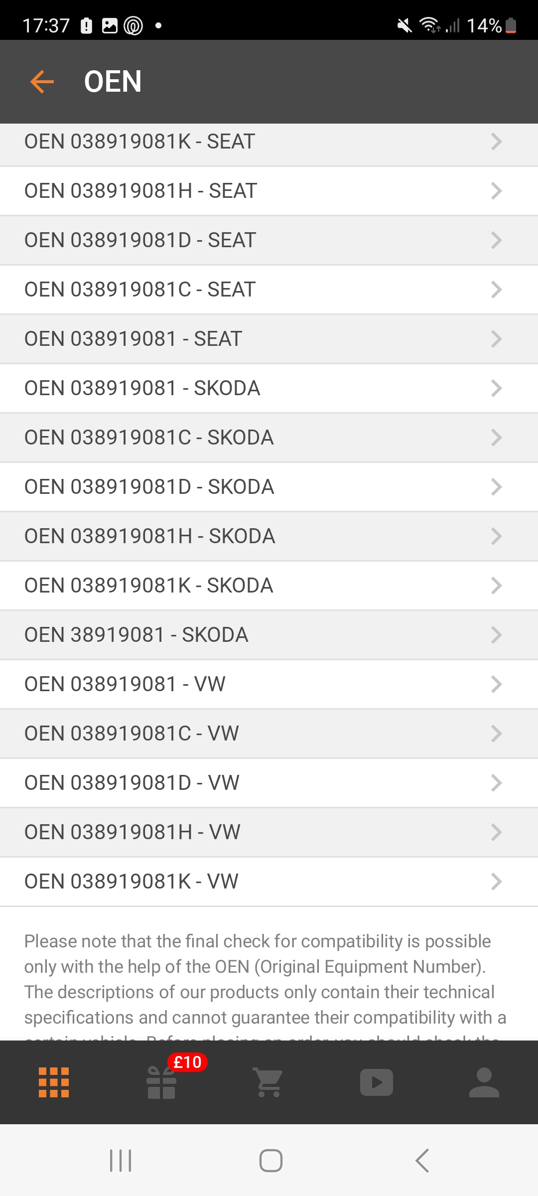

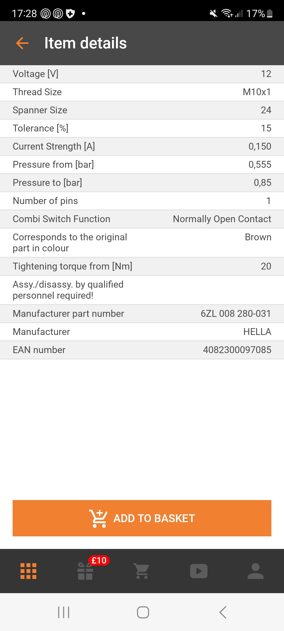

Or...  just get on with trying a new replacement. Genuine would be good but the hella aftermarket seems to match.
The hella after market lists 0.55 - 0.85 bar as well. Part no is one of many cross referenced. If you can't get to a dealer for vw or skoda part. .

That time correlates with when the Oil Light came on yesterday afternoon while
I was driving.
And yes I've never seen that before but I did change some settings within Carista so I presume it's to do with that.
Actually thinking now, it could be my auto start-stop, I've turned it off via Carista.
Have tried clearing codes, short to ground disappeared but the exact same sensor one came back once the engine was running.
Oh, ok. Even with oil pressure switch connector off? Same code still produced - no change? Makes me suspect wiring but you’ve come this far you may as well try a replacement brown oil pressure switch!!
