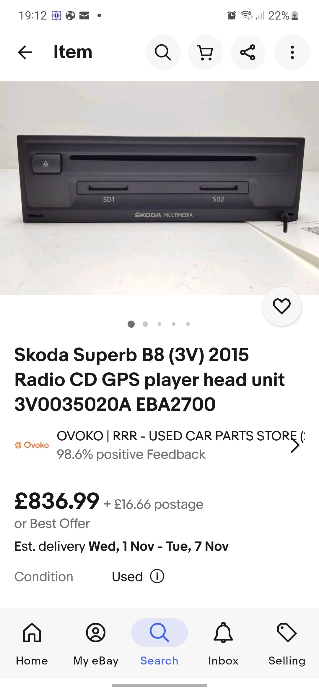

How do I find out which of these units were in my 2016 MK3 Octavia?

VIN?
These seem crazy prices for something that is second hand. The Columbus option was only £750 when I bought car in 2016
