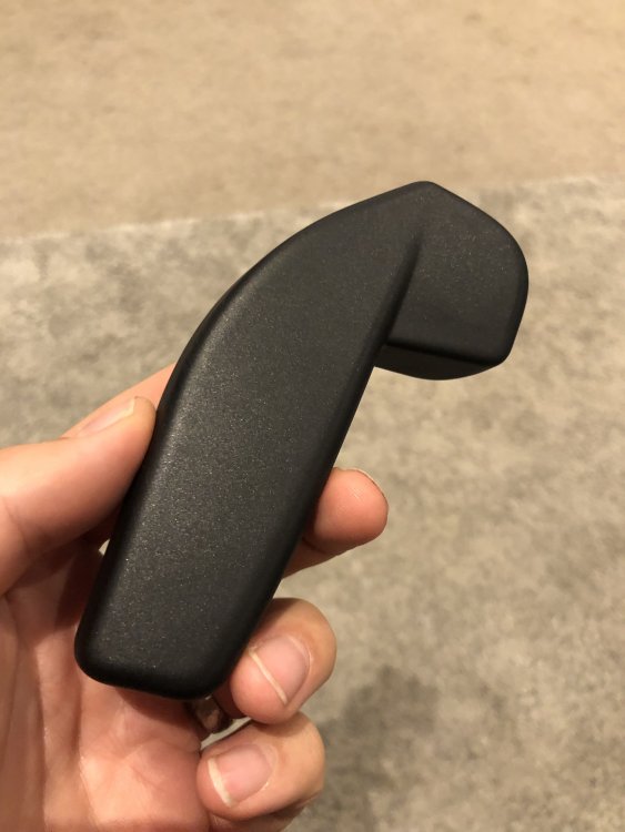

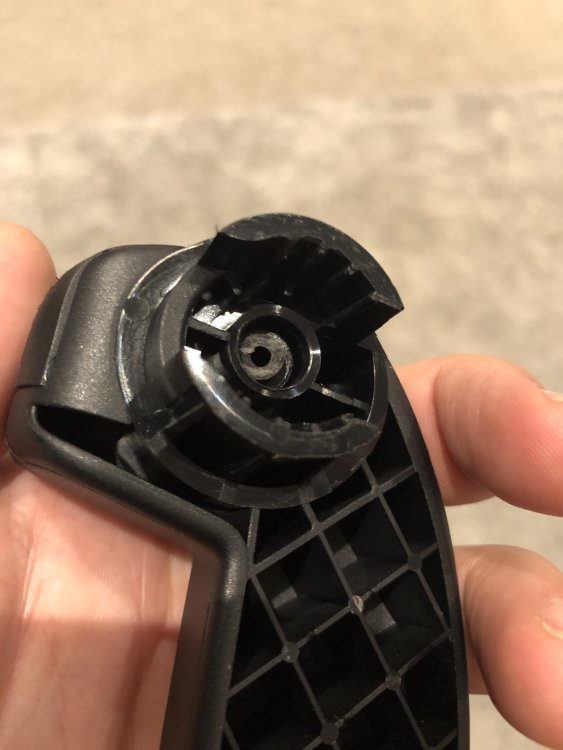

Mk3 bonnet release handle.
Other half just walked in and said, is this suppose to come off.
doh! It’s the bonnet release handle, looks like a bits broke off internally. Any idea on the part no for these, looks like I will need the handle and the mech.
Anyone ever replaced one?
Many thanks

Having now had a chance to check my son's car, I can confirm that the top of the plastic column on the backing mechanism had sheared off, so the sole replacement of the handle itself would never have cured the issue. In essence the new handle would have had nothing to grip onto. The 'E Clip' within the handle itself was also missing.
