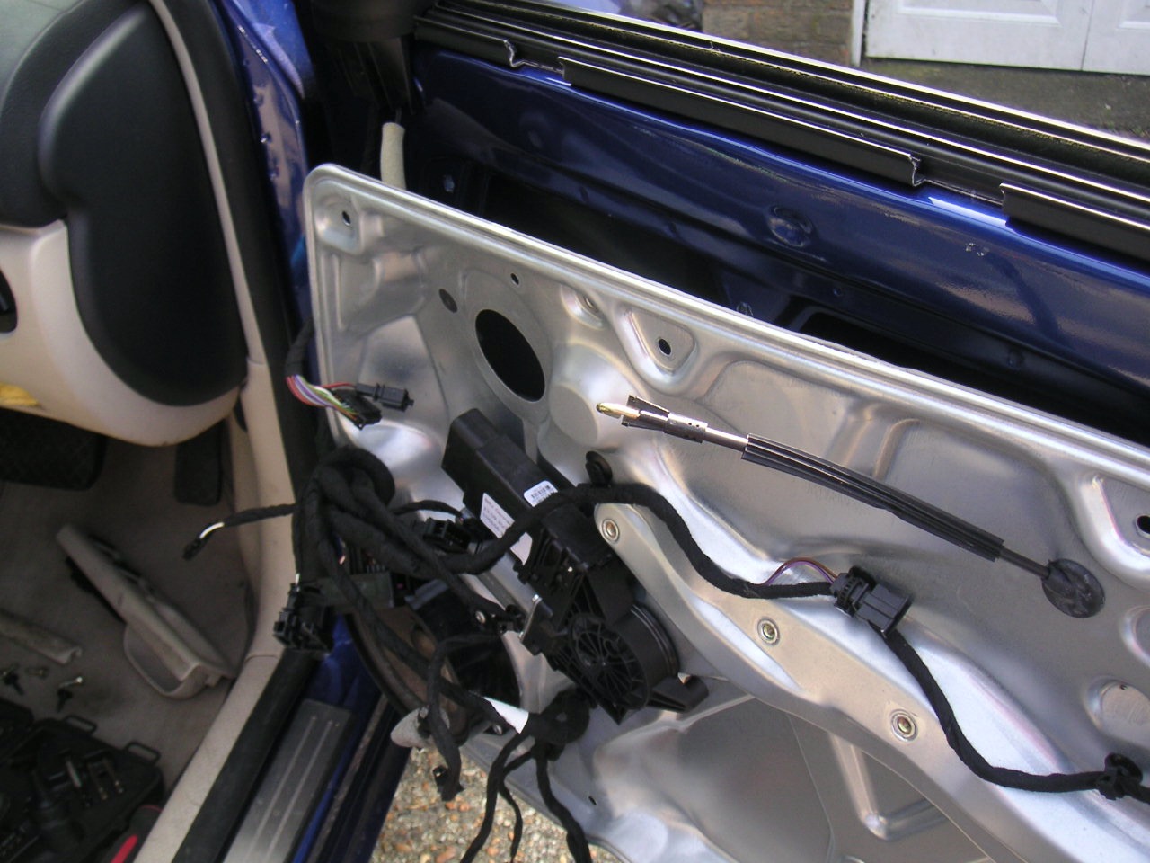

Just looking for photo's from when I had to replace my window regulator back in 2015, but not of them really help.  This is the nearest, showing the cable that hooks onto the handle:
My memory fails me, but I thought the handle separates from the door card quite easily.  Getting the door card itself off is very straightforward.
