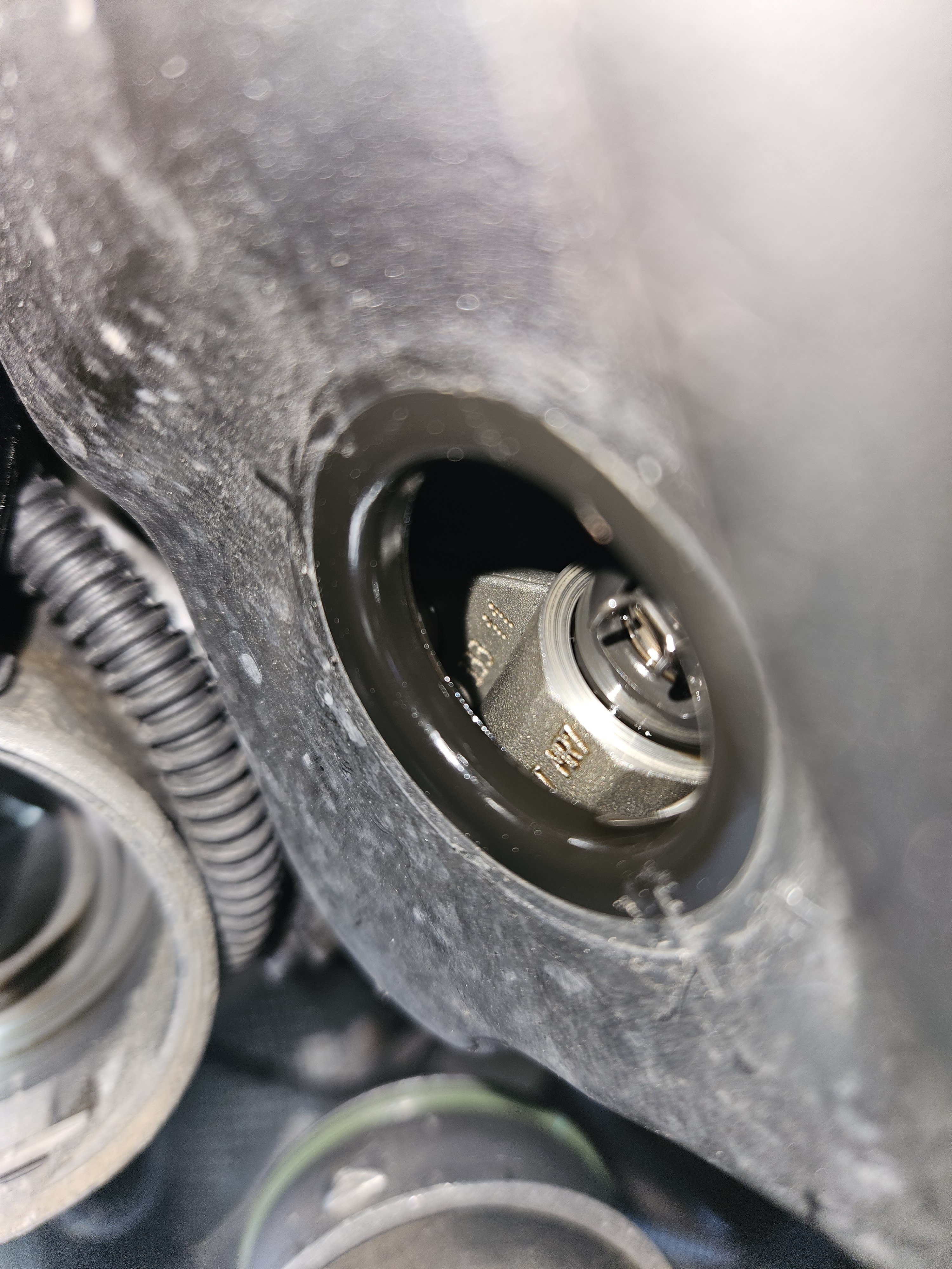

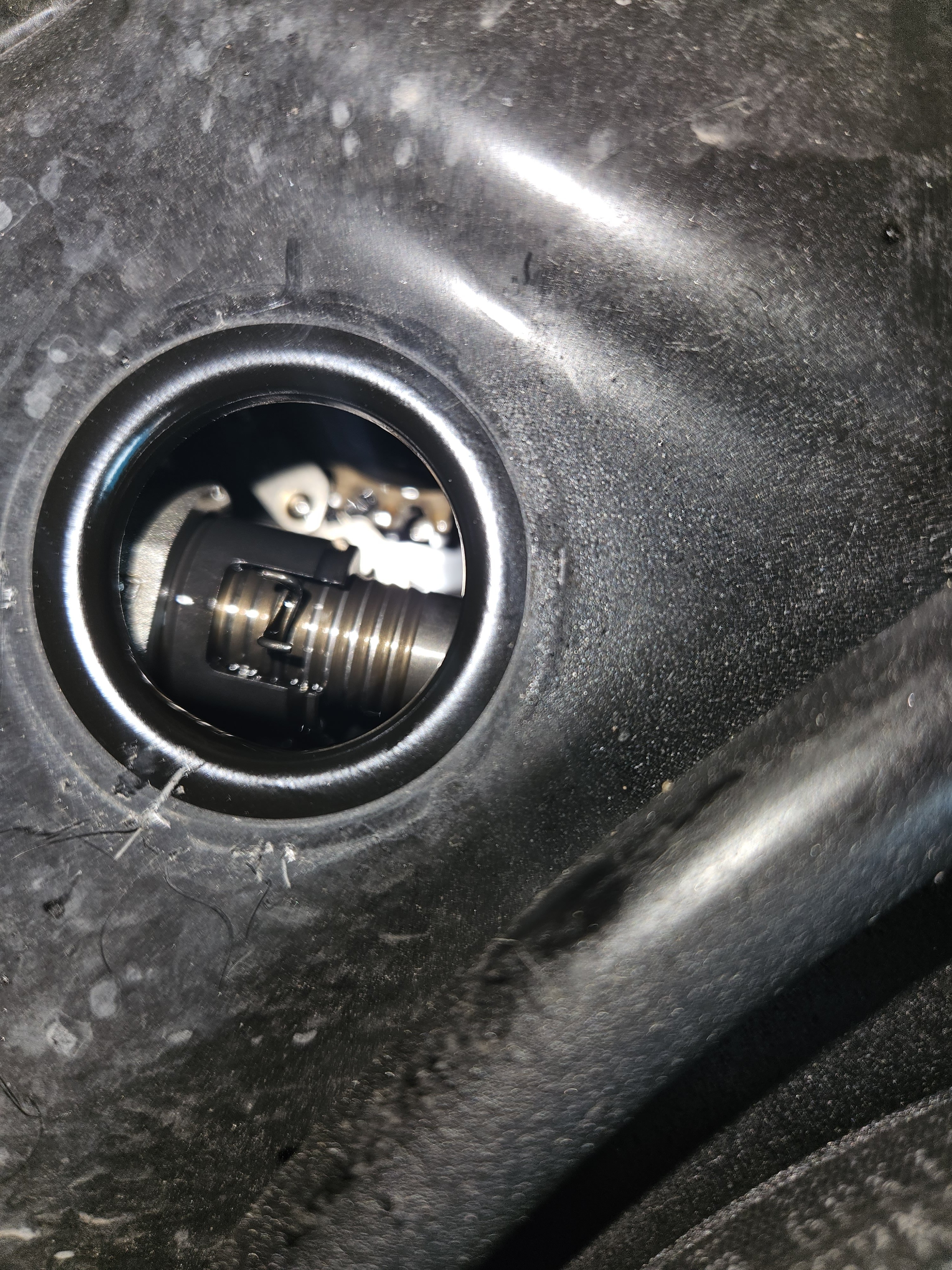

I bought it at 39k 2 years ago and cannot get hold of the previous ocd owner. One thing is for sure, this lining has been off before, its had a dremel on one of the T25's. Will post pics after.
Just a personal thing, i would be leaving well alone if the car runs well.  & if not ragging it like it is a sports car.
It's just an easy check for peace of mind, fed up with the 2.0 tsi CCZA scare mongering. I have a spare bung just in case it breaks.
Said tensioner.
The bung was fine to put back in.

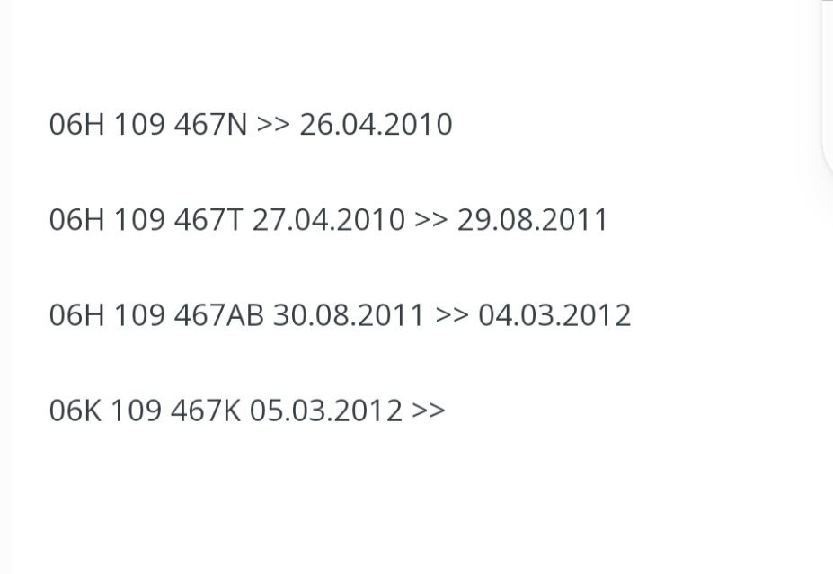

I can see and understand now why you wanted to know the engine build date, please ignore the above.
For the enlightenment of others what is the critical manufacturing date?
Hi J.R.
I don't know the exact, date I believe around March 2012 onwards for the latest revision according to my research online. But it varies of course.
