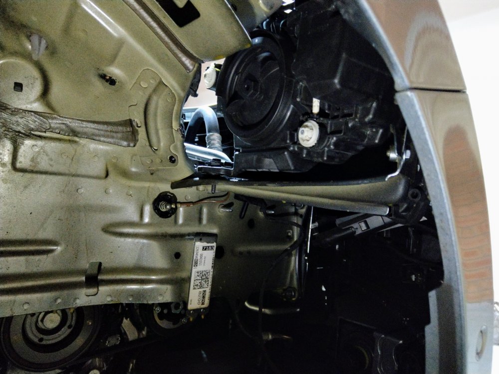

So it’s definitely a wheels off and arch liners out, to get to the headlights to change the bulbs? If so, I wonder if it’ll be possible to cut flaps - a la Audi - into the liners so their removal would not be required again?

Wheels off and arch liners out 100%, check the “what have you done to your superb today thread” I’ve updated recently with my fun at changing the bulbs.
Does your car have SLA headlights? If so it should be a breeze with anti clockwise release, clockwise lock. If not be prepared for hell…
@numskull - if u can fabricate a flap opening in ur wheel arch liner - that would b ideal long term.
here is wat they look like when removed.
this is the view behind the headlight, with the wheel arch liner removed.

what a nightmare to replace these bulbs...took me 3 hours .The metal clips that secures the bulb are insanely stupid.
