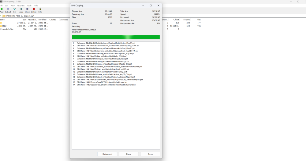

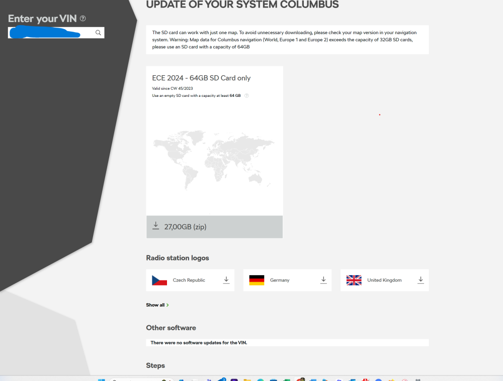

I've downloaded the latest map updates for my Kodiaq never had a problem in 6 years updating.
When I unzip it I get 17 errors . Is this OK ?
Used 2 different unzip program both the same and down 3 new downl;oads of the unzipped files
polite suggestions please

Skoda knows they messed it up. They removed the Vin to map file lookup to revert back to the June release. If you use the one published by MartiniB to the Skoda servers you get the corrupted one at the minute.
Mib2 highs on the import run an SLA1 signature encryption check so it will grind to a halt on the import if one character is wrong.... probably a lot more than one character out with their zipping error. The German Skoda board bless them don't understand this.... was reading their musing today to check whether it had been fixed yet.
The integrity of mib2 standard files isn't protected from being messed about with but mib2 high is by that signature you see on the bottom of the meta file. That bank of four lines on the txt file at the in each directory. That seals it from tampering.
Crafty way of protecting it but also protects the data from Skoda making a fool of themselves, not. Zip files themselves when unzipped if they complain means it's corrupted. The SLA1 signature is an over kill since the extraction if zipped does that. It's only sole purpose is to stop users hacking it the way they use it. If it was copied unzipped then the corruption check in transmission which it's claimed for would come in but it's use stops tinkering. To be fair it stops rubbish being loaded on to the system. So it does to that 😀. Bottom line, corrupted zip file you won't get the unit to touch it.

Same issue here.
Mostly it is .psf files that won't extract.
I think none of them had dates later than March 2023 so I was thinking maybe I could just stick with the files of the same name from the last release but it turns out that some of them have been modified since then. e.g. June release of Ukraine_Map3D_TIN.psf was dated 10-Sep-2022 and the new (corrupt) one is dated 03-Mar-2023.

As posted on the other thread I can confirm the two downloads are different. The Skoda one still has an issue from reports. They have managed to get the byte size identical but the contents are different when you run a check. That's not supposed to happen.
VW file is the way to go.
Yep still a problem downloaded the P350 again from Skoda portal. Seemed to unzip ahain without problems . But failed at 82% and reverted to P330.
Do I wait for Skoda to get it right? or try other VW or Audi  downloads.

Use the first link on MartiniBs page
This file:
https://vw-maps-cdn.lighthouselabs.eu/vw-maps/P350_N60S5MIBH3_EU.7z

FWIW I downloaded the VW lighthouse one above and compared the files to the Skoda update. Although there were some differences in times and dates of the files, when I did a binary compare they seemed identical except for 17 files that were missing from the Skoda download because they had not been successfully extracted from the archive.

Downloadable:    2023.11.13    17 broken files in archive
Downloadable:    2023.11.21     2(other) broken files in archive
Downloadable:    2023.11.30     fixed
