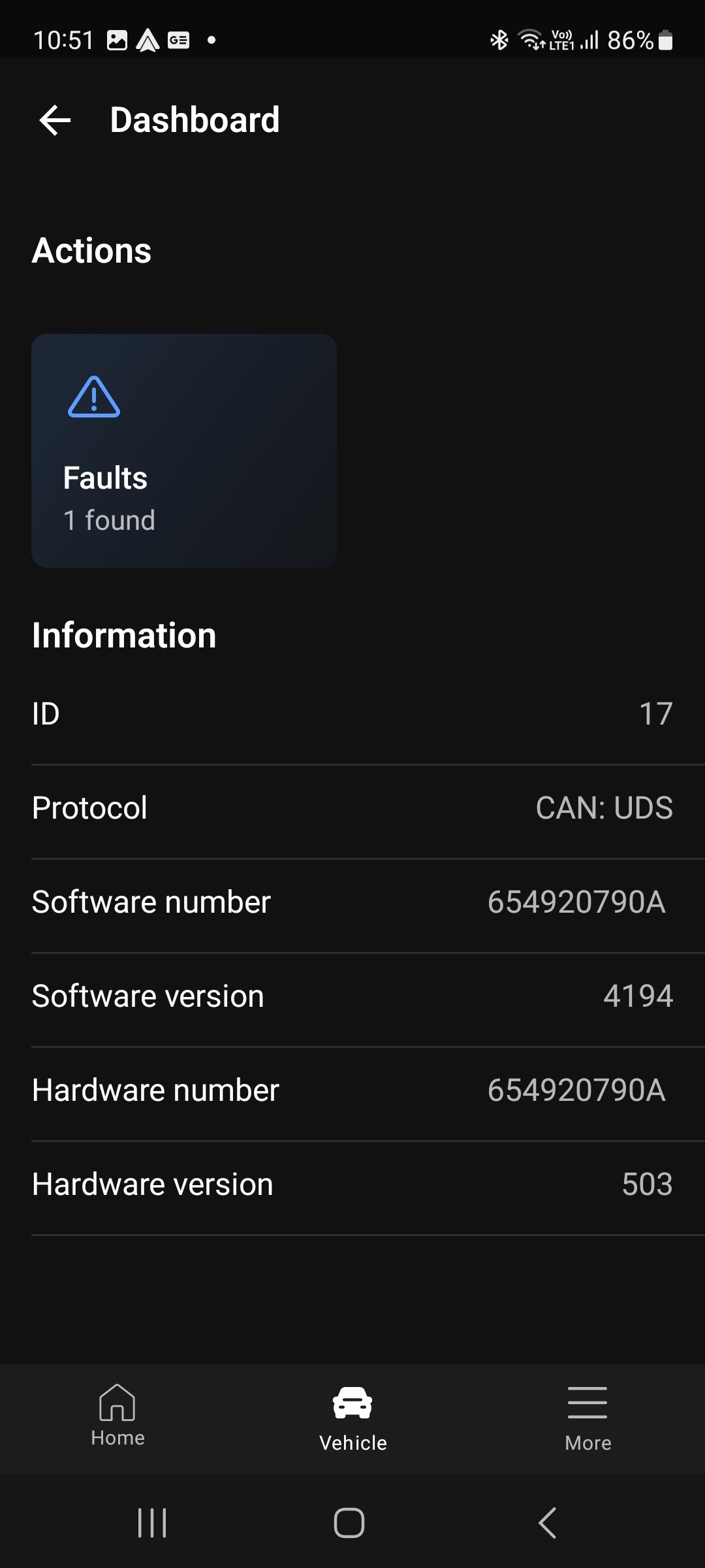

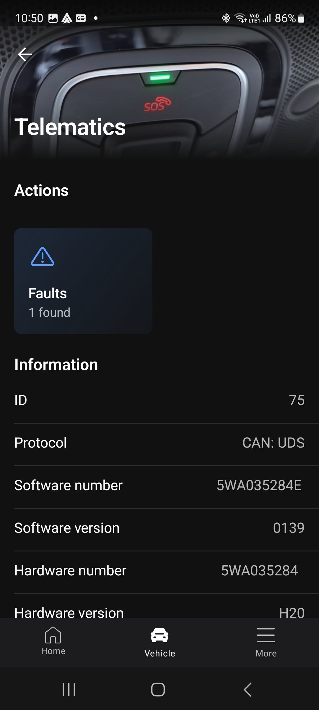

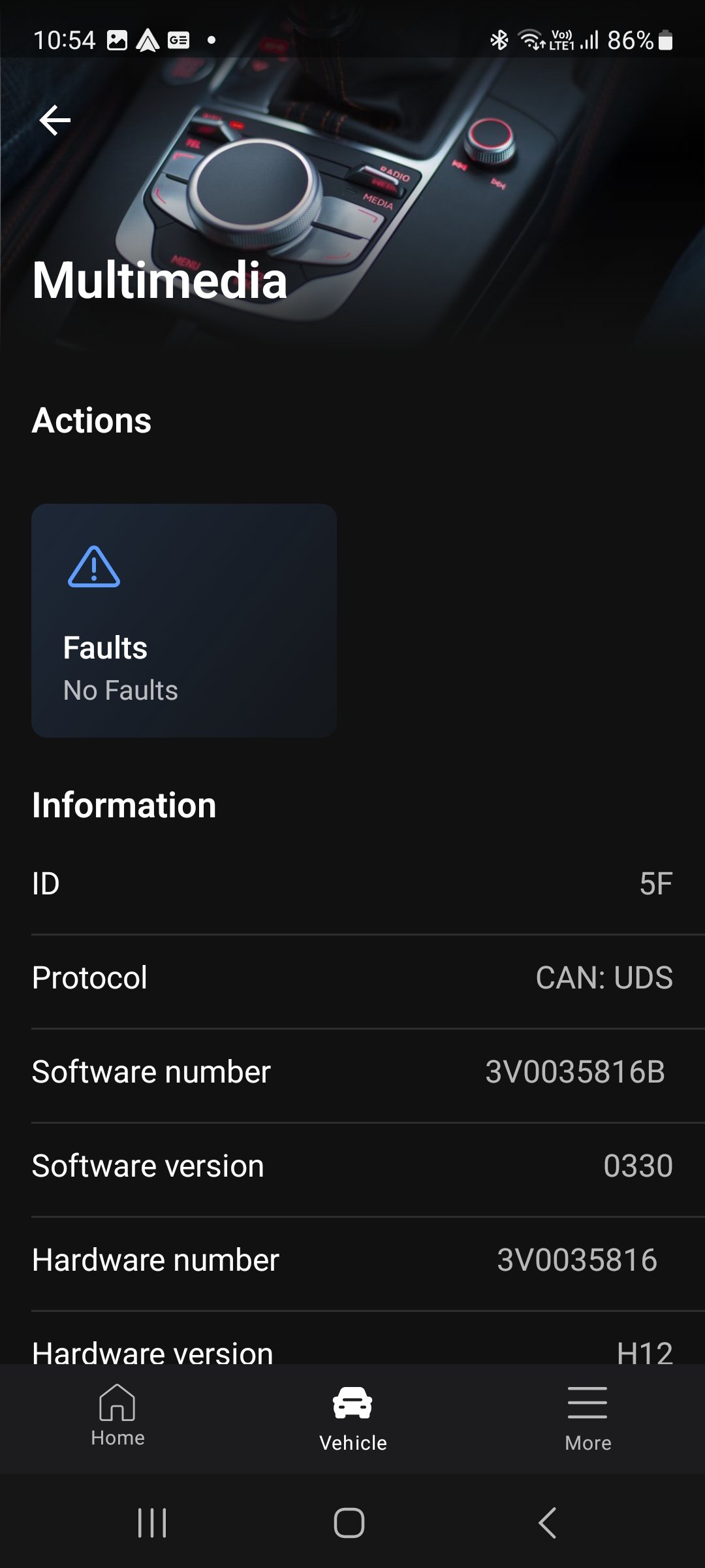

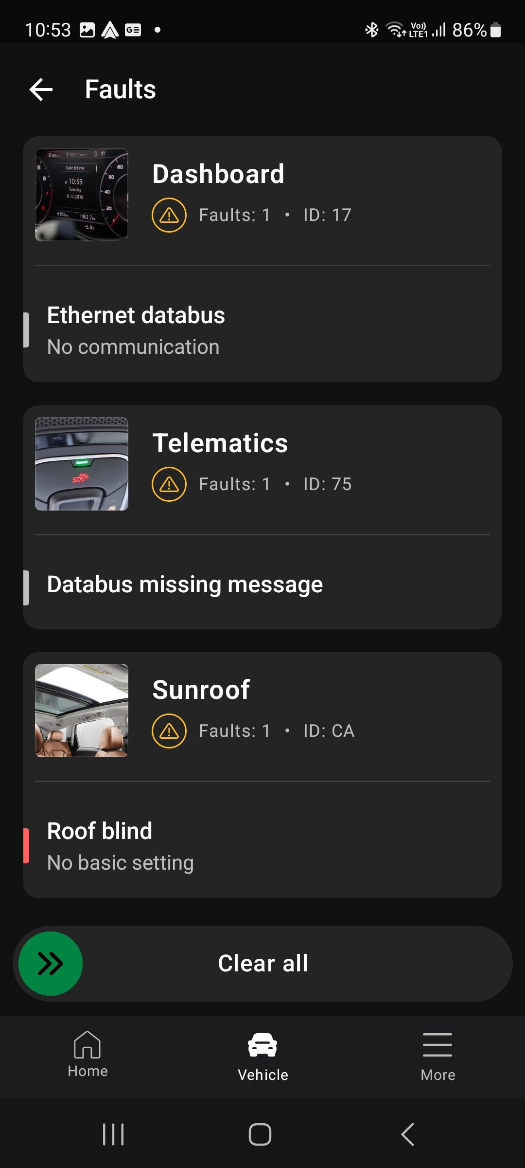

Hello,
I have a Scala Monte Carlo since february 2020.
Since MIB was updated by Skoda dealer, I have lost connectivity (infinite "Loading" message and Skoda shop apps have grey icons in menu). I tried a factory reset and then I managed to login with my Skoda Connect account but then unable to set account as main user because of infinite Loading message.
Skoda dealer has no solution to fix that except a full replacement of SOS system for a cost of about 1300€. So I would like to know if someone could have a way to fix software, connectivity worked fine until this update, including Skoda Connect app and traffic information in Skoda navigation map.
I have collected my actual configuration with OBD Eleven and attached captures to message.
Could someone please help to fix that ?

I have done update from Service menu with an USB key and it shows that update is OK. However I have checked with ODB Eleven and version is still 139 instead of 143 and I have a new 5F fault : Checking software version management
What could be the problem ? Did I take an incorrect update file ?

In my case Hardware number is 5WA035284 and software number is 5WA035284E. In which one should I refer ?
I used OCU3_5WA035284B__SWUP_package_3G0919360RJ.7z for Hardware number 5WA035284B.
Should be OCU3_5WA035284___SWUP_package_3G0919360RH.7z but perhaps it is better to check with Rainesh.
