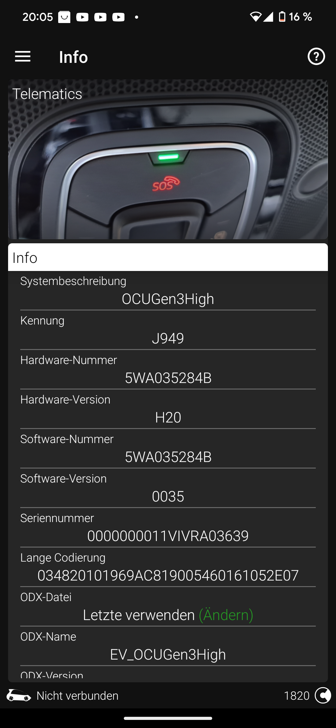

My OCU is a 5WA035284B and is on Version 0035, I guess that's my Problem.
I only found Versions for 5WA035284 without "B", can I use them anyways?
As I am using Version 0035 I need to update to 0088 first, and then to 0143 or 0146 - is there a possibility that maybe @Rainesh could provide me with the files?

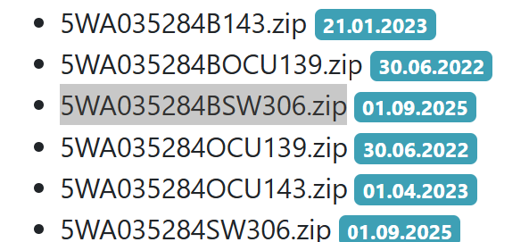

It wont let me update. It doesnt show proper in the photo but everything is grey and disabled. Any ideas?
You are trying to install the wrong update. You have index B and trying to install non-index firmware
Thanks again for the hint. That was my only guess about what could be wrong. I was not able to find the B version anywhere to download (not even drive2), so I thought it was wrapped around the non-indexed one. Do you know where I can find it?
I will sent you a message. I need your vin.
