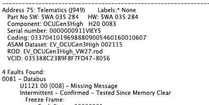

First log with VCDS original Rosstech 16 Febb 2020

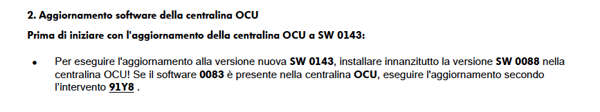

Hi, the TPI I think is 2072245-5.pdf in Italian I attach the part about OCU
2. OCU ECU software update
Before we start with the upgrade of the OCU ECU to SW 0143:
- To upgrade to the new version SW 0143, first install SW 0088 in the OCU controller! If software 0083 is present in the OCU ECU, perform the upgrade according to task 91Y8 .
Hi, you can use this TPI2060553 procedure to update at  088 version, then you can update simply mode to 143 as TPI 2072245
TPI-2060553-8.pdf

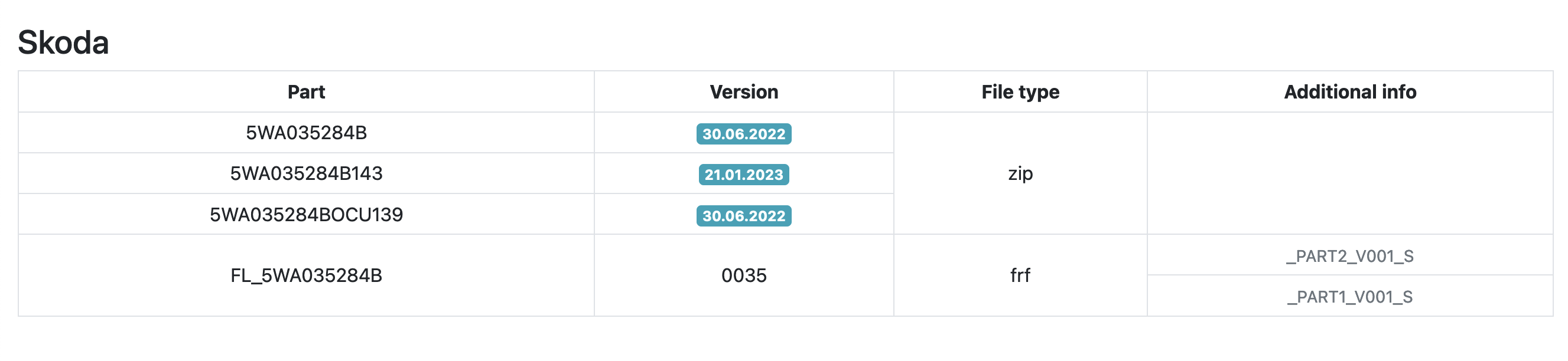

Additionally I only see version 139 and 143 on https://vag-flashinfo.de/:
And I also can't find these files, not even from Service42. Does someone know where to find them?
Thanks a lot
