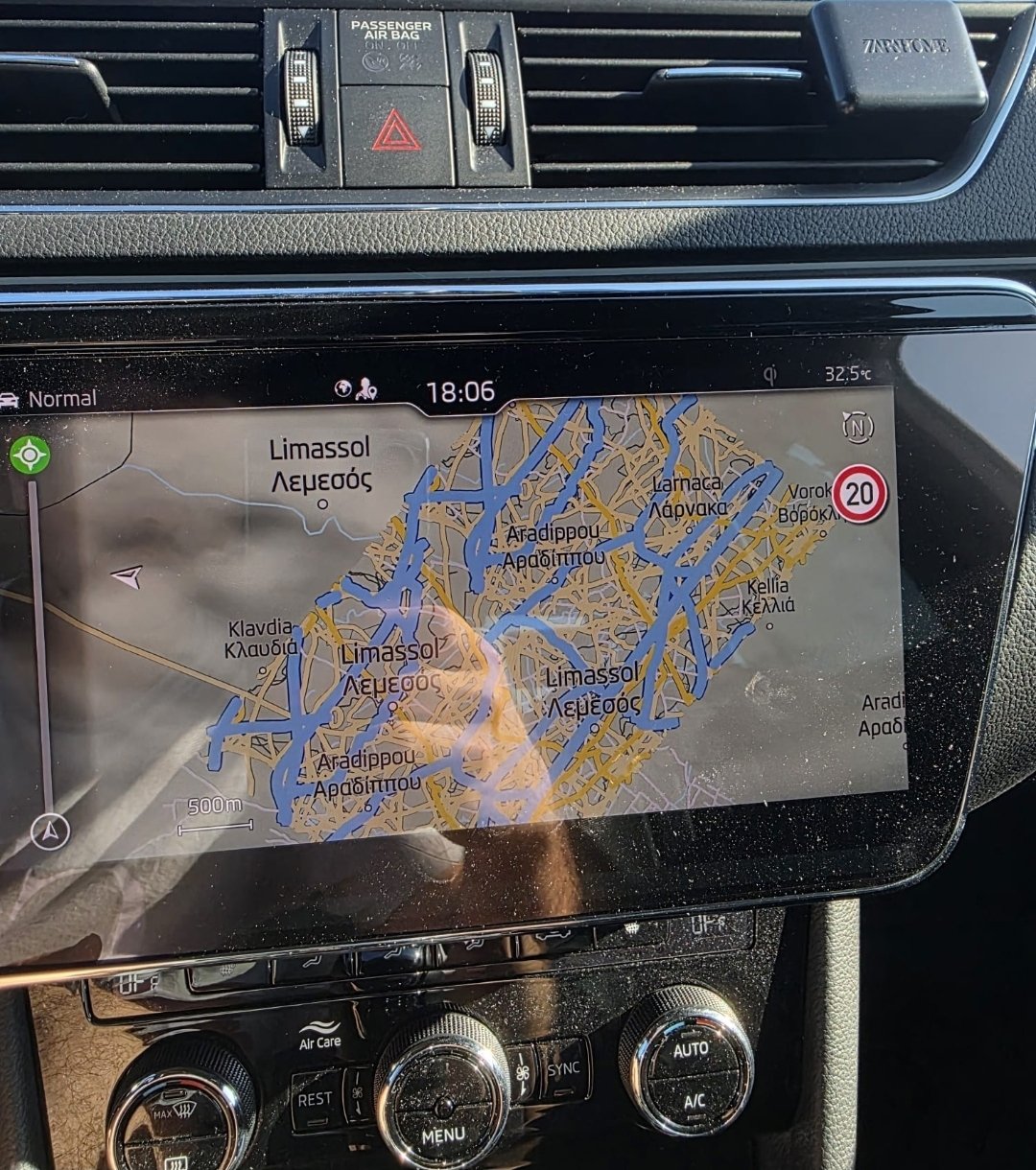

I will be pleased if you could help with a piece of advice about a problem that I have with my MIB3 unit from a Skoda Superb iV MY2020.
So, I'm seeing 2 cities from Cyprus (always same 2 cities) in random places everywhere on the maps, and they appear mostly when I zoom out.
Maps are stuck to 23.6. Tried with offline update via USB, also with Infotainment Online, no change, no new road appeared, nothing.
Swap codes are looking good, the 00071c00 appears to be installed and valid.
While navigating throughout other countries, maps are looking.. not great, not terrible, however, navigating through Cyprus is a total mess (please see the attached picture).
The unit was updated by dealer from 0156 -> 0278 -> 0308 -> 0330 by dealership. OCU also updated.
I managed to update to 0332 recently, update ended successfully and the emmc ended with status "New", however, nothing changed on the maps.
Connected with ODIS, tried to format the Navigation Data Bank, but every time I tried to start the operation, it would just return "Incorrect Results" as the outcome and won't do anything.
Do you guys think there is anything that could be done further at this point or the maps will be "bricked" forever on this unit?
Regards,
Alex

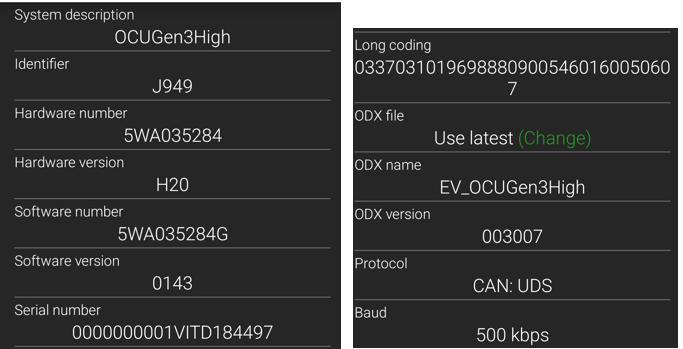

Can someone help me understand which OCU file I need please? I'm having the same 'primary user' problem as many others have had with my MY20 Karoq. I've updated the MIB3 system to 330 from 276 which has allowed me to get to the point where it asks me to unlock with both car keys, and it recognises the presses but then doesn't actually register as primary user (see screenshot below).
Here's the data on the OCU version:
Each time I've tried to update the OCU all the options are greyed out similar to this post. What am I doing wrong? I've tried 141 and 143 from the Mega link.
Thanks in advance!
