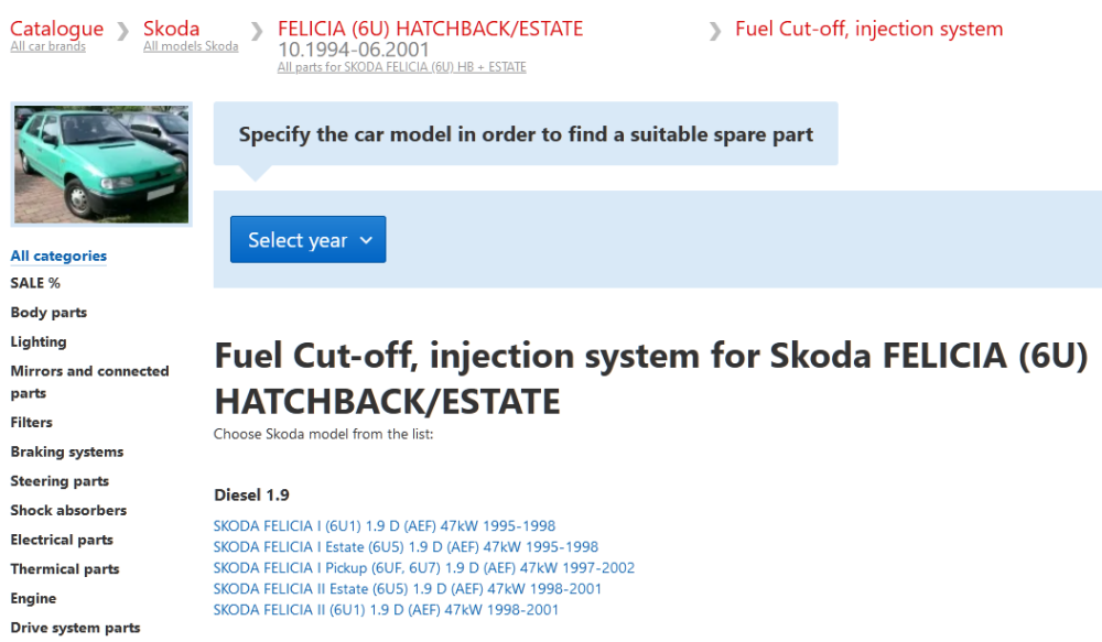

49 minutes ago, D.FYLAKTOS said:
As for the record: I have found this but it's only for 1.9 diesel
That's a valve to shut off the engine (as 1.9D has mechanical injection pump and no pump in the tank). Not an inertial switch.
Edited by Papez
That airbag sensor 1K0909606C in other stores has about 133 euro (without shipping) but in GR has 203 euro (new). :blink:
