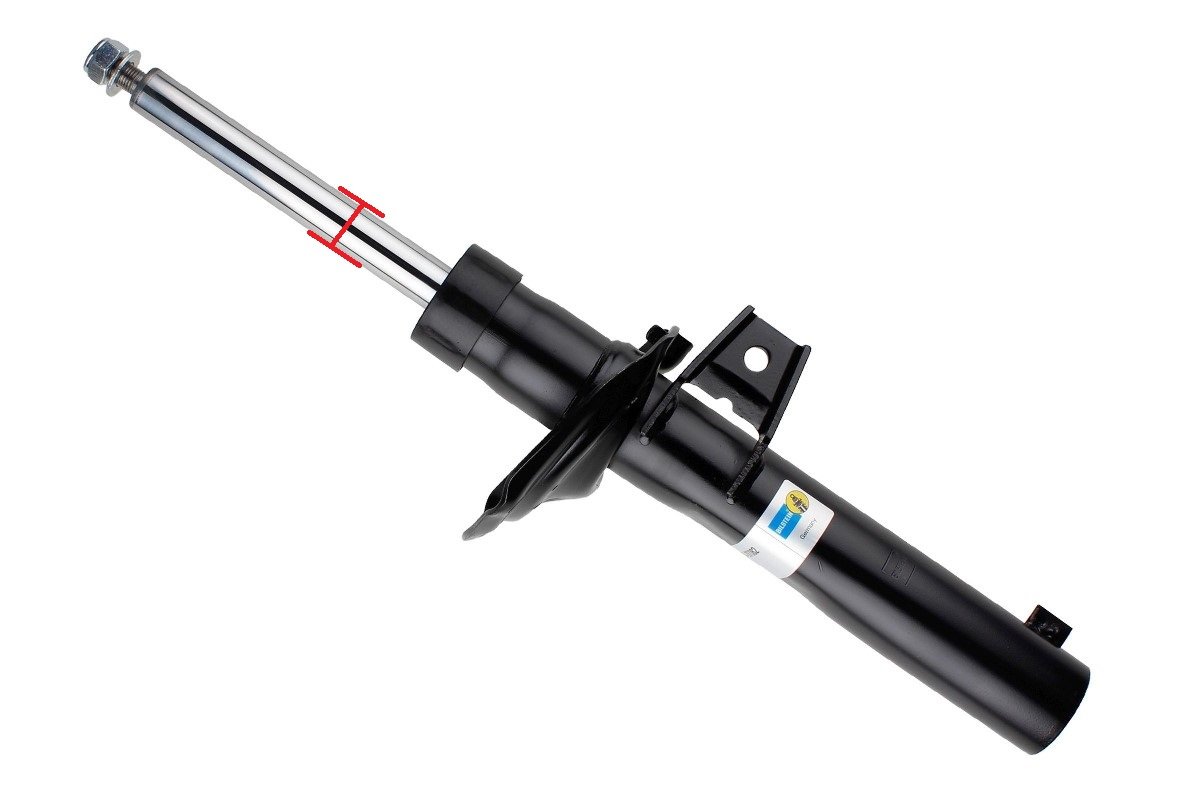

Bilstein B6 shock absorbers aren't a modification as far as car insurance is concerned. Someone previously contacted their insurance company to confirm this.
If they were, the insurance companies would have to decide which aftermarket replacement shock absorbers modified your car and which aftermarket shock absorbers didn't modify your car. This would be an impossible task for the insurance companies.
If the outside appearance of the aftermarket replacement shock absorbers looks similar to the original ones then they are not modifying the car.
Sometimes, Bilstein B6 absorbers are very similar internally to Bilstein B4 shock absorbers. If in doubt about this, then check the Bilstein B6 shock absorbers that Bilstein sells for Dacias. They just look like Bilstein B4 shock absorbers that have been painted yellow, and are sold at a low price. So Bilstein B6 doesn't always mean you are getting anything special.
Most aftermarket shock absorbers are not identical to what was fitted in the factory. The aftermarket shock absorber brands use a one size fits all approach because they sell one shock absorber to replace possibly dozens of factory fitted shock absorbers. So technically, nearly all aftermarket shock absorbers are different from standard but are not regarded as a modification.
Bilstein B4 front shock absorber (for the Karoq)

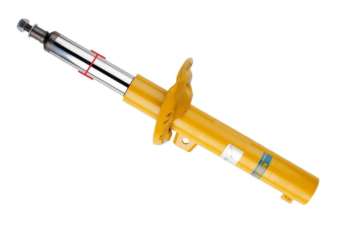

thumb?id=14433633&m=0&n=0&lng=en&rev=94077853
Bilstein B6 front shock absorber (for Karoq)
thumb?id=9612727&m=0&n=0&lng=en&rev=94077853
