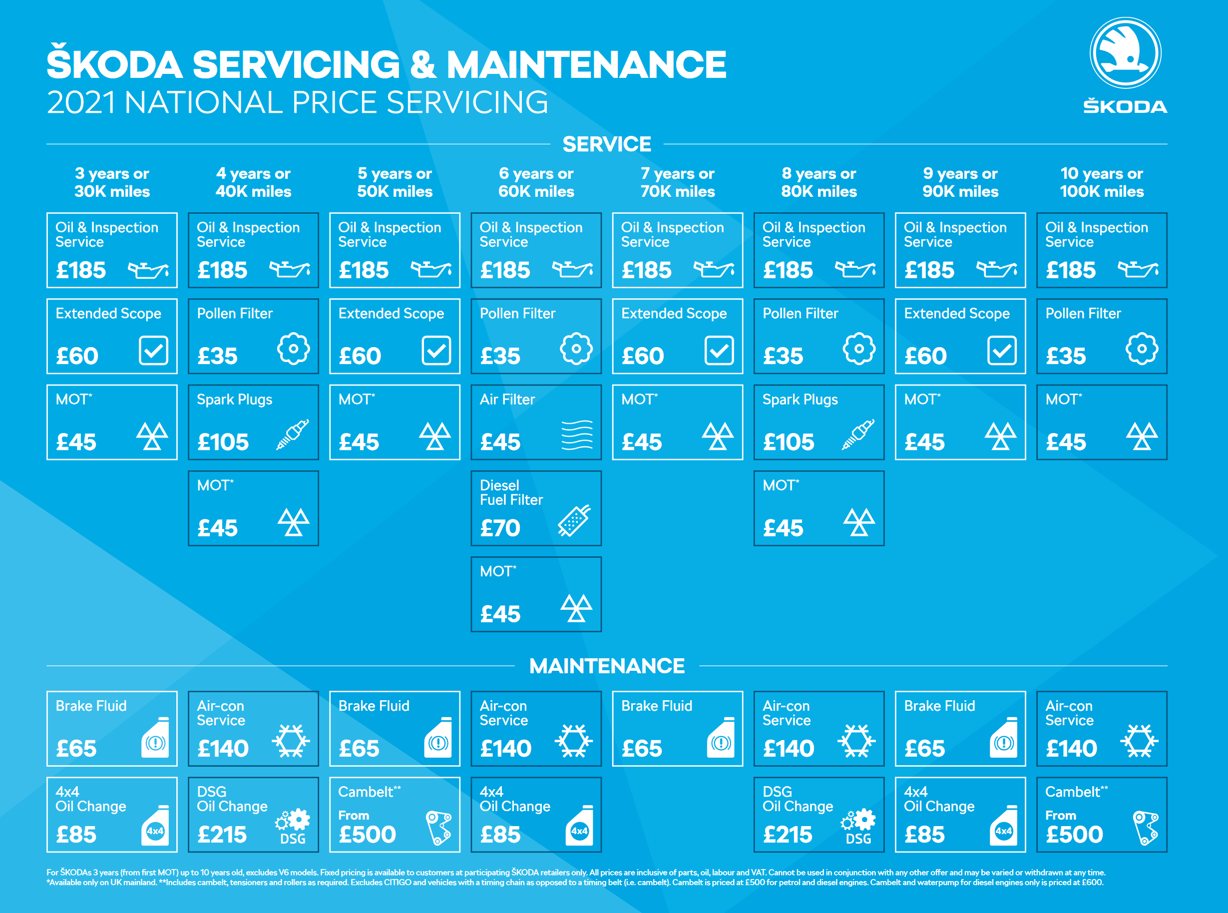

Skoda used to produce one and it was pretty handy. (Hat-tip to @Rooted who I think provided the copy shown here.)
I always thought the time based interval on the diff to be a bit questionable given the distance based interval on the DSGs.  With the table above readable at 40k on DSG could you also read it as 30K for haldex?

It is not 40,000 miles on all DSG,s since DQ200,s are no Schedule. DQ381 @ 80,000   or sooner obviously.
There is changes now, there was / is VAQ front diffs that were at 30,000 / 3 years, now at 20,000 / 2 year.
***Many never get told about the VAQ service, or told not necessary or can be done sometime.***
Same with Brake Fluid, was @ 30,000 / 3 years then each 2 years.  Now at 2 years and each 2 years.
Not seen Skoda and Haldex at 20,000 miles / 2 yeas, but Volvo had that.
Some need doing, use, location, blocked up and dirty even if never offroad, in a river, sea or mud.
It is pick a number any number as far as Guidelines, Recommendations, Advice or Schedules these days.     What a pity those in Skoda Dealerships seem to not know.

@Rooted clearly that table above is out of date as the cambelt info is off. No mention of VAQ either. Assuming it's similar to Haldex, are the intervals the same for both?
Oil and filter change due on VAQ, front diff, fwd cars.  Octavia MK4 now at 2 years 20,000 miles apparently.    There are threads on the ones leaking or wrecked through lack of servicing.    Links in the threads from me on service kits etc.
