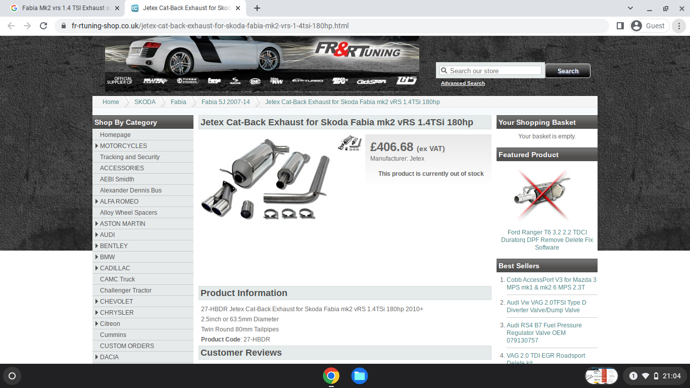

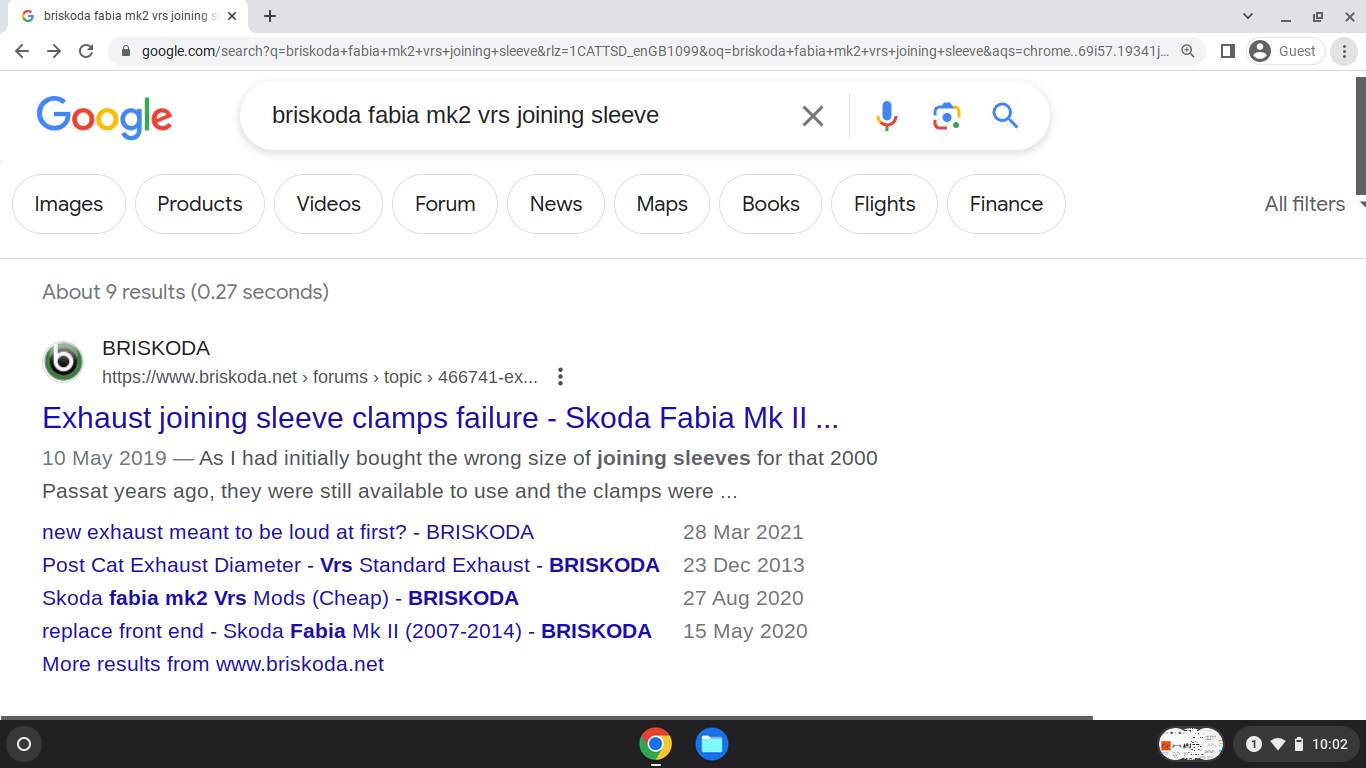

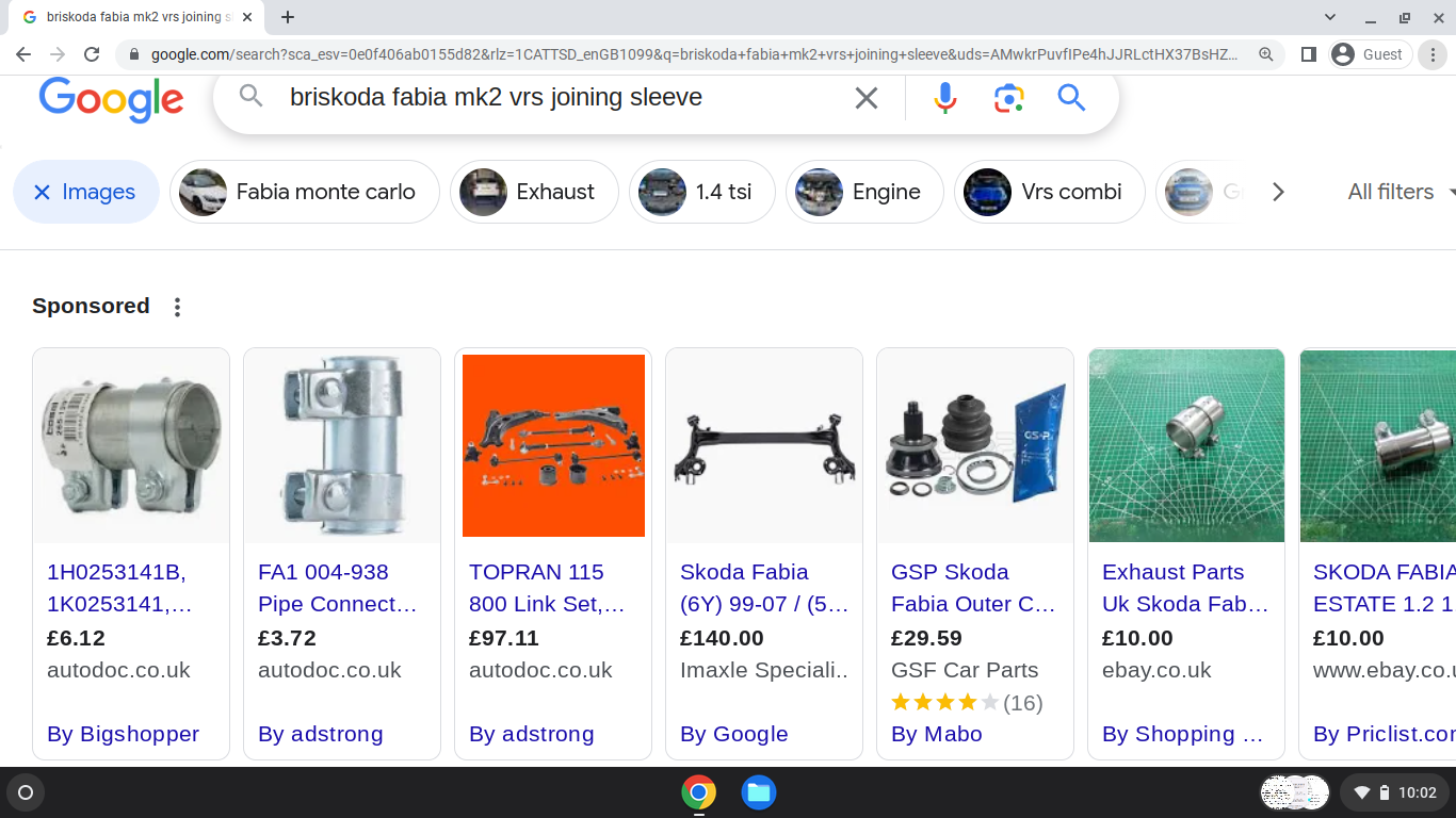

Is that a pretty standard sleeve?

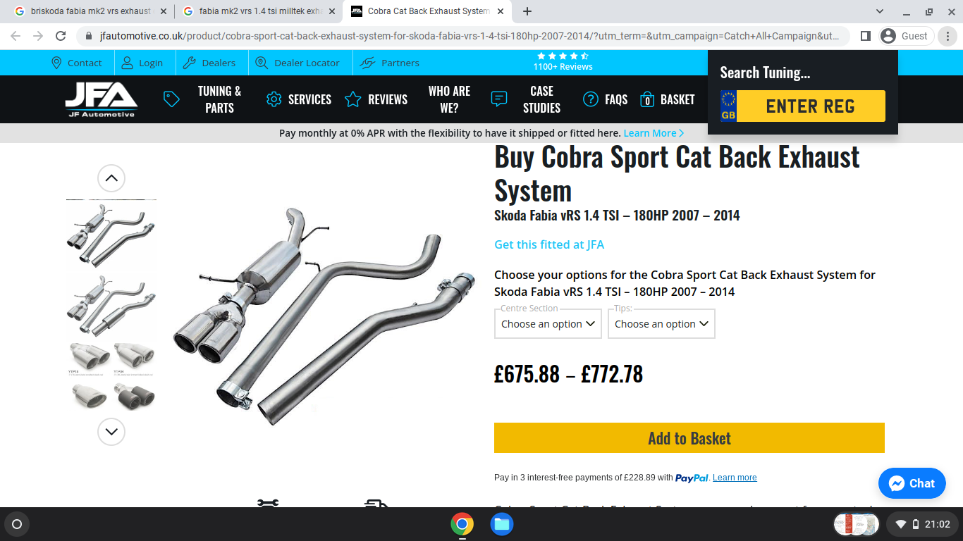

assuming the cobra system you posted above being a cat back would mate with the sleeve area you linked above? Do you think the cobra would come with a new sleeve?
sorry for all the questions.
I have seen a few people posting about the cobra system and it seems alright for the price, is there any benefit going resonated or non-resonated? I'm assuming for normal driving, resonated gives a more OEM exhaust note and feel
Just (2 weeks ago) had this done on my Fabia TSi. The trusted garage I use for MOT's charged me £28.14 + VAT for genuine sleeve and clamps and £10+VAT for labour. Felt ripped off at the time (having seen the sleeve online for £10) but I guess it's the price you pay for genuine parts. Probably would've got away with just fitting new clamps on reflection as the sleeve itself looked OK.
I used Jubilee clips as a temporary measure while I waited for a new sleeve and clamp assembly, I dont think you can buy the clamps alone and standard old school U bolt clamps would distort the sleeve.
My new one had decent clamps, well better than the decomposed old ones but the sleeve was not as robust as the original OE stainless one so I reused that with the new clamps.
That said I must have sourced some clamps because I have kept the new sleeve as a spare and it has clamps on it, another mystery from my memory loss.
The VAG part from TPS is very expensive but good quality, the clamps and bolts are now corrosion resistant.

Just an update on this. Got a cobra exhaust which replaced every part I had an issue with.
Got the resonated version and has a nice grumble to it but which being too "asbo"
