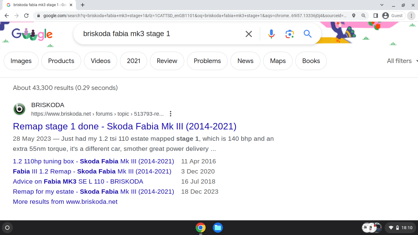

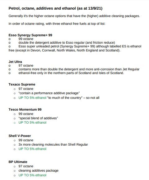

Just presuming that you are remapping to improve the performance by increasing the bhp / Nm there is little point running 95 ron Unleaded E10.
E5 in the UK is 97 or 99 ron minimum and it would be usual for the remap to be written to suit running Super Unleaded.
Sainsbury,s Super Unleaded is 97 ron minimum.

Here's the download of the petrel info Rooted put up. - petrol.pdf
