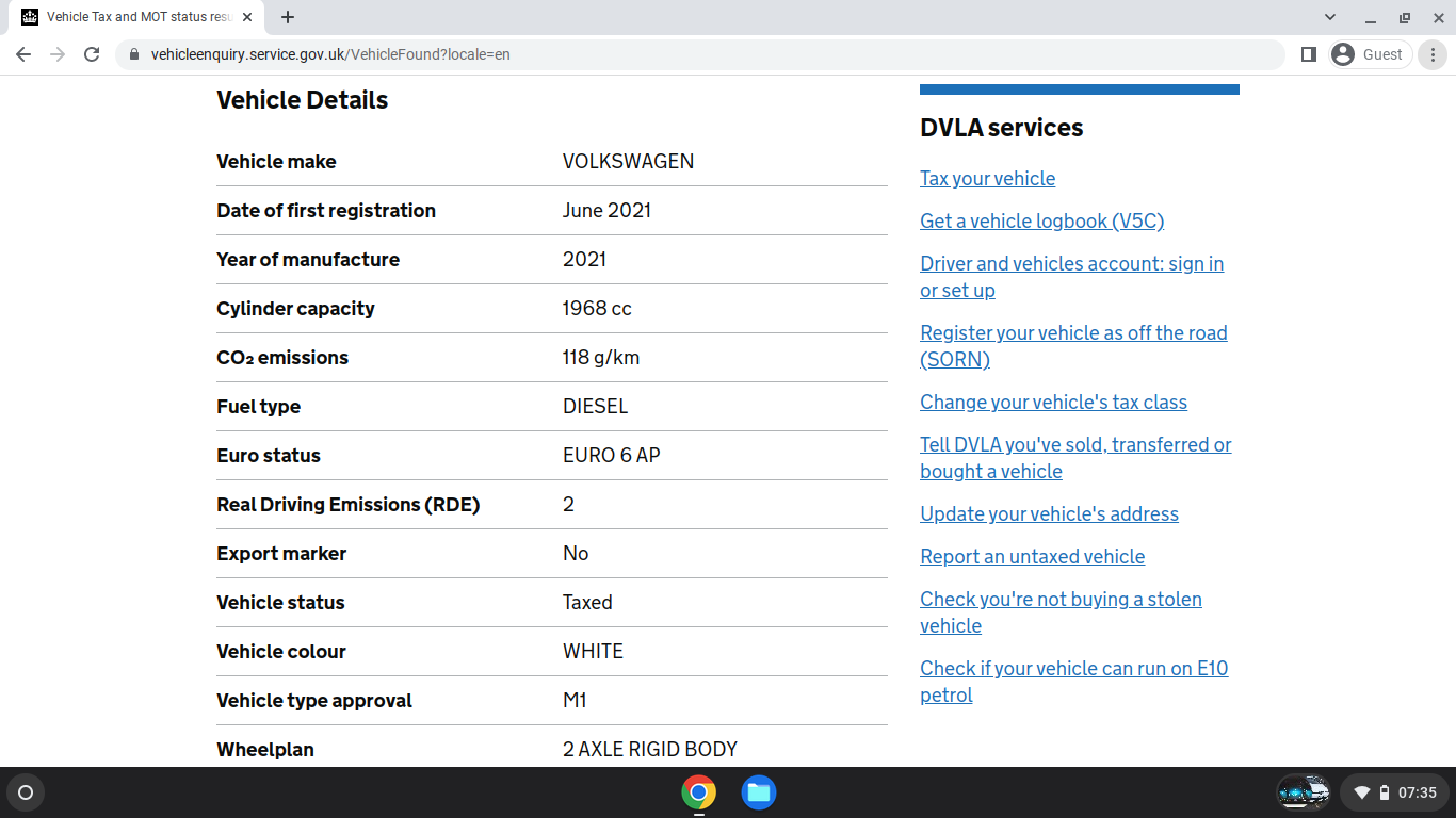

Not Octavia,s maybe, but now there are VW Group vehicles with 2.0 TDI,s with 115 ps and DQ200 DSG,s.

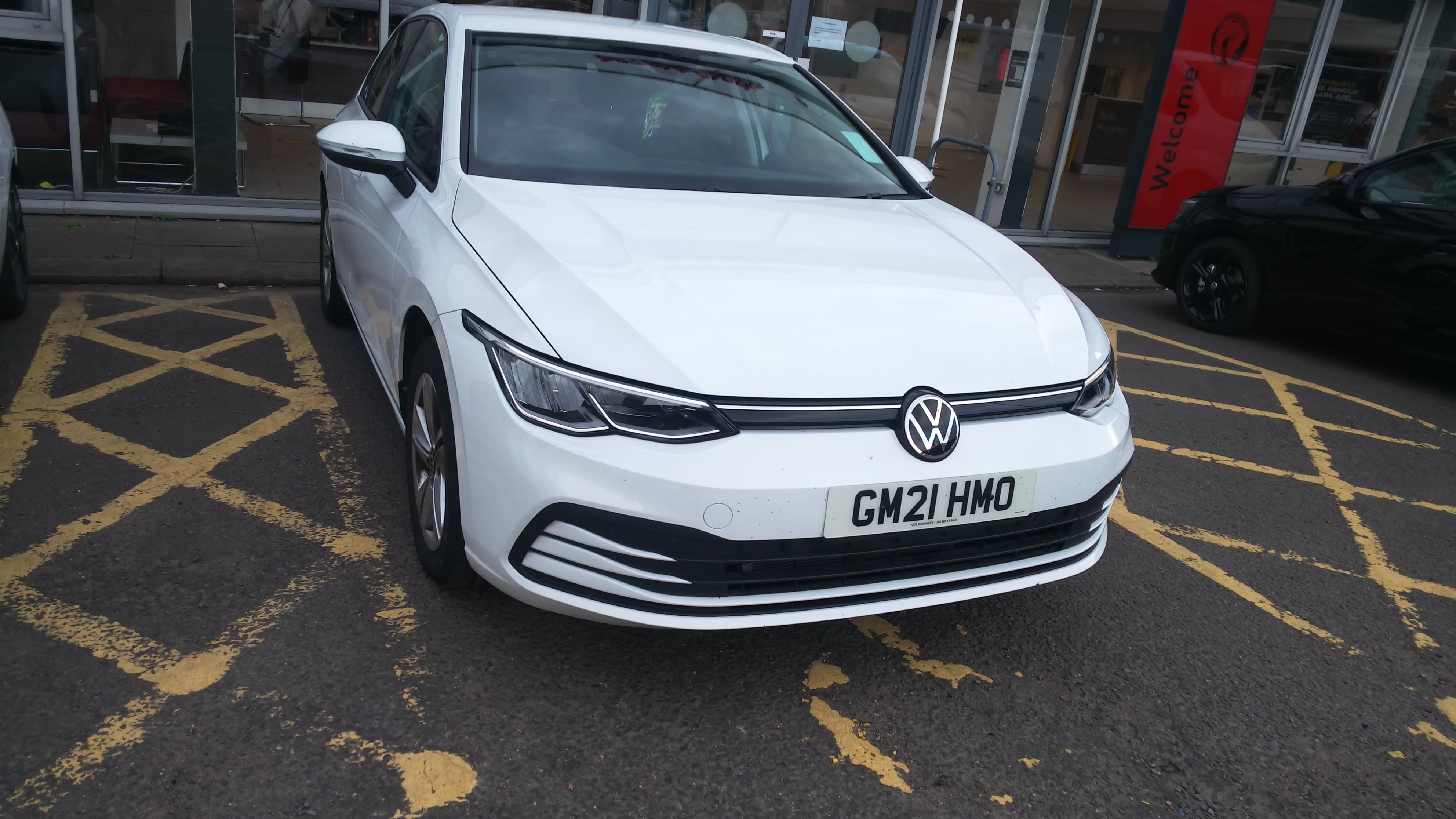

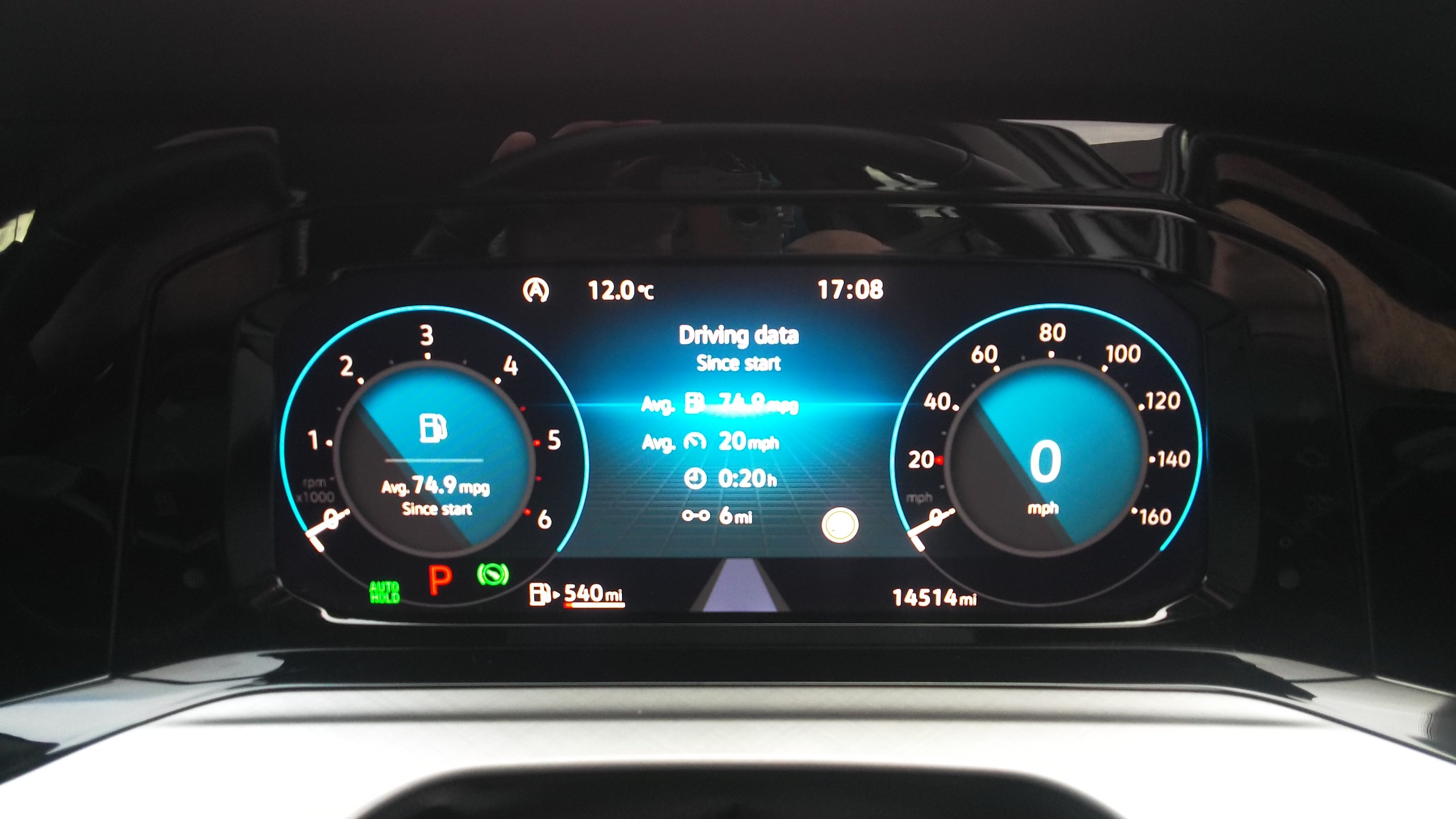

@MarkyG82  I had this one on loan for a week.
This was the consumption taking it home on the back roads after the delivery driver had driven it 30 miles Perth to Dundee.
It was amazing for fuel efficiency and could nip along.   Over 70 mpg was easy even on the Motorway.
It could hardly pull away in 1st to 2nd without bogging down so needed put into S.
Hardly no physical buttons and the stuff not lit up on the dash.  I was happy to hand it back.
