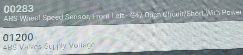

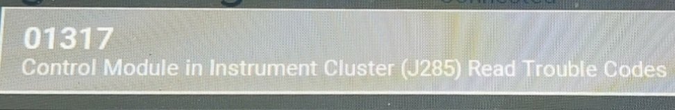

Power steering light.
29 minutes ago, Breezy_Pete said:
Might be the actual front left (nearside) sensor, or possibly a broken wire or corroded connection in the loom plug,  Worth checking wiring near connector, and visual impression of connector contacts before spending on a replacement sensor, if poss.
The ABS code I would be suspicious of relating to the blade fuse that the thinner red/green wire is going to (25Amp one?) or damage to that wire between there and ABS module. Unplugging connector from ABS module, and measuring voltage at the relevant connection would be ideal. Will give pin number later.
Ok will do thanks

Hiya I got up this morning and the abs pump is continually running. I checked fuses yesterday was half way discounting wires from pump but something came up and push it back in. Also should I start a new thread for abs pump?
Engine management light is on now 😂😭
Just thought you might like to know I put the old abs unit back on car all lights have gone out apart from the abs light so it was a faulty unit thankfully I saved the original one. It wasn't a fun job to do either 🤣 those bolts kept wanting to thread but got there in the end just need to bleed breaks tomorrow.
