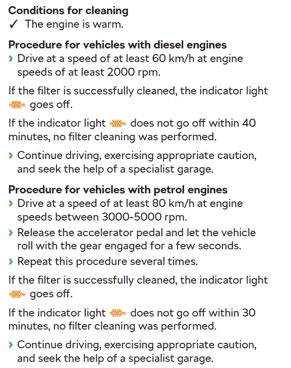

I don't recognise the DPF warning light ,coming on, or had any maxi dot messages come up.
Do I have a DPF issue or not?

I don't seem to have a DPF filter warning light, presumably it should?
