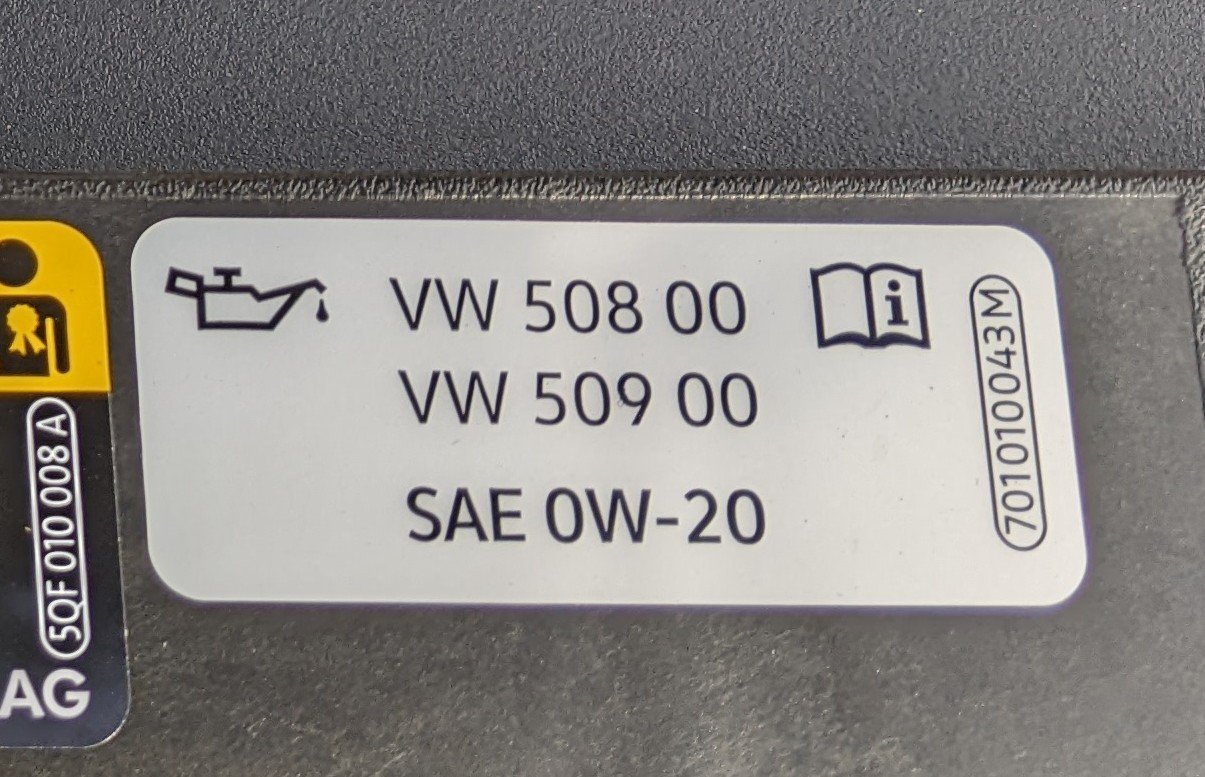

The Skoda / VW Recommended Oil for your engine, variable or fixed service intervals is to VW508 00 / 509 00.
So that is 0w 20 FS IV,
(Not 0w 30 FS III that was still recommended for some TDI,s after Skoda VW mostly changed them from VW504 00 / 507 00)
From 2018 on sort of thing, for the WLTP coming up.
978336644_PXL_20220201_1239586032.jpg.fbba922bb944034df01ad2b359d6ed5a.jpg.d501fe7835aef42c862388efccb7aea3.jpg.d39ed6163c8bc92115bea0917584b605.jpg
image.webp.b48e6771853b15b770e956a10ec5660b.webp.c03dc20c32590875ea6762a536ada72c.webp
Edited by Ootohere
My gawd, whoever allowed that sticker on a VAG product is for the sack, giving away the multigrade suggested, what a slip up !  Based on the quality of VW engines and not worrying about the stretched mpg claims needing such stuff I'd still go 5w-30, 0W-30 if buying a step up in price quality.
I've corrected my previous post based on the better info from Ootohere's post, I would definitely want good or better quality oils at 0w-20, no "cheap" stuff.
Thanks I'll try the 0w/20 to start with maybe update to the 5w/30 or 0w/30 later.
@Ootohere maybe I should stick to 0w/20 if this car has a GPF?

Jumping in I am being a bit unkind to 0W-20, a good 0W-20 will be a very good oil, that particular multigrade has little to do with GPF as the other multigrades mentioned cover GPFs too,  ETA: if you're not keeping the car long term stick with 0w-20 and if using a very good 0w-20 you could probably stick with that for the car's life as that multigrade will also improve with time and availability as markets catch up and new higher levels become the norm.
A good oil is a good oil, and a better oil is a better oil, it's a matter of getting what's appropriate.  The 0w-20 oils (and well below this have to be good) the 0w-20 is to help get the nth fraction more mpg out of the very ancient basic internal combustion engine.  As always the better build and quality the engine is the greater its parameters to use and abuse, personally I think VW have been and are a bit rough which is mostly fine in the short and medium term but less so longer and much longer term.
