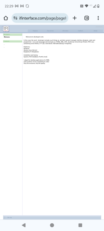

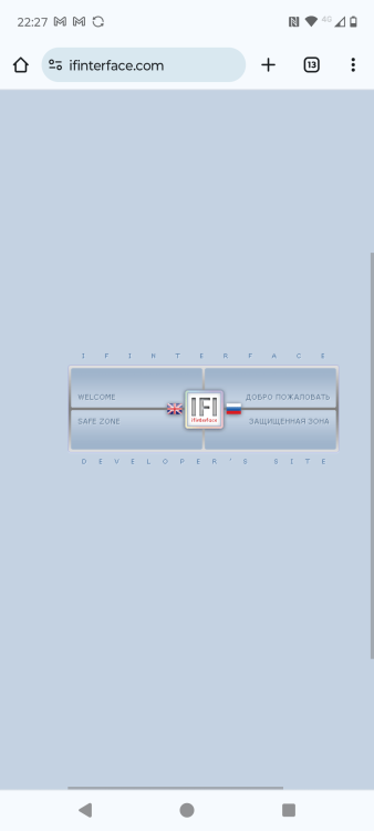

Typed that in got some developer site, nothing about Skoda.

This I is what I get

As far as I understand the fuzzy 2nd screen shot, You don’t go far enough
Try this path:
Welcome > Free services > CarProg2
Then select what is relevant in the different drop down menus (brand, model, model year, components group)
