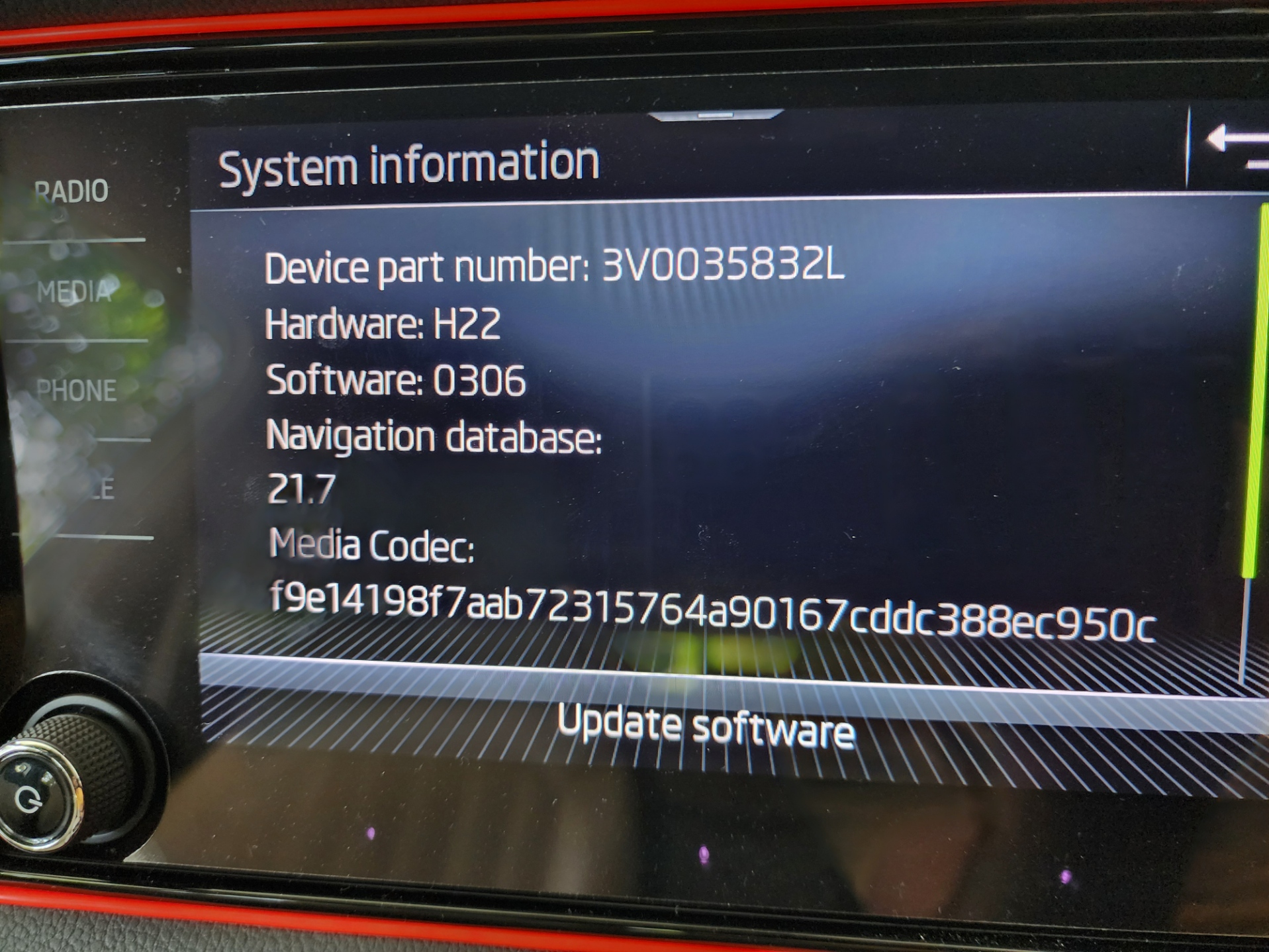

Hello my self YASH i m from India i owned facelift Kodiaq 2L TSI EA 888 Gen 3
recently i updated my Columbus MIB 3 (has NAV button) system SW from 0306 to 0324 to 0330. It was successful with the red engineering menu.
My old system info is:
Device part number: 3V0035832L
Hardware: H22
Software: 0306
Navigation database: 21.7
Media Codec: f9e14198f7aab72315764a90167cddc388ec950c
PHOTO-

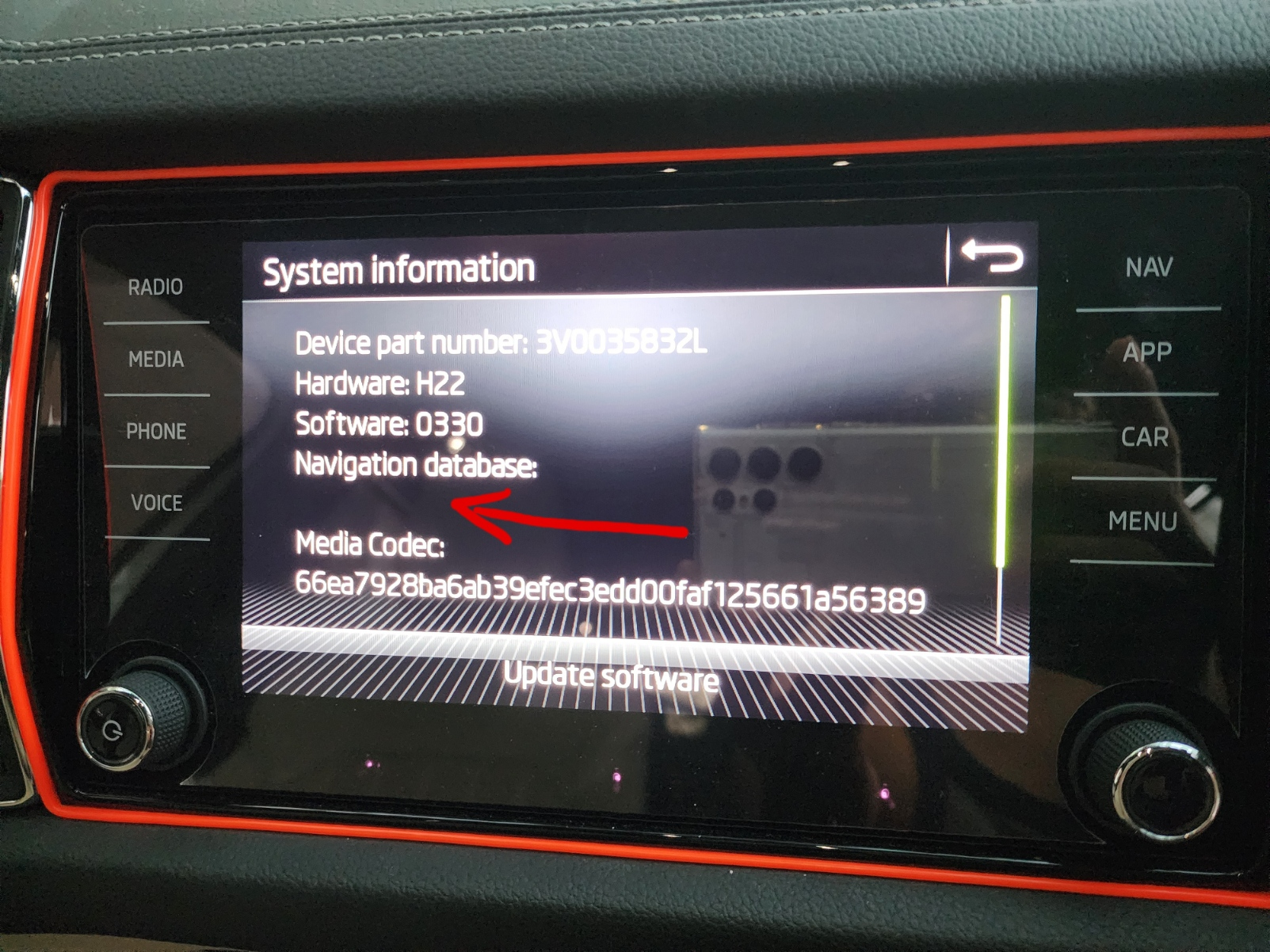

NEW system info is:
Hardware: H22
Software: 0330
VOICE MENU Media Codec: 66ea7928ba6ab39efec3edd00faf125661a56389
PHOTO-

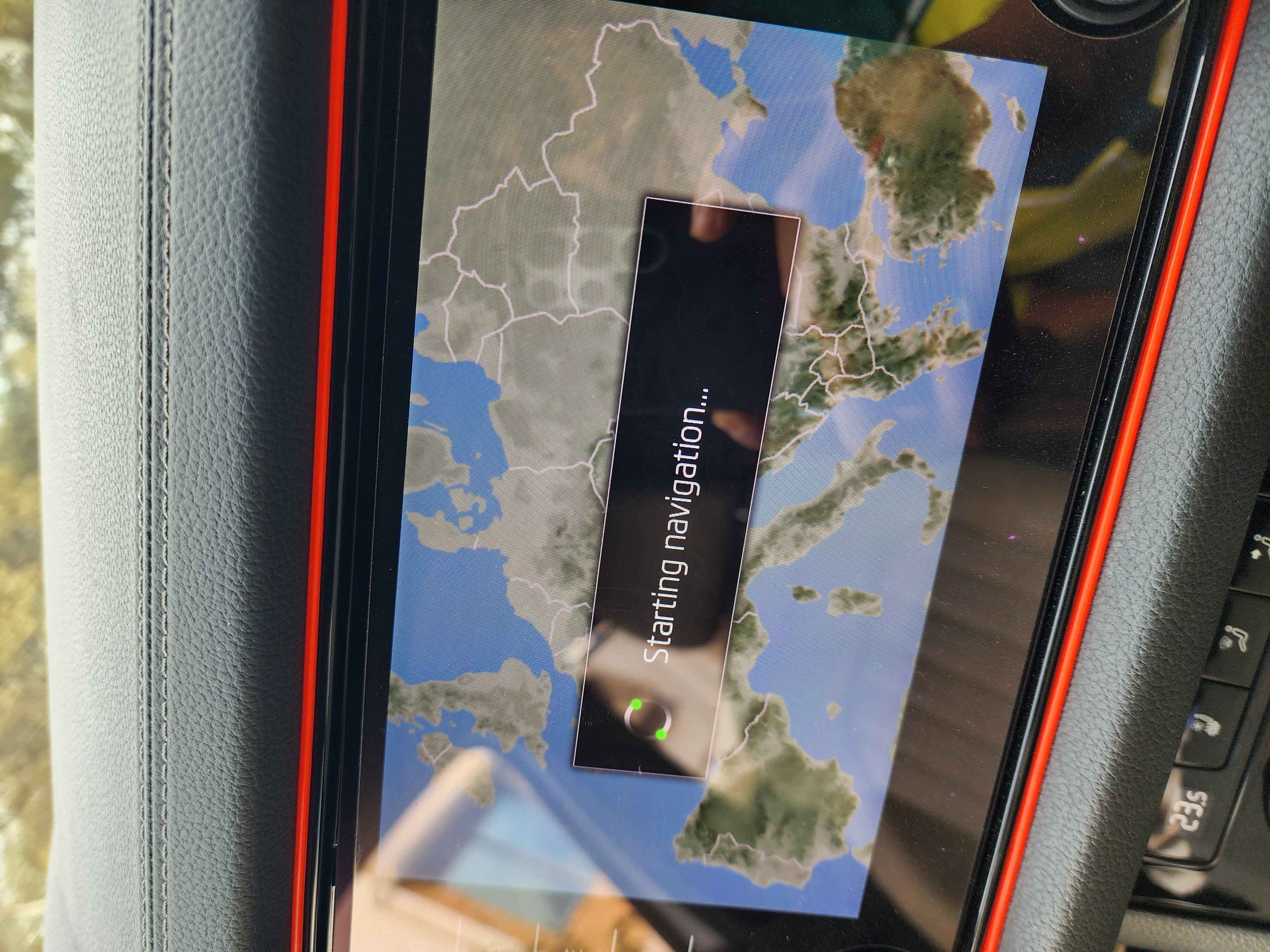

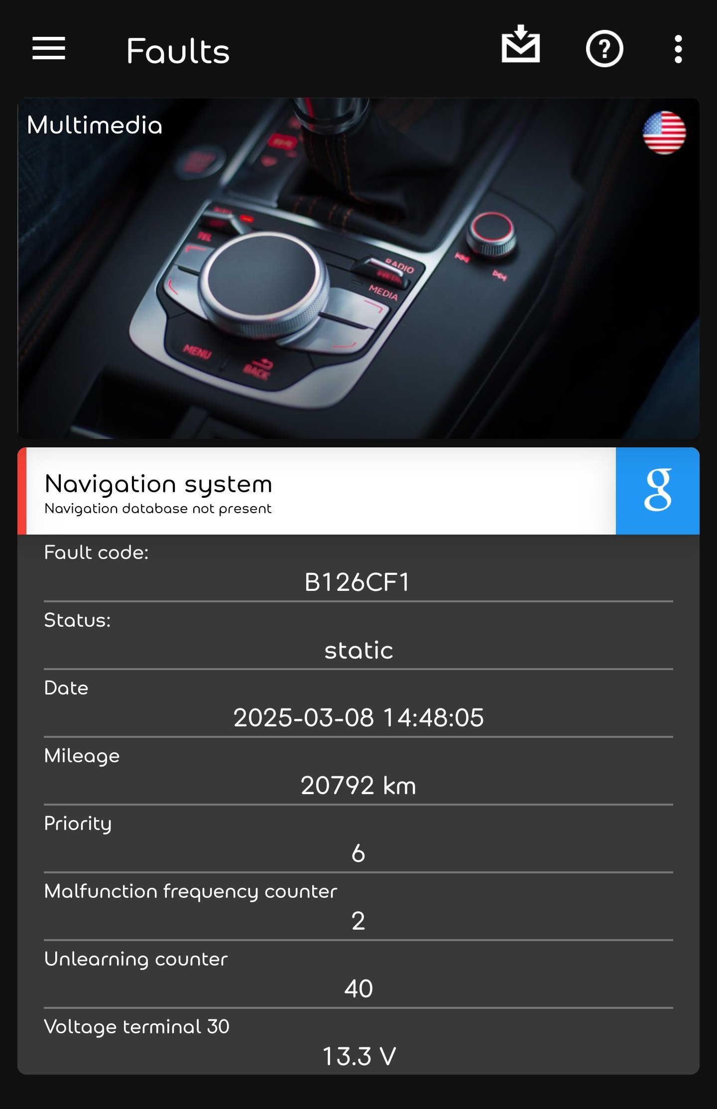

As you can see in the photo the Navigation database version is missing and my NAV didn't work at all it keeps loading on starting navigation... nor working on Digital cockpit. Help!

Probably the navigation FeCs. Generally you'd have been better not to have updated the firmware then the only question would have been getting the navigation map in. It's the firmware update. You might be better off posting on a firmware thread. There is the normal stuff about loading in the maps etc. Not sure whether a firmware update deletes the maps. If it's some package from somewhere you might have ended up with the European FeCs rather than the RoW Navigation FeCs thus why I say you need a firmware expert on Mib3.
Also photographing the FeCs before and after would show you what changed.

My OBDELEVEN says the same thing
