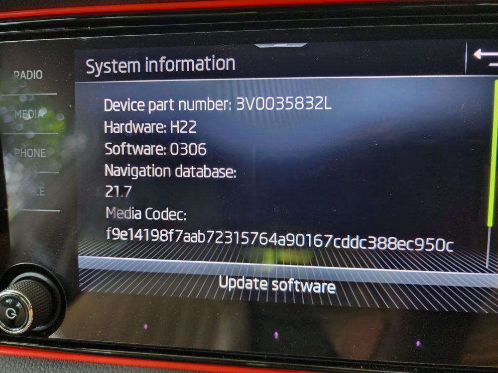

On 08/03/2025 at 19:04, YashD111 said:

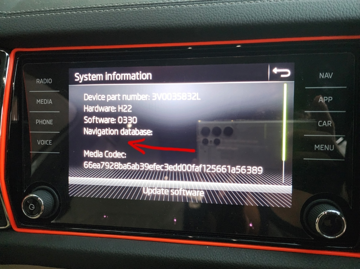

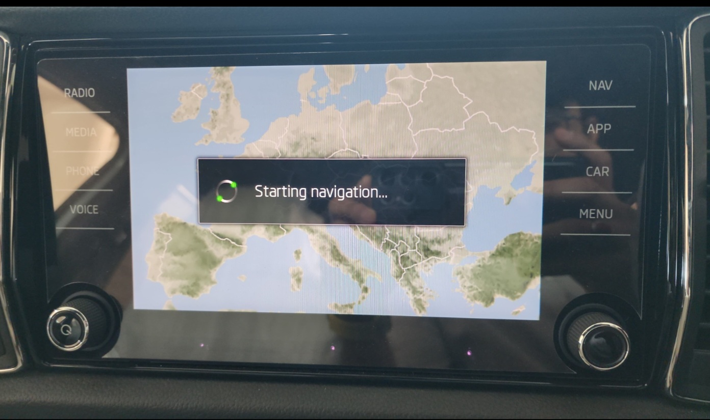

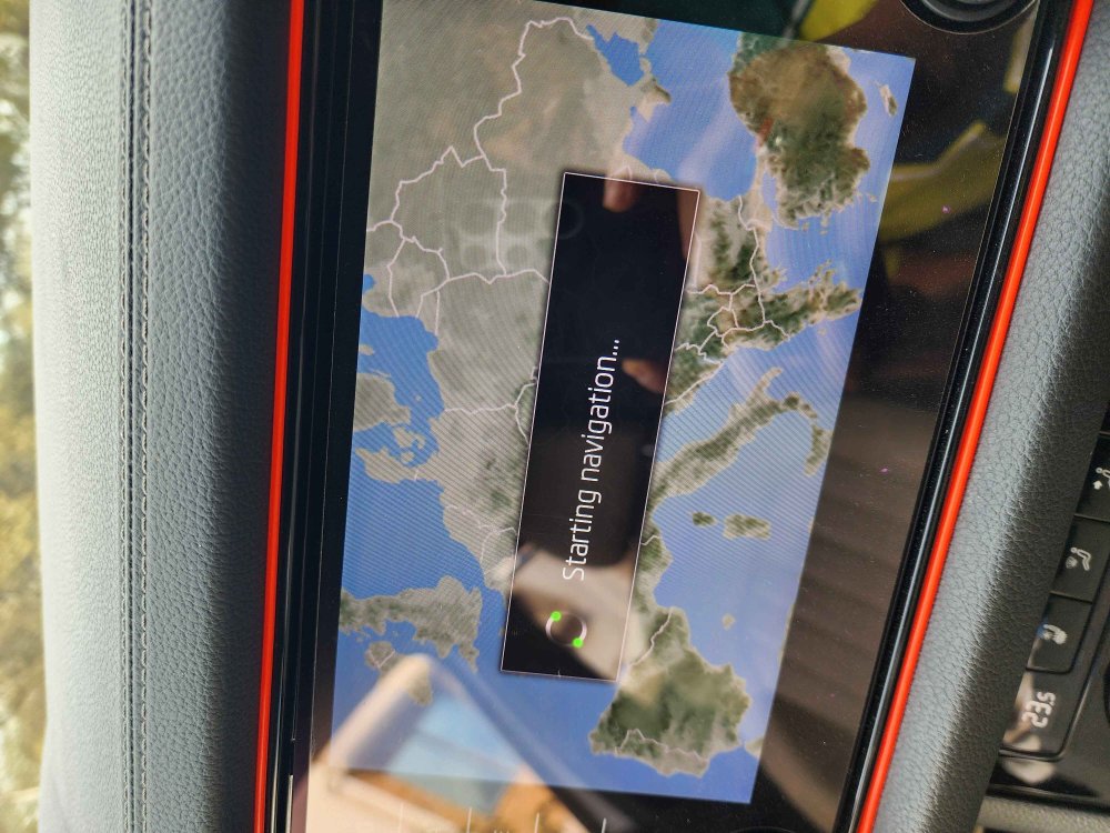

Hello my self YASH i m from India i owned facelift Kodiaq 2L TSI EA 888 Gen 3
recently i updated my Columbus MIB 3 (has NAV button) system SW from 0306 to 0324 to 0330. It was successful with the red engineering menu.
My old system info is:
Device part number: 3V0035832L
Hardware: H22
Software: 0306
Navigation database: 21.7
Media Codec: f9e14198f7aab72315764a90167cddc388ec950c
PHOTO-
NEW system info is:
Hardware: H22
Software: 0330
VOICE MENU Media Codec: 66ea7928ba6ab39efec3edd00faf125661a56389
PHOTO-
As you can see in the photo the Navigation database version is missing and my NAV didn't work at all it keeps loading on starting navigation... nor working on Digital cockpit. Help!
Also tried to update map (india map 8gb) from Update portal
and followed the MIB3 colombus pdf for usb case but didn't work as well
also contacted the dealer but no luck.
need Help!

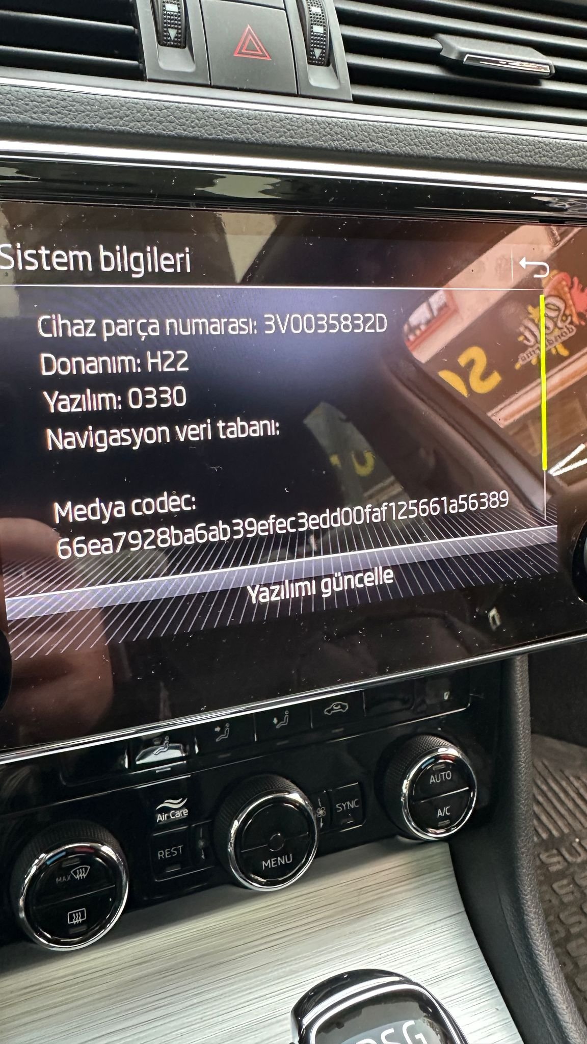

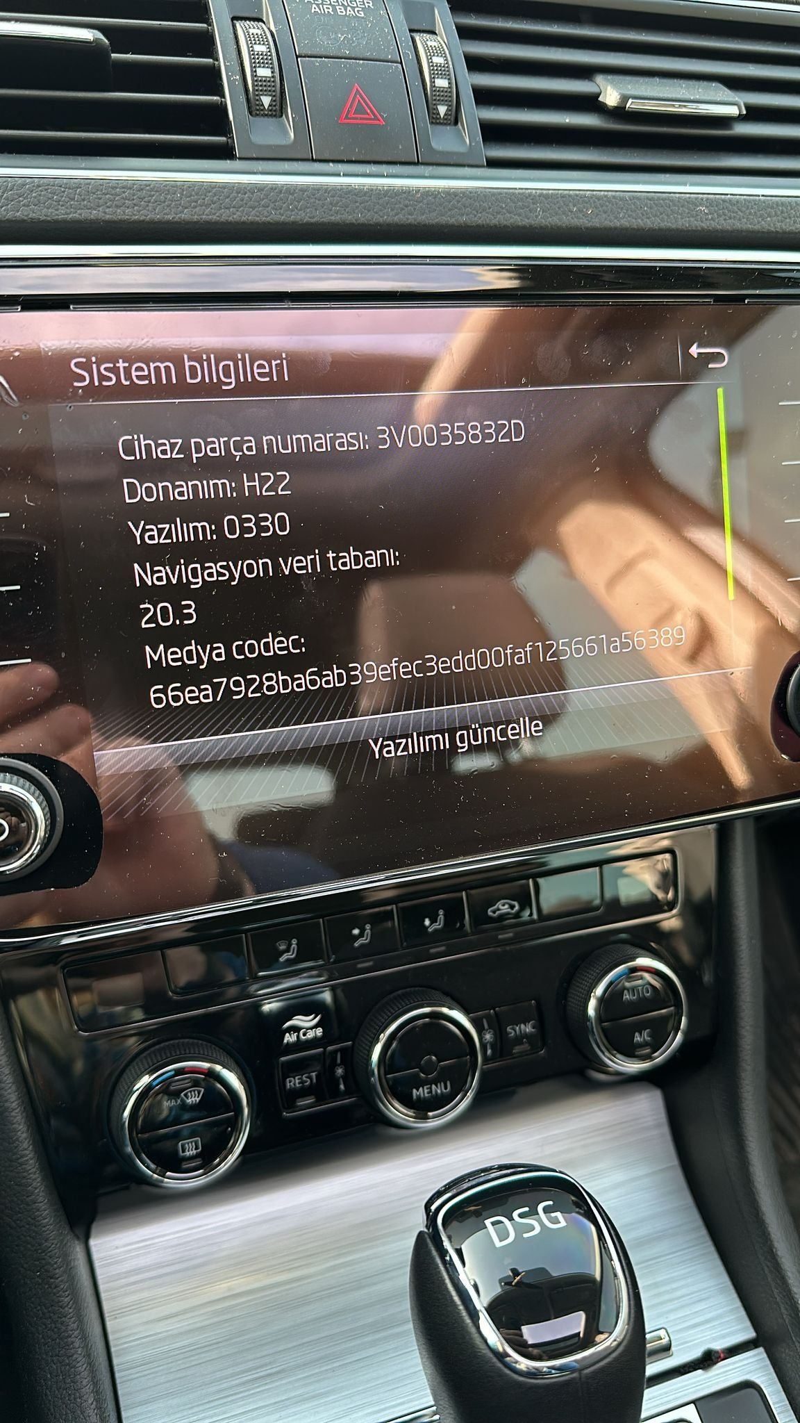

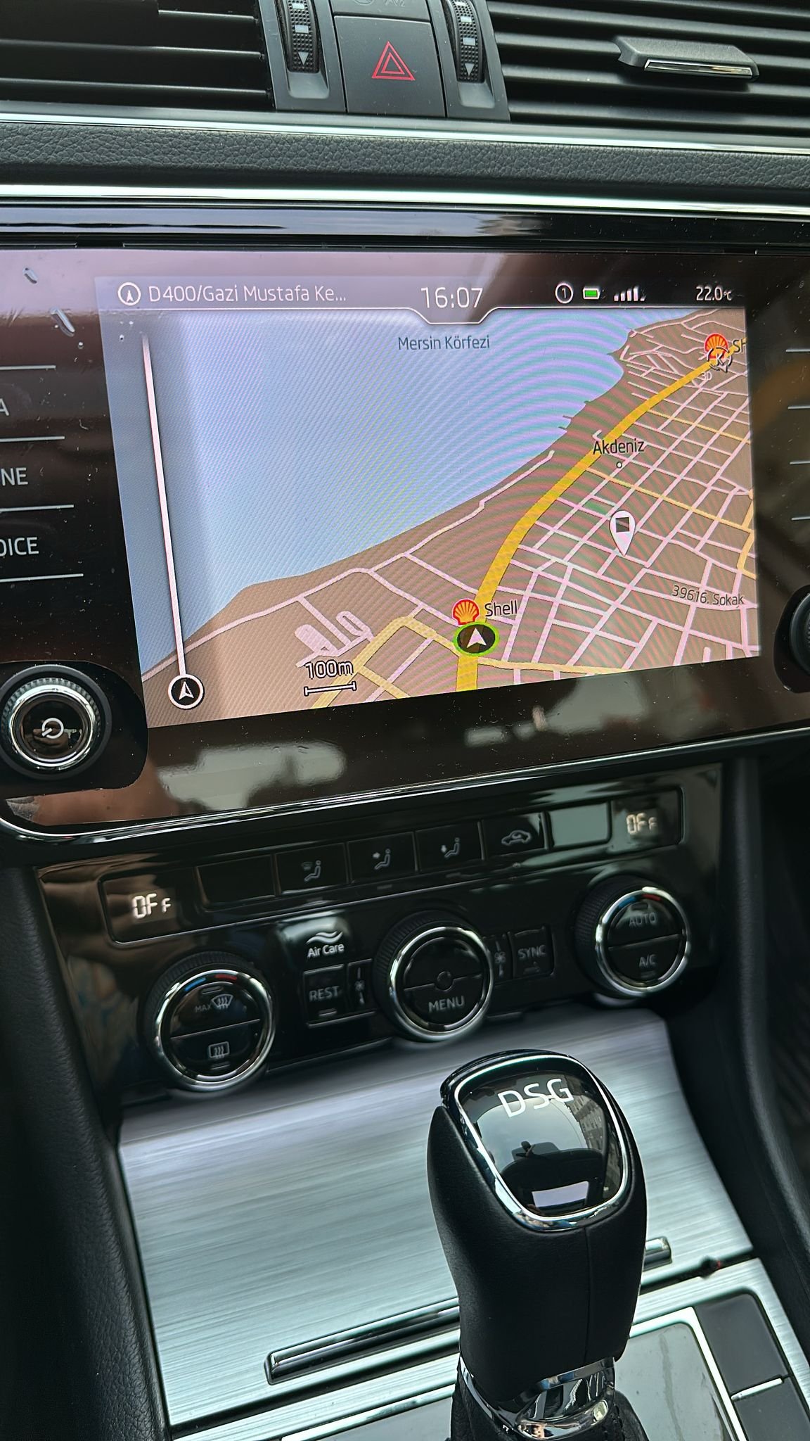

hi everybody.
mibsolution website update files are faulty (330).I recently updated it 0270,308,330..I applied navigation patch after 330(with vcrn code).I didn't have any problems.If the hidden feature is active in your vehicle before updating, you need to restore it (video motion,radio AM enable..).I will share the new update link and details below.
308 and 330 update file (only RW not EU)
https://www.drive2.ru/l/695736324514133028/
The procedure is as follows:
1) Reinstallation of 332 software
2) Checking the full.bin file (exactly the VCRN has changed) 3) Disabling functions:
— MirrorLink disabling speed threshold in motion (MIB3): 0
— Wi-Fi 2.4 GHz Hotspot (MIB3) [U:5F][$0519]: Disabled
— MIB3: Ethernet configuration channel 4 [U:5F] [$09D3]: Disabled
— Applink: Mirrorlink [MIB3] [U:5F][$0555]: Disabled
— Activate the developer mode in the multimedia system [U:5F][$243F]: Disabled functions (do not forget about the manual, open hood) with GU overload. 4) Patch reinstallation

My map is not up to date. How can I update this Europe map? When I enter with VIN code, Europe does not appear(only turket,india..) Meanwhile from TURKEY!

yes i now i know that why my navigation database is missing the version no.
its because while updating to 330 i haven't known abt these points, that you have mentioned.
i haven't revert any of those extra hidden features to its original values, i have that i have enabled via obdeleven app
so you Can you explain how did you fix it in more details step by step. Please i m having very rough time with the dealership my car is in the works workshop since 3 weeks now. It would be very helpful, If see me as your younger brother! Uploadingbrother!image.png

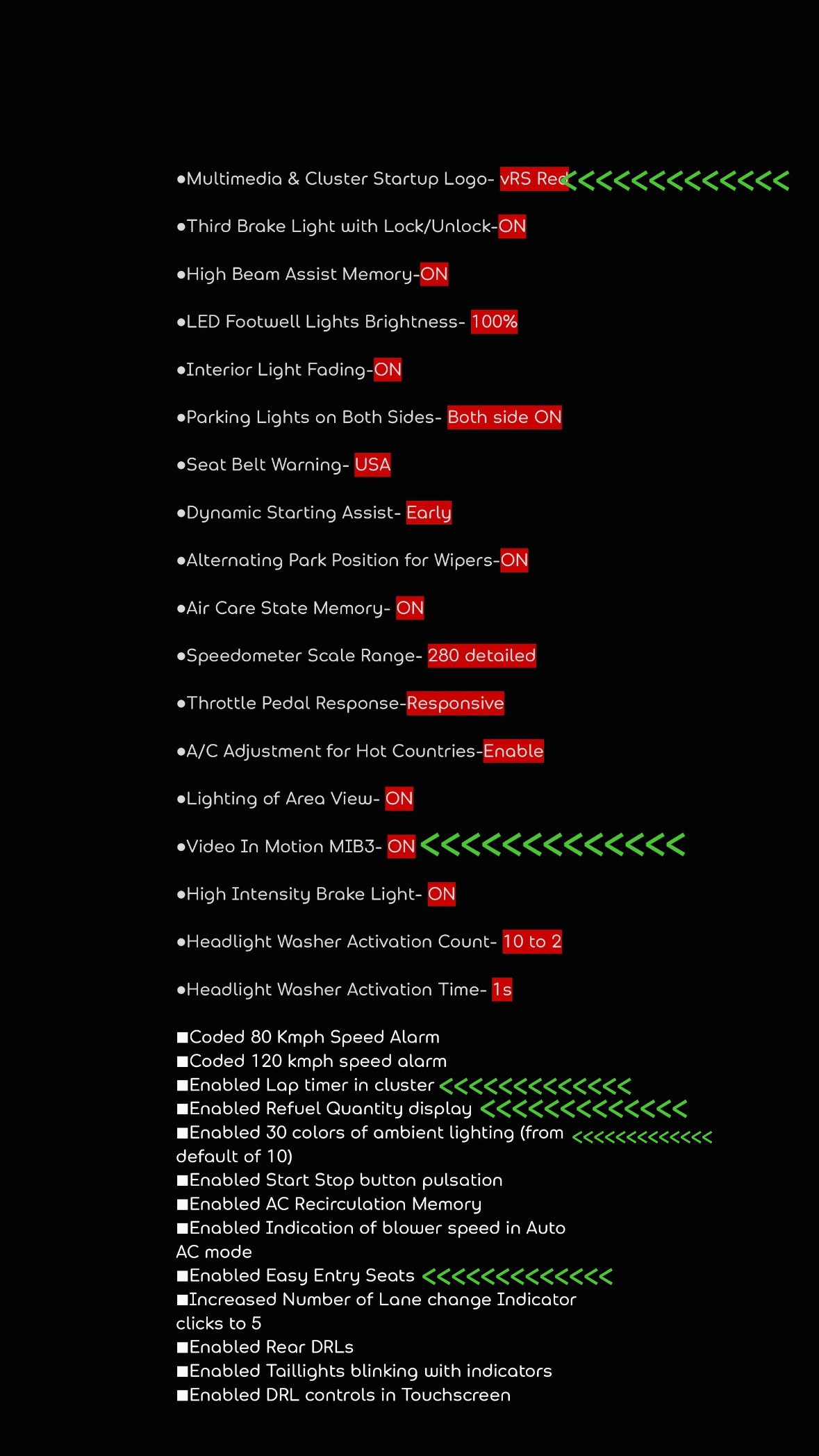

hi friend you have enabled via obd eleven
1.AM radio disable? (enable)
2.30 colors of ambient lights
3.comfort seats?
4. the menu of locking? (door locking while engine is running)
check these out and reload 330 Firmware.then reinstall the patch and make sure the vcrn code is correct

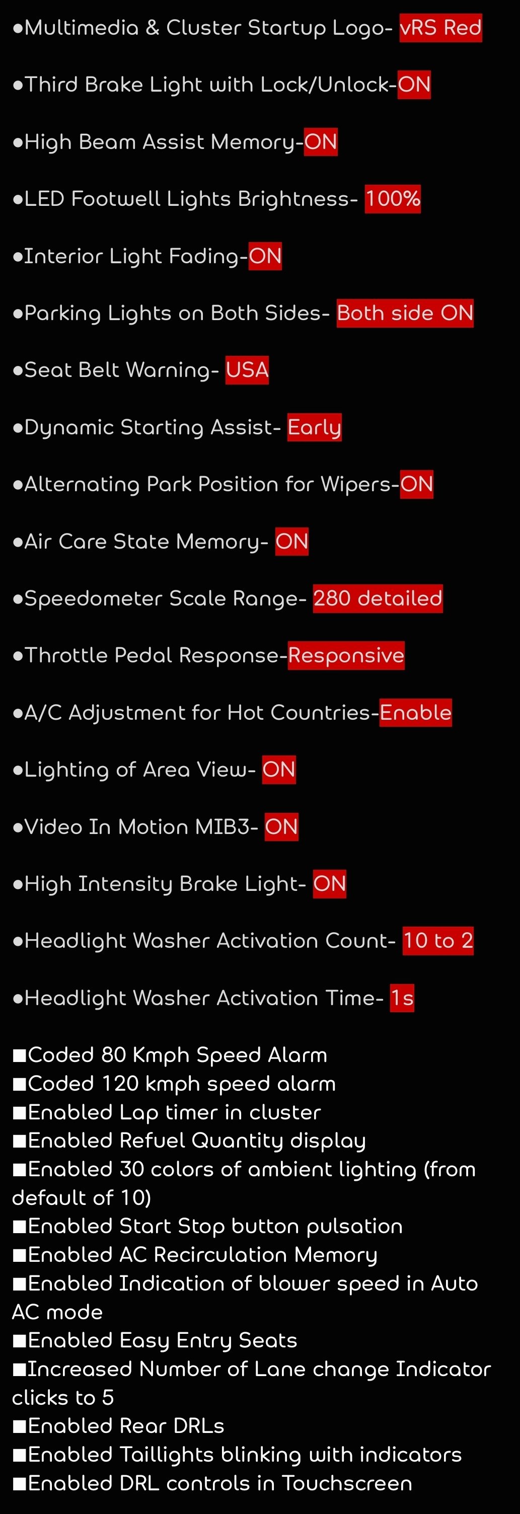

Yes i actually done too many changes since my car was 1800km
Some of done by professional and some of did by me.
Recently i heard abt the 330v so i tried to implement it and the Navigation database just disappeared.
This is my OLD system info 👇
This is after the update 👆
So as per you- i have to undo all the changes i have done??
I have note down all the changes i made.
appreciate your reply!

close my highlighted ones.Reinstall update 330.Reapply the patch you created with the vcrn code.

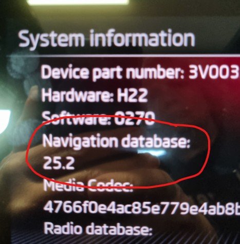

OK I see there is a new map for AUSTRALIA and NEW ZEALAND on the Skoda portal today
Defintition OP _146........... Contents dated mid March 2025
INSTALLED THIS MORNING AND NEW MAP DEF IS 25.2
