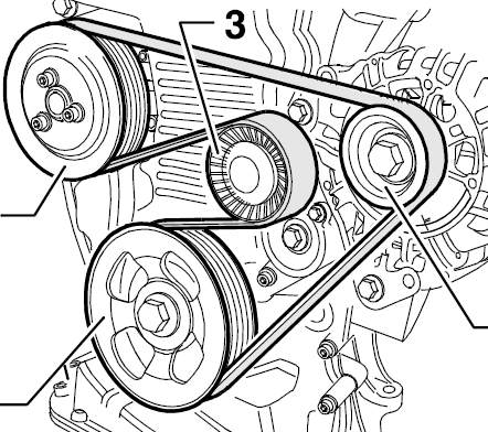

Our mechanic friend suggests bypassing the air con compressor / removing it and the guide pulley above using the shorter belt that is designed for the non air-con version.
I just spoke to a motor factor who said that would not work.
Is he right because I have doubts looking at the diagrams it seems possible ?

Belt for non-A/C version of your engine is 21.8 x 1453mm long.
No reason it shouldn't work if routed correctly.

Should be this, I think:

The motor factor guy was full of horror stories of different size pulleys etc but as you point out - from the diagram it just seems like rerouting to miss out 2 pulleys with a shorter belt
12 minutes ago, Mkcheznous said:
The motor factor guy was full of horror stories of different size pulleys etc.
That's because he's a moron, the pulleys are sized to allow the different driven units to run at different speeds, simply removing the Aircon doesn't change the speed that the belt is running at since that's dictated by the crank pulley.

Fitted the non aircon belt with no issues 6 weeks ago
