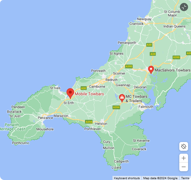

isnt it a home visit service?
Mobile towbar fitters are available in Cornwall
Google is very handy.
Screenshot2024-06-22at17-21-54towbarfittingincornwall-GoogleSearch.png.da173e1f74d03804df2d9020f0987b90.png
Cornwall.
