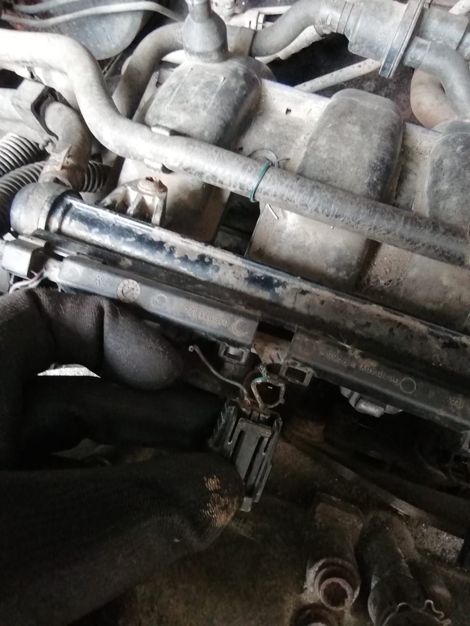

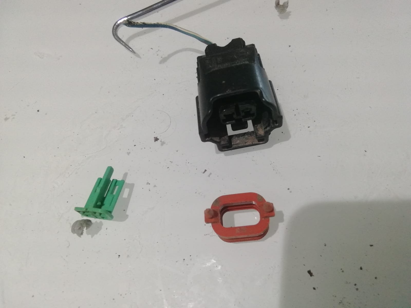

While tracing the wires to the sensor found this. The wire to the second spark plug was cut. Checked the raw wire and other connectors. One lead on to batter and one on the port got me reading of 0.6 and 3.35 on the other. I am assuming that the wires are good. Will repair the cut portion and see if that helps in the firing of the engine.
If 2 spark plugs are connected why does the engine not fire? Is there a retard if one is electrically disconnected.
Have no got a single fault code so far. Can someone please respond and guide if possible..

Isn't that a fuel injector connector, rather than a spark plug/coil connector??
6 minutes ago, Fotobob said:
Indeed it is. Thank you for pointing out. In that case, no supply to one injector retards firing of the engine?

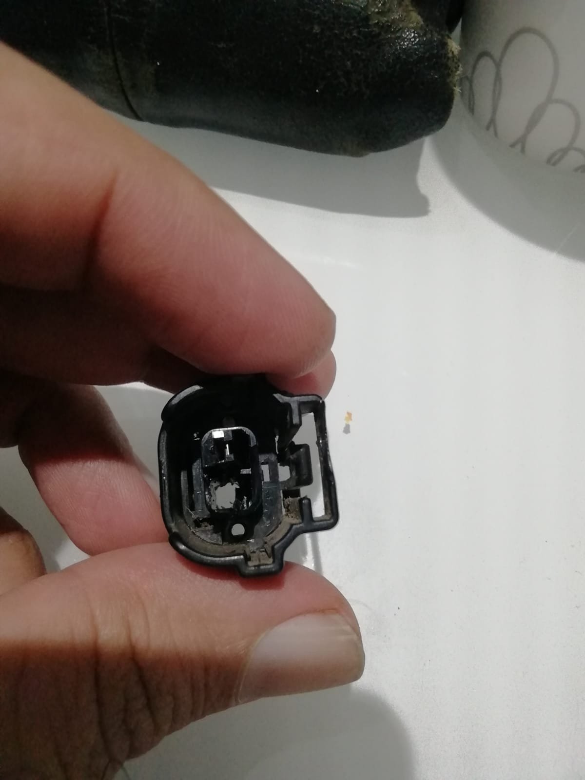

Wires chewed off at the base. Almost impossible to dismantle these. Somehow managed but damaged them a bit. Ordered for a new one but will use new pins and make the connection to check if the engine fires up. No supply to one retards engine firing?

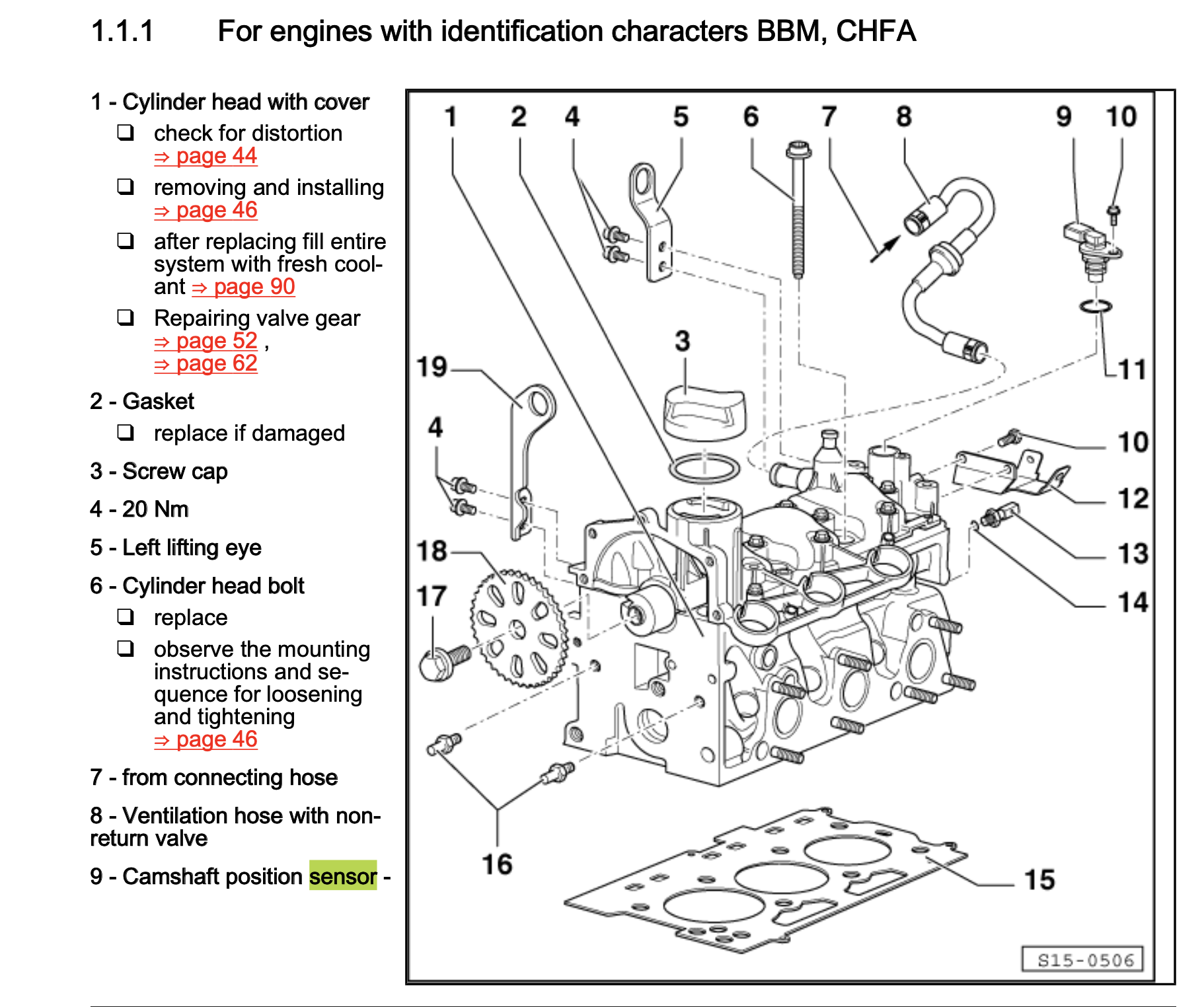

Is this the one you mentioning? I had a look at all the wiring but look in detail and open the loom and check. Thanks
  • Sponsor
No, not camshaft sensor: crankshaft sensor, much harder to access sadly.
Vertically below throttle body, mounted in engine block, 'looking' at back of flywheel.
