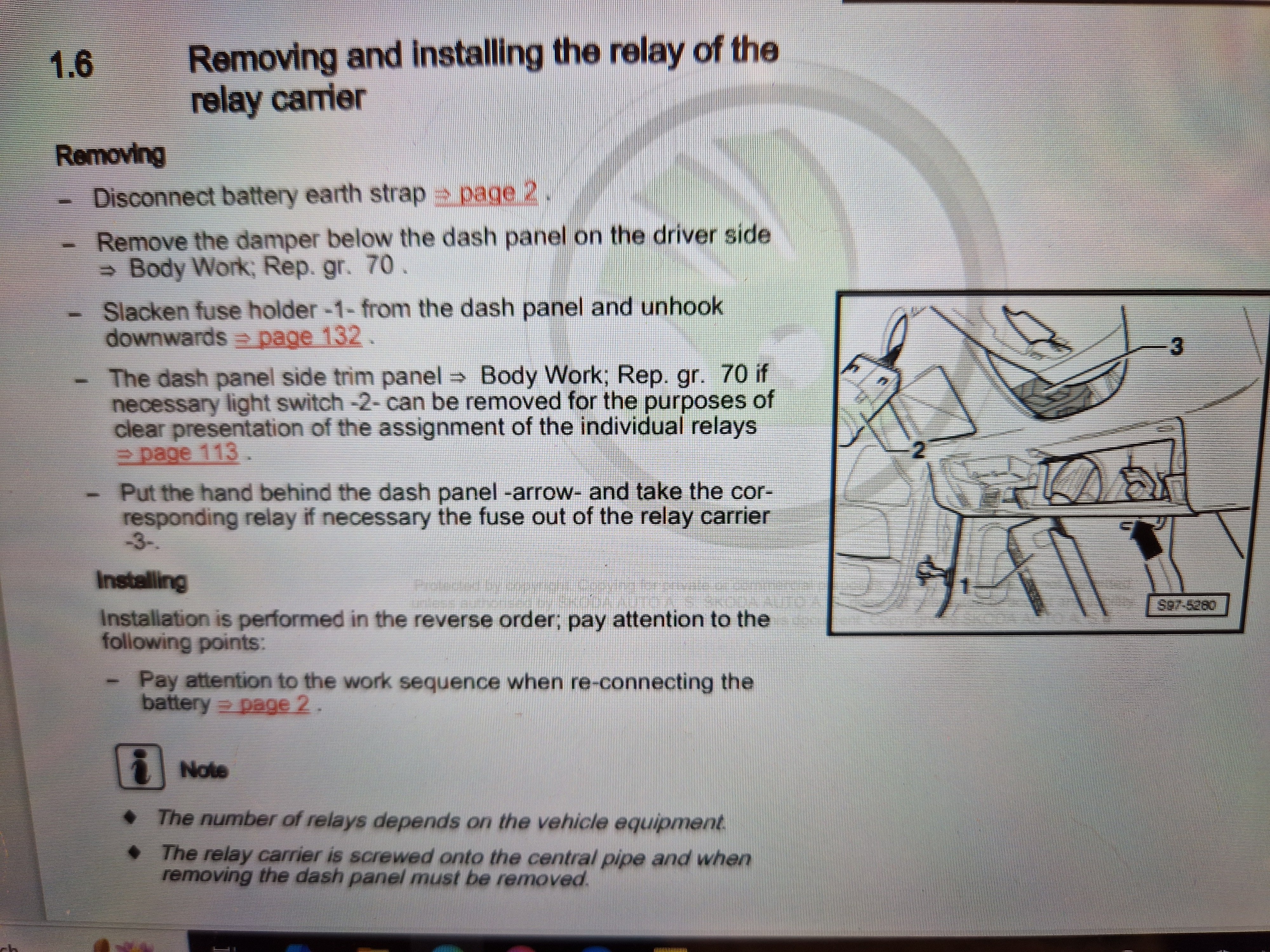

Can someone indicate where are the Relays located in the MK2 model. Not able to clear information from the web. Thanks

Oh is it. I saw a video in which it was behind the half round panel which meets the door when shut. Do you have a reference image of where this could be. Dismantling the fuse unit is a big task and would want to venture there if certain about the location.

Someone reading this who owns a mk2 Fabia can surely tell us where the relays are??
I've tried searching the web with no success, surprisingly.

https://cardiagn.com/2007-2014-fabia-electrical-system/
Scroll to page 136. I think this is what you are looking for.

Thank you so much. Will verify this with the setup I have.
  • Sponsor
This may be the same info, shows relays at position 3 in diagram.
  • Sponsor
That's a left hand drive car. I would expect everything to be mirrored for right hand drive.
Give me a moment .....
