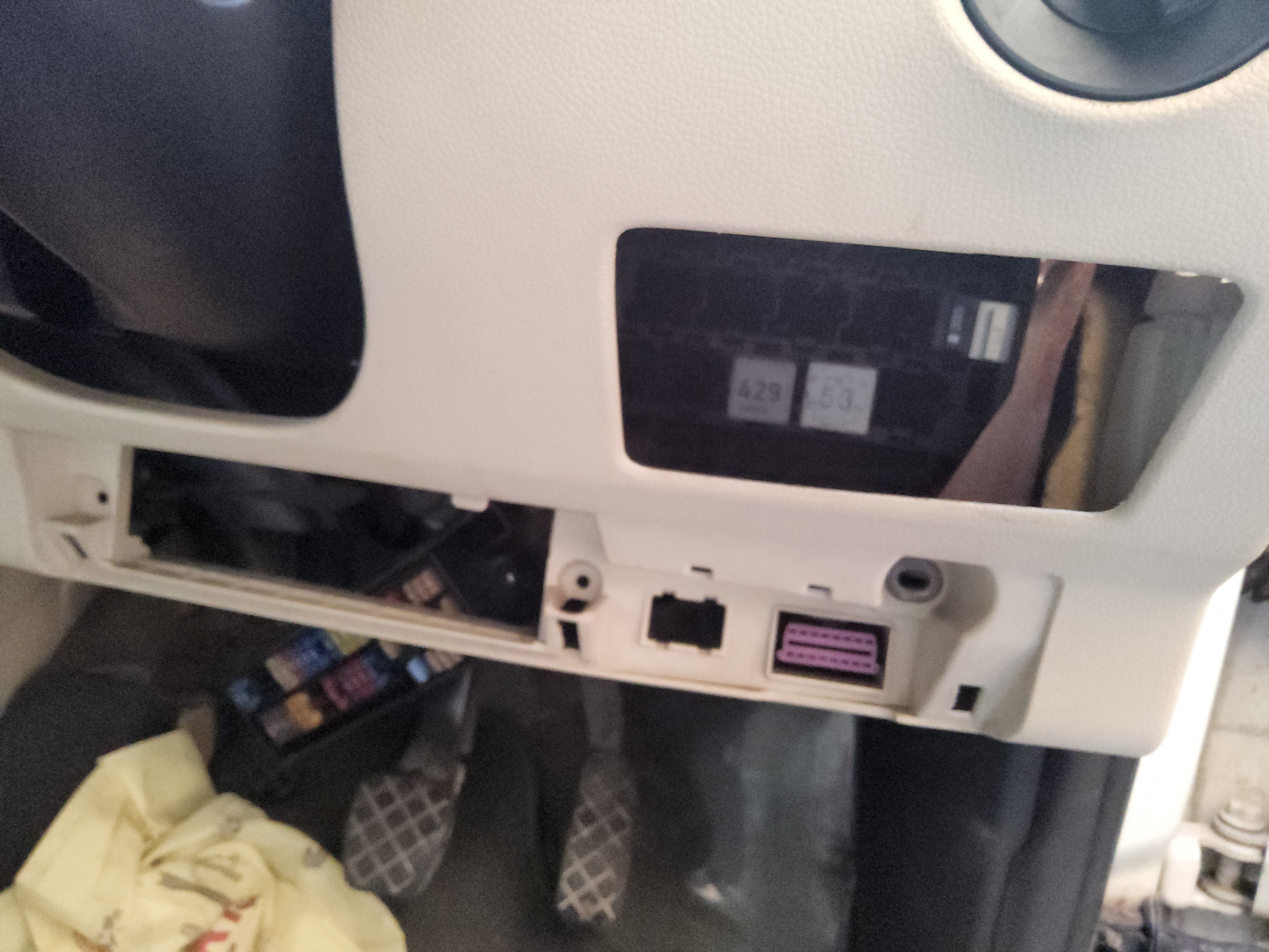

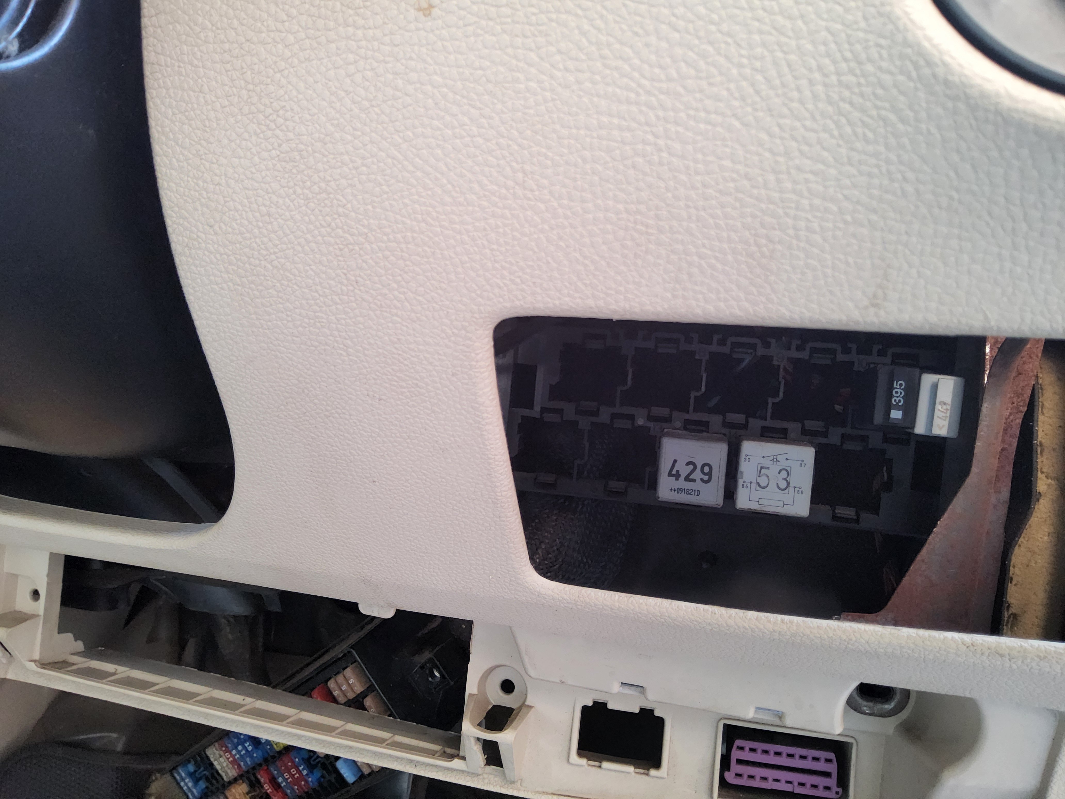

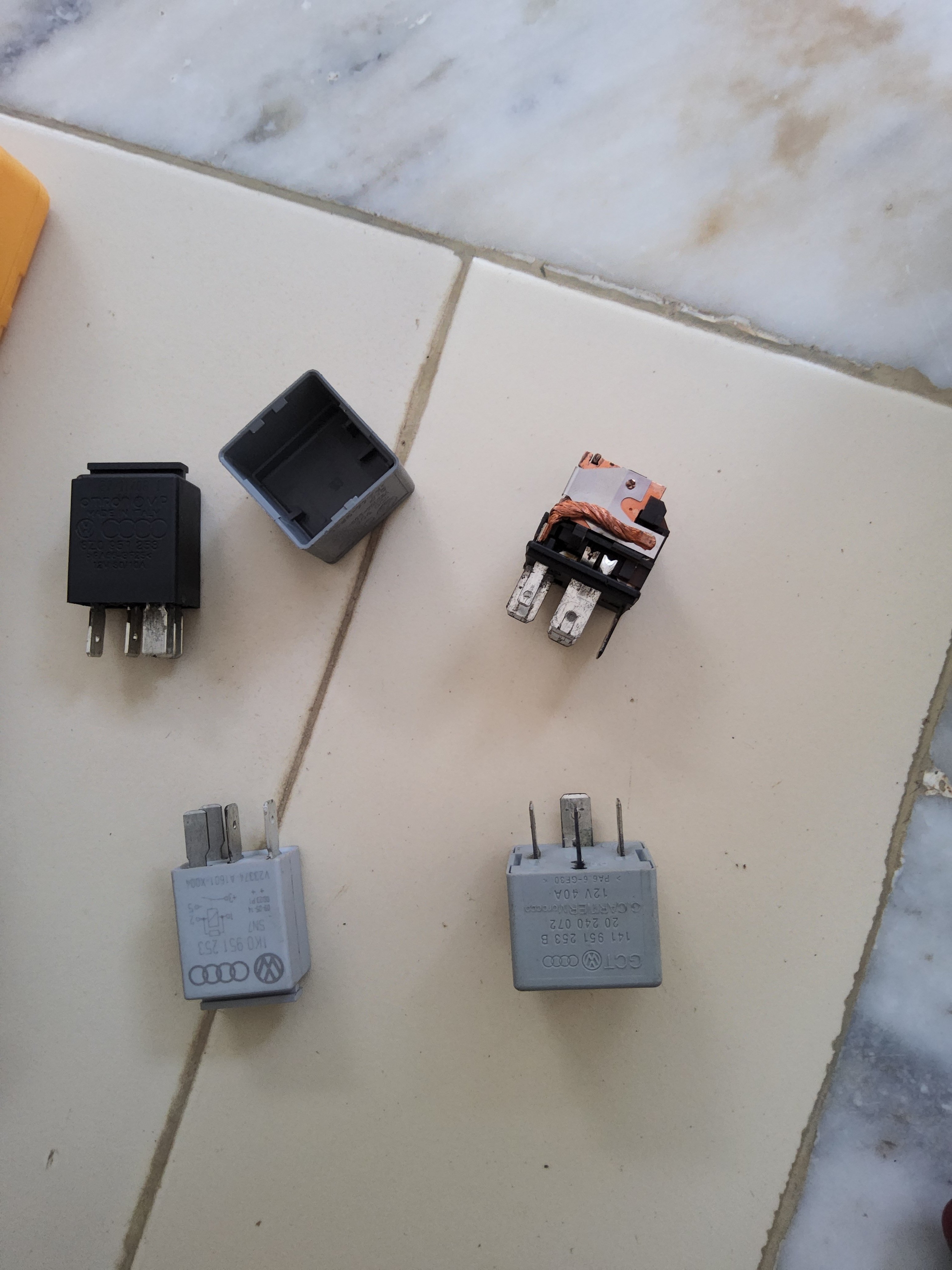

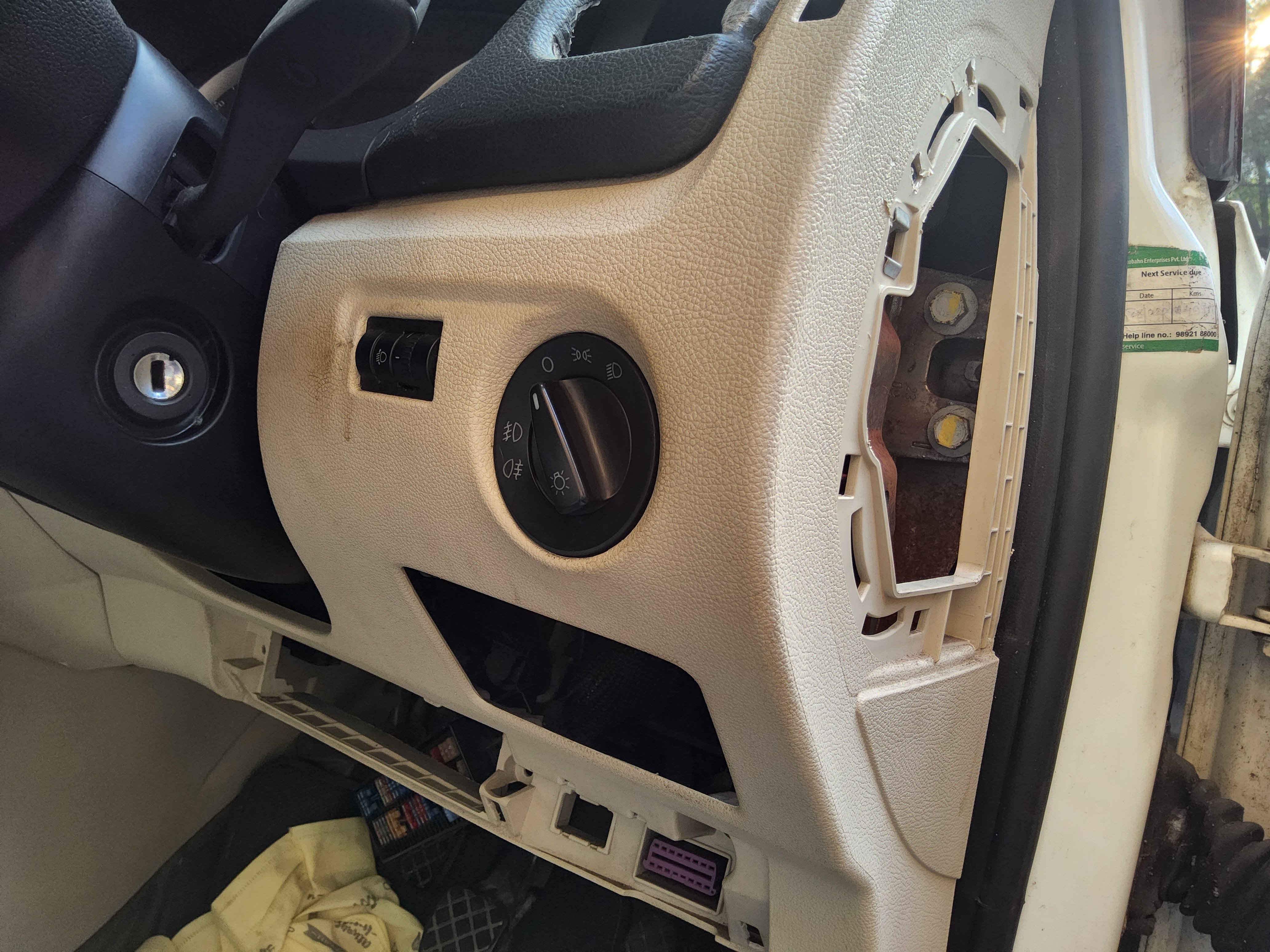

The tray below the light switch gives direct access to relays. Just got those off. I opened everything before realising this.

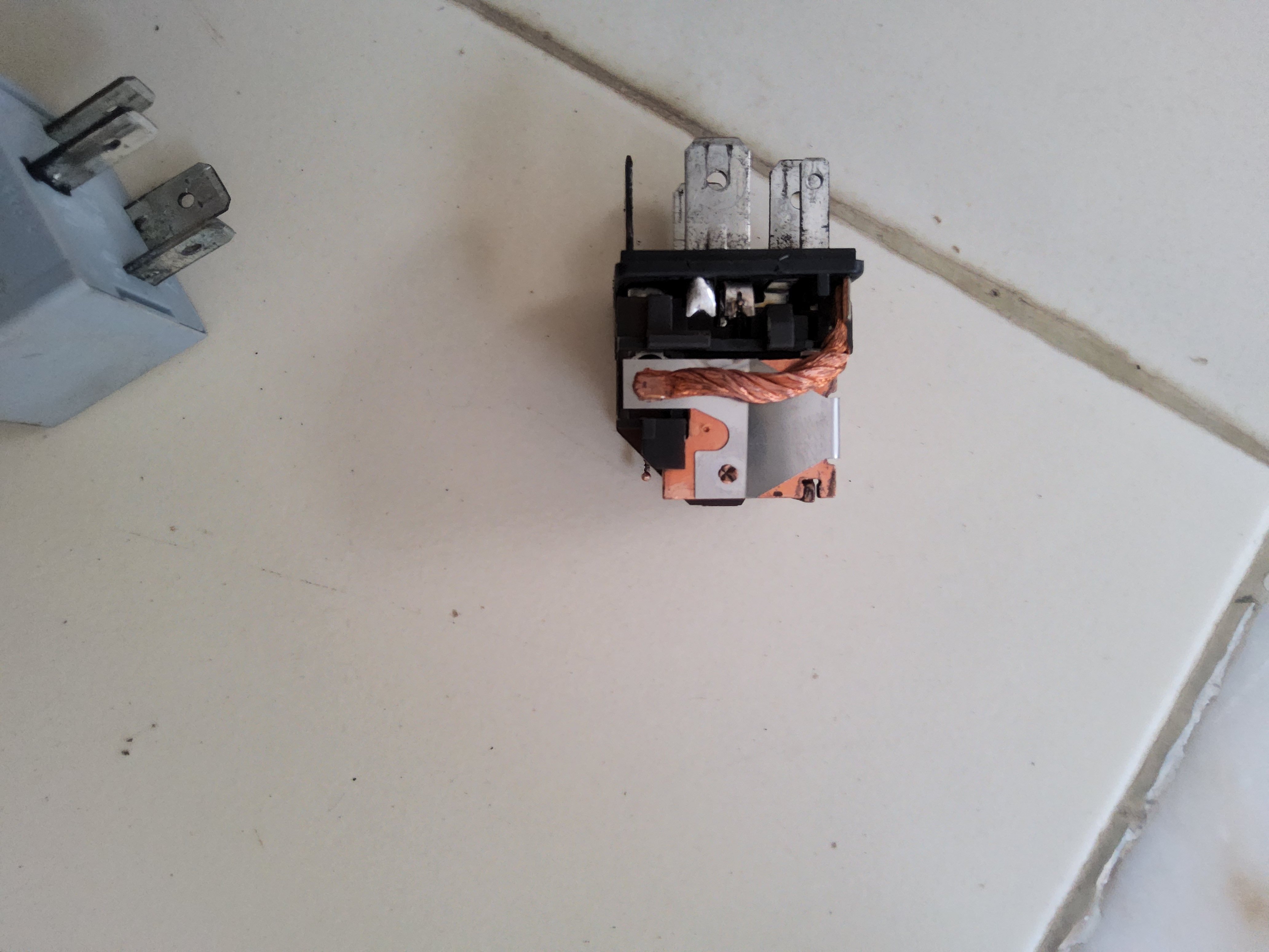

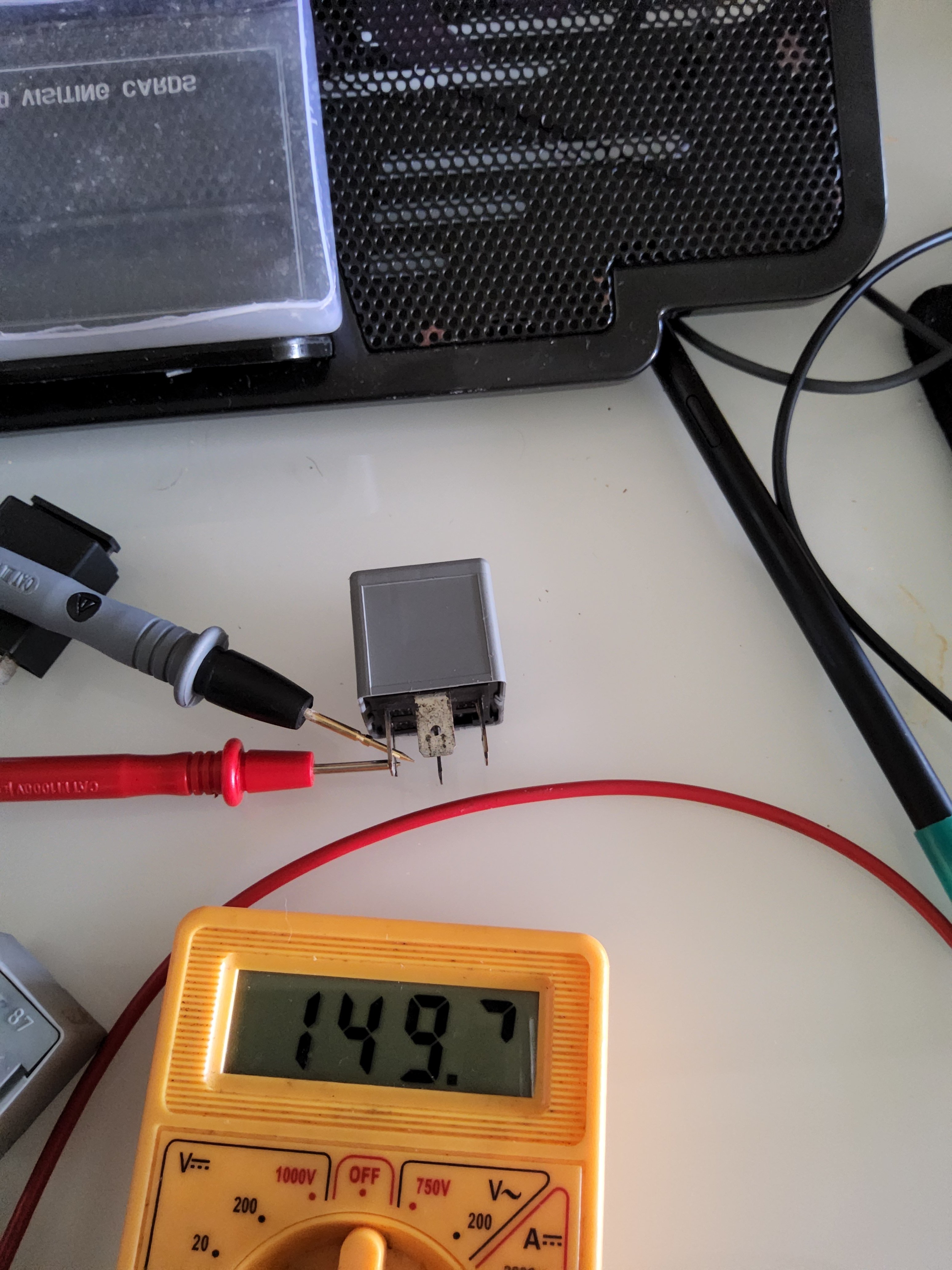

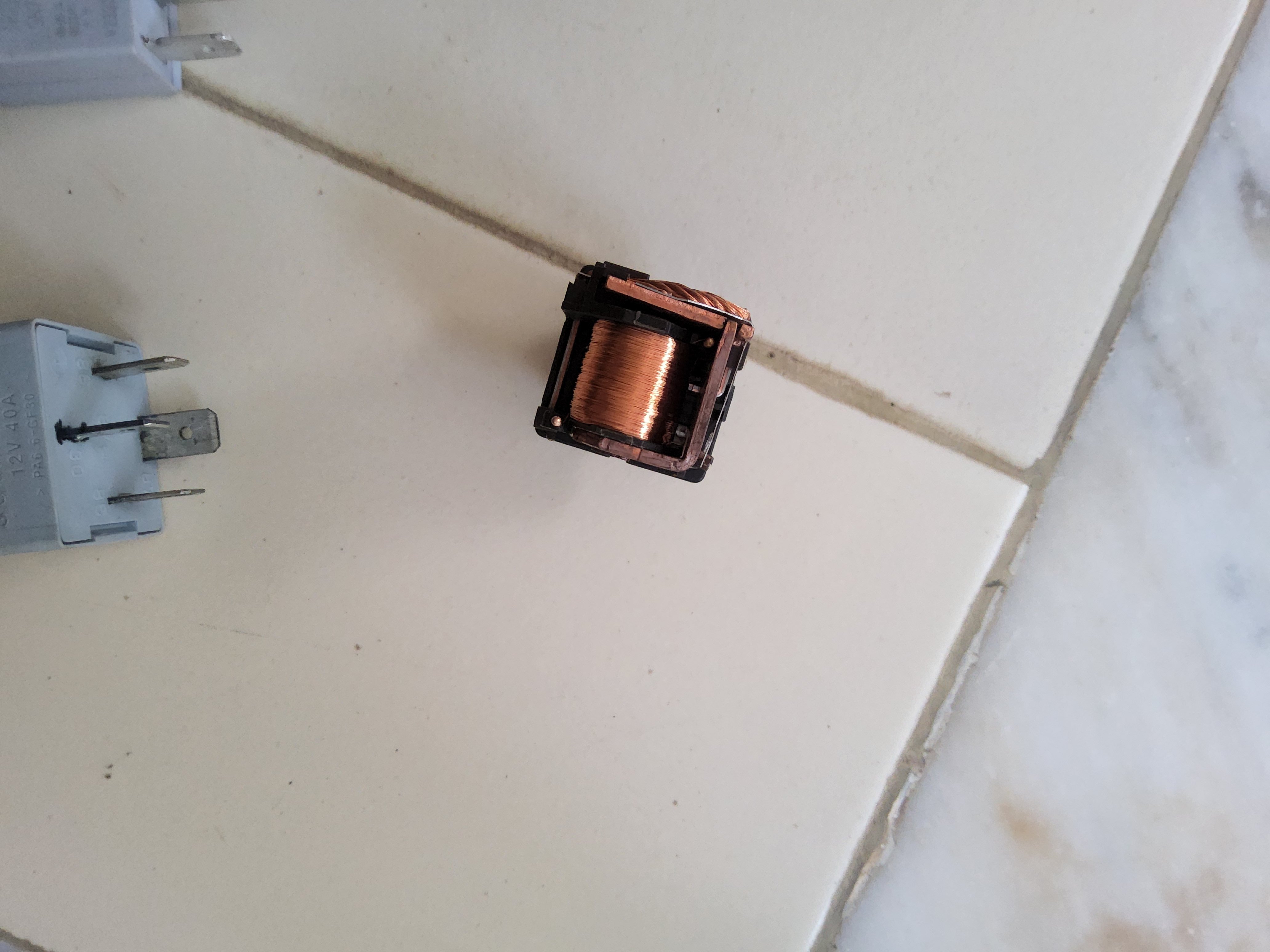

The relays are out. Resistance us there in-between 85 86 pin but no clicks when I power 30 and 87
  • Sponsor
30 is permanent power in, 87 is power out to load, 85 and 86 are the coil which needs to get 12V across it before you will hear any clicks.
85 is low end of coil, 86 high end (but might be the other way round, see specific circuit). Google is your friend.

No clicking of relay when powered. Getting resistance though.
85 is low end of coil, 86 high end. Google is your friend.
True. And that is where I am getting stuck. 85 86 should throw up resistance in 50 _150 range and I'm getting about 70 in some and in relay no 429 getting 740. Will try and power up and hear the clicks. So far nothing.

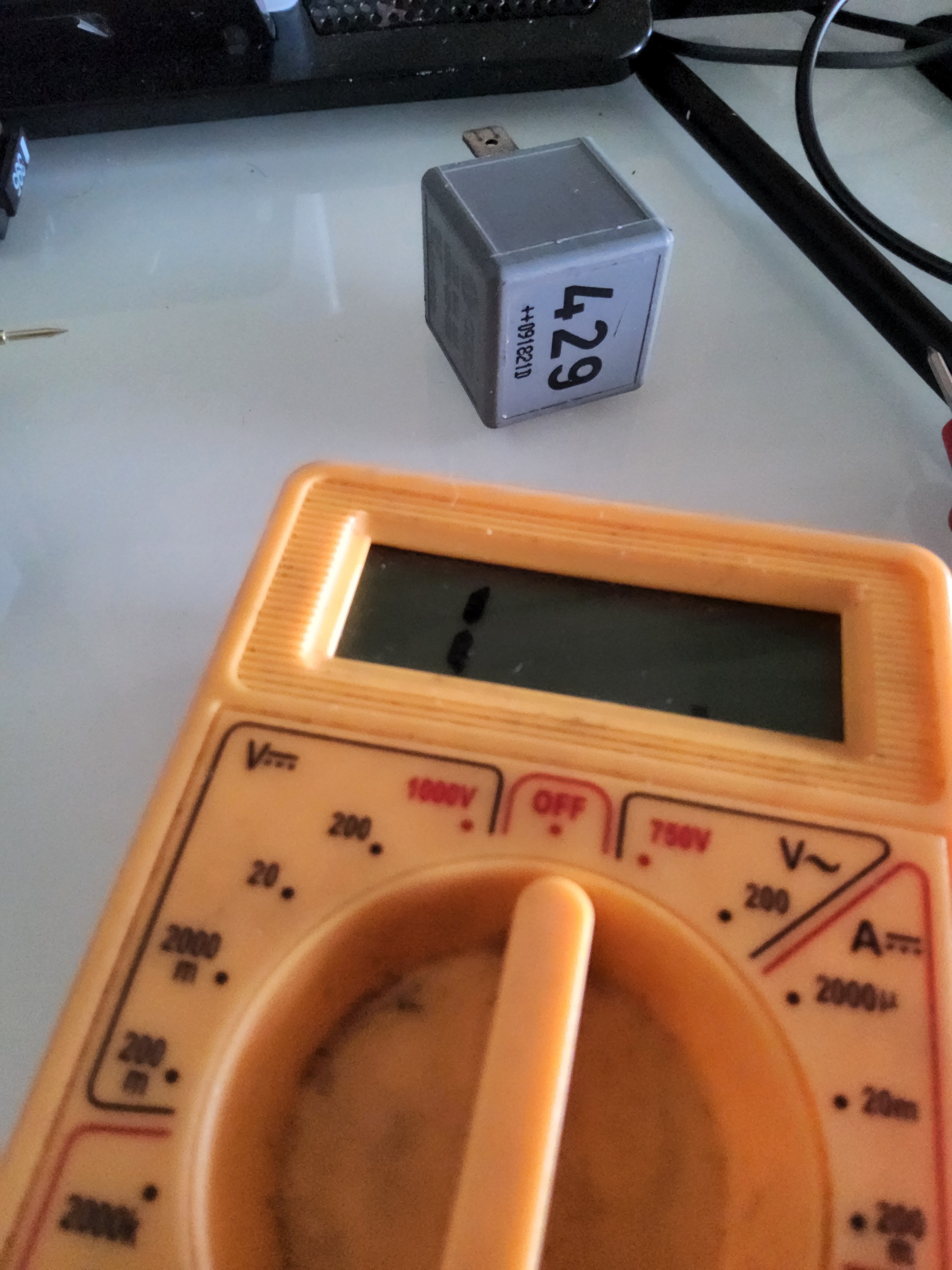

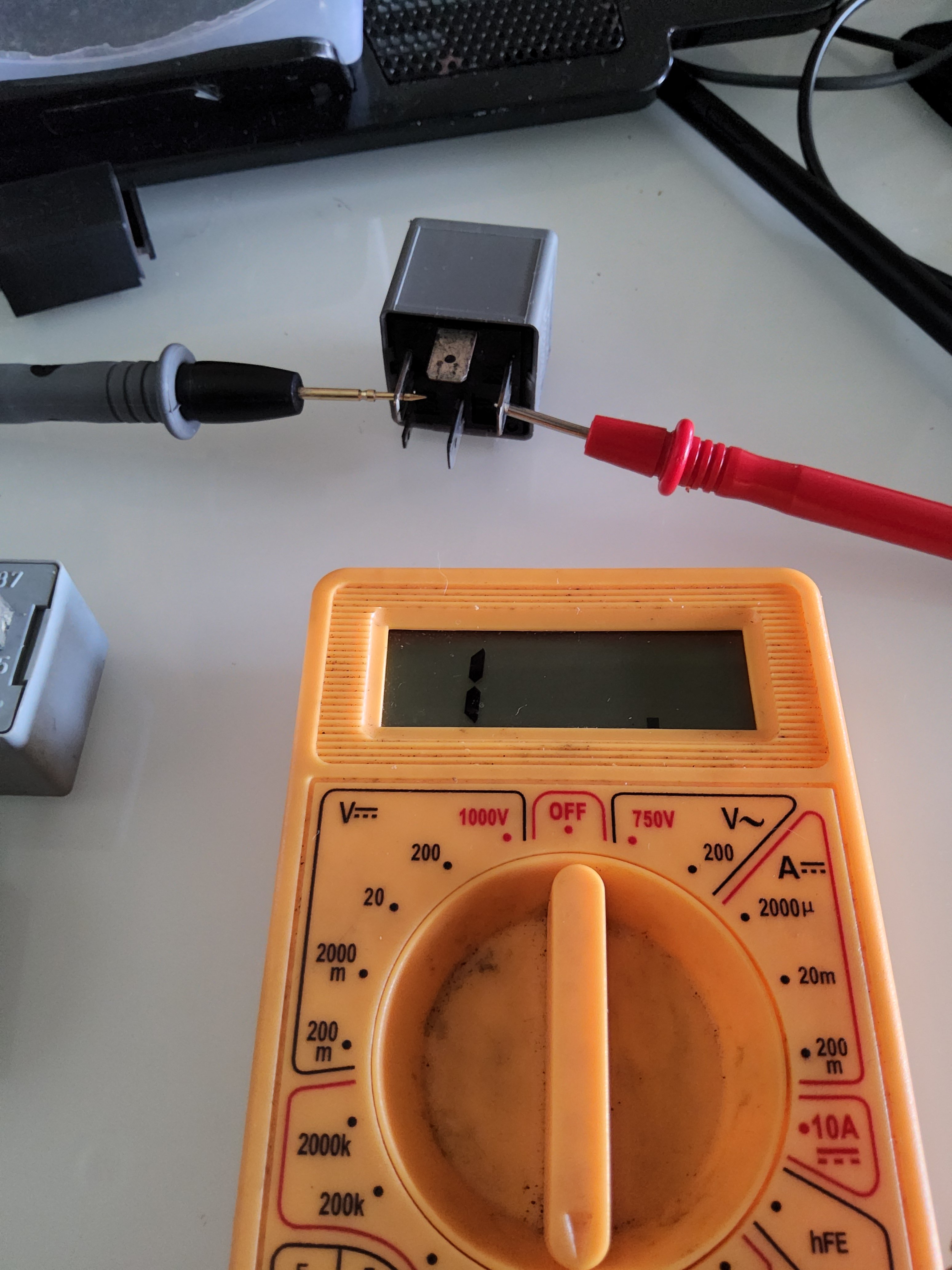

Relay no 429 isn't giving a resistance reading between 85 and 86 however, between 86 and 86a I get a reading.
Any idea what 429 relay does
  • Sponsor
The only way to know 100% what these relays do is to know the VIN and the position it is/was fitted in the relay panel.
Edited by Breezy_Pete
  • Sponsor

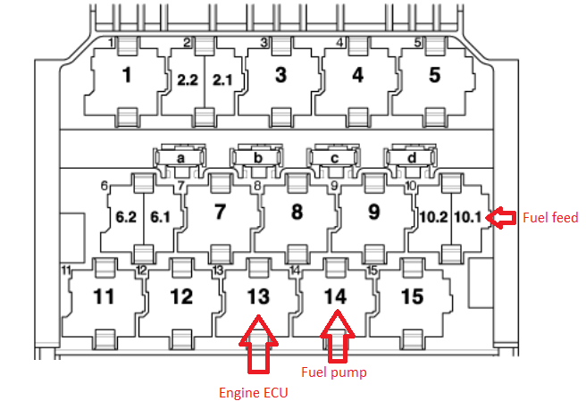

These three are the main ones to focus on.
I think the one you have with an 86a terminal is probably the engine ECU relay from position 13, which has a diode between terminal 86 and the coil but not from 86a to coil, explaining your measurements.
Fuel pump relay, which is the one that may not be OK, is in position 14.
Fuel feed relay in position 10.1 is the one that provides a short run of the fuel pump when the driver's door is opened, after the car has been unopened for half an hour or more.

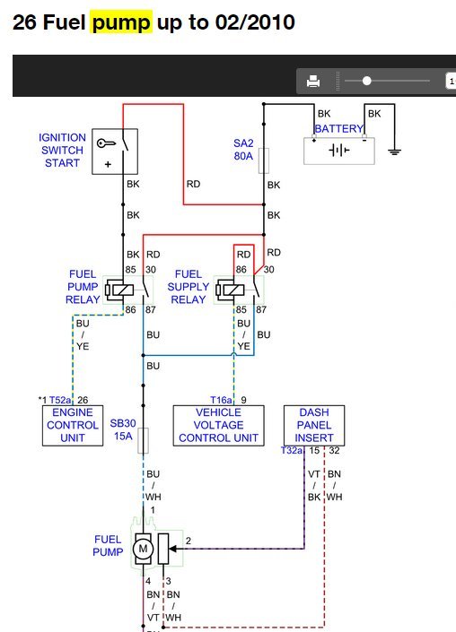

The circuit relating to fuel pump and the two relays involved is exactly as in @Jocko's post a few pages (and months) back. So fuse 30 is the correct one.  Actually a much clearer presentation of the involved circuit than the manufacturer's own diagrams. Is that from Autodata?
Do you get fuel pump activation when you open the driver's door for the first time?  If you do, that would confirm that the wiring to the pump from the fuse is OK.

You will just have to work with Jocko's diagram, checking continuity of wires between the various points, especially fuse 30 terminal to fuel pump terminal (the blue/white wire path).
Take out the fuse, use meter on resistance range to measure from pin of blue/white wire at pump connector, to each side of fuse. One side of the fuse position should show zero Ohms to there.
You may need an assistant and possibly an extended meter wire.
The brown/violet wire at the fuel pump connector should go to chassis/earth.

This is the diagram I need to follow. Putting it in the thread for ease of reference.
