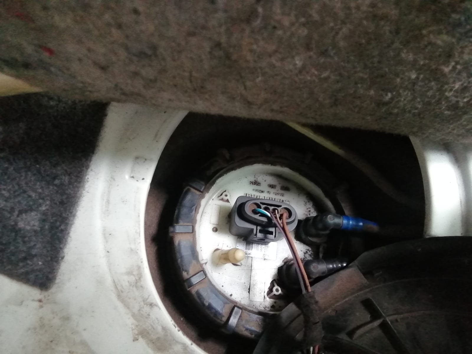

So finally we have a dry spell in Bombay. Opened up the fuel pump connector and checked for voltage. The connector has the hook in the middle and you will need a pin to push it to open. Struggled for some time and then used the tool I had to open trims to open it. Image attached.
The pump was covered in thin layer of dust. Used a brush to clean and then the spilled petrol to wipe.
Fuel pump pin 1 and 4 I gave a reading of 4 volts. Did not have any help to crank the engine and check voltage at the same time. Are the reading different in crank and in on position?
The resistance in the pump male pins was 1.0, does that mean the pump is ok?
There was absolutely no sound of priming by the pump when I opened the fuel lid to hear
I have poured in about 4 litres of petrol, you think I should pour out more to reach a level for pump to prime?
The fuel lines both black and blue had very little petrol in them. In fact the overall spillage was less than 10ml
The engine bay fuel line too had just a wet patch, there was no spillage. The return line (blue was dry). I could smell petrol but nothing was trickling out.
Cleaned the fuel pump top, pipes and installed them back.

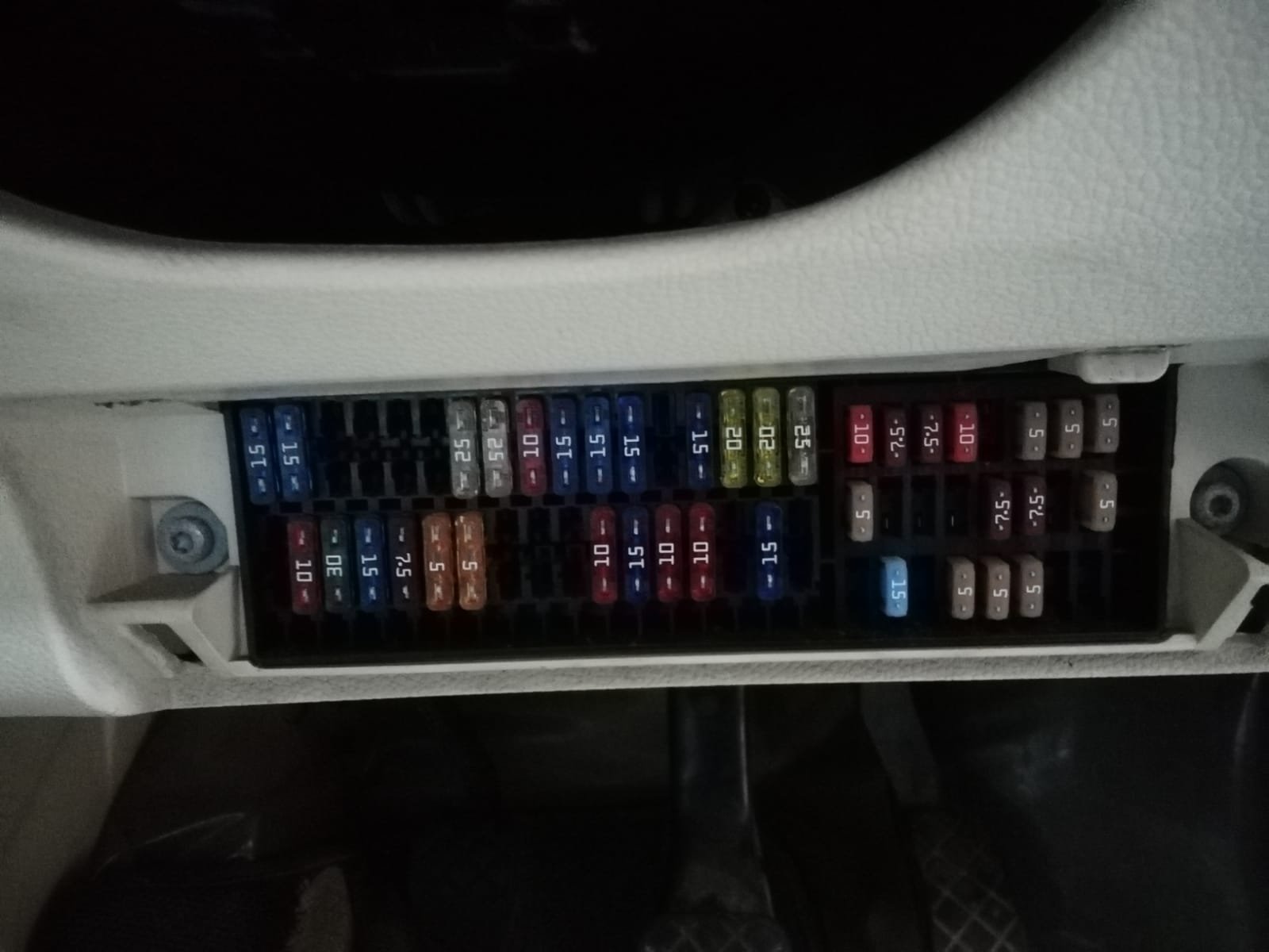

Now the confusing part. I had a fuse diagram which indicated fuse no.20 to be fuel pump however, that slot is empty in my car. I am confused, how can I get a voltage reading with no fuse in place. Please help with the correct fuel pump fuse number. If possible please share an image for reference.
It is turning out to be a long post. Thank you all for the support and hopefully the mystery of fuel supply will get sorted soon. Just hoping not having to to open the pump before all these issues are sorted.

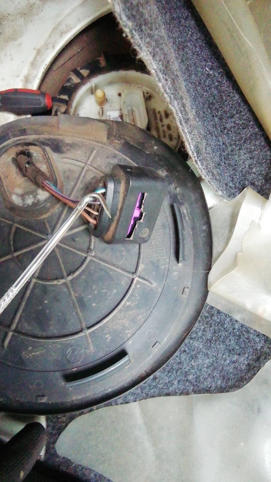

This tool was used to open the connector. The clip engages in the middle and the helped move it easy. Pressing the tab wasn't releasing the clip.

According to my manual, the fuse for the fuel pump up to February 2010 is SB30. It is a 15A fuse. SB20 is for models after that date. Looking at your photo would suggest it is the 15A fuse, at the bottom, between the 10A fuses.
With the ignition on you should get 12V across the pump, cranking or not.

Noted. SB 30 is present, it is 15A fuse and looks ok. I am not getting 12V. What could be cause for this? Perhaps because of low voltage the pump isn't starting. Any leads to chase on this issue?

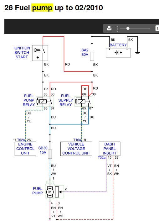

Voltage should be between Blu/Wht and Brown/Violet. If no 12V, check between Blu/Wht and an earth point on the bodywork.

Sorry, I am disabled and not physically able to do what you ask. However, I can confirm that you should have 12v on the pump when the ignition is on as this diagram shows.

Oh, I was not aware of it. The voltage should be 12V which it isn't currently. Will trace back the points as per this diagram and try and locate the issue. Thanks
