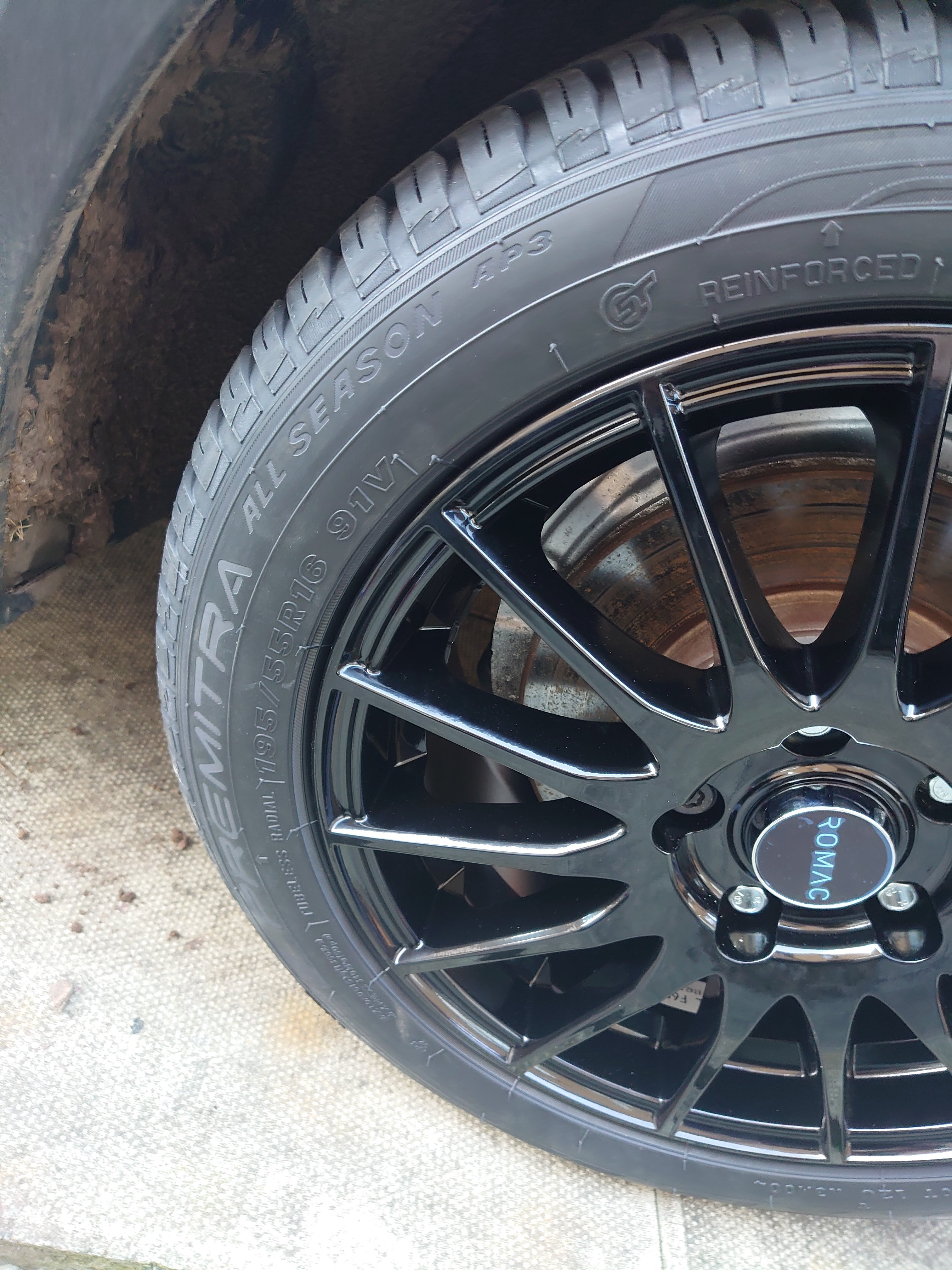

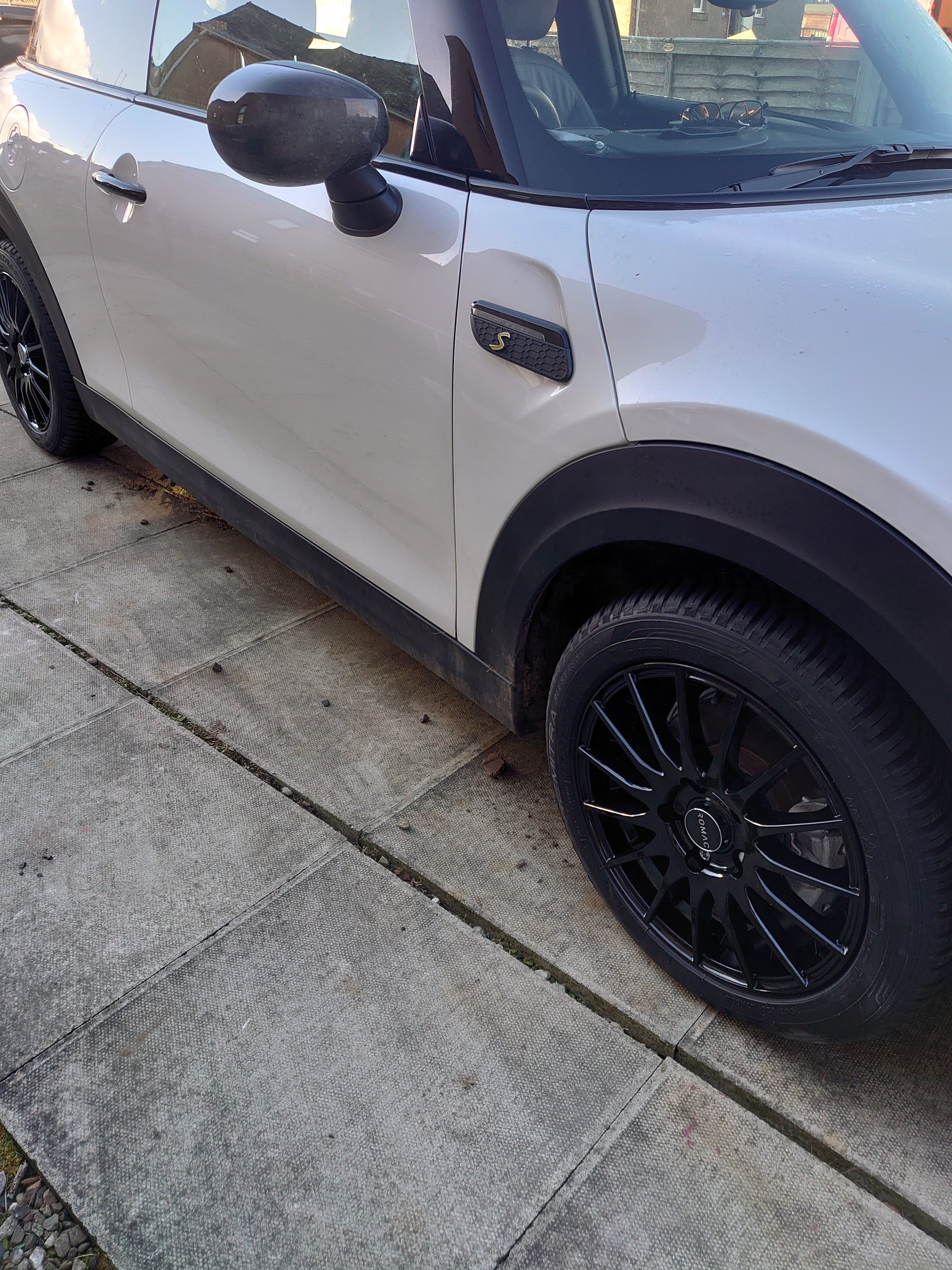

My Mini Cooper S Electric came on 205/45 R 17 Goodyear Eagle F1 Supersport.
Ridiculous tyres for use on a wet road, and for a cold wet road total ditchfinders.

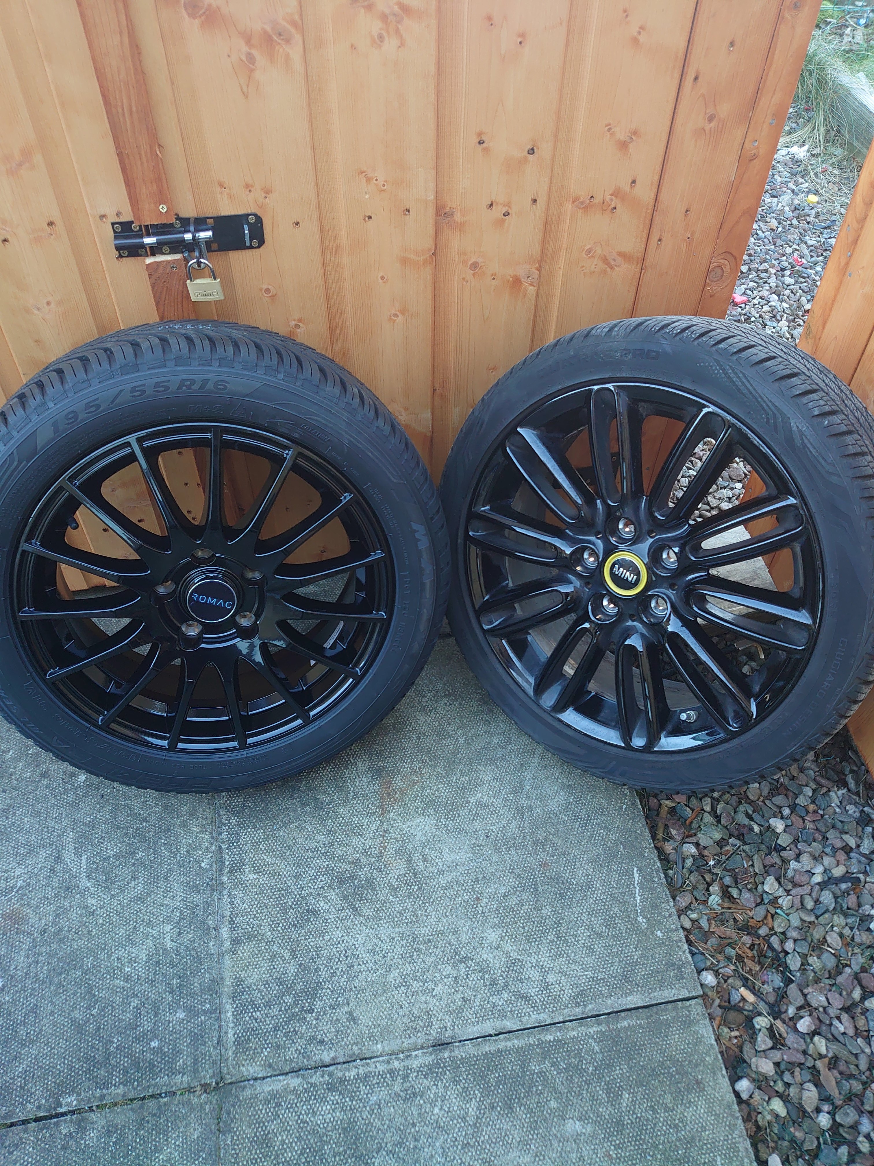

The thing is there is theory then practice and practical.
So now on 195,s and 16".
Simply because there is location location location and the state of the roads driven.
The New more powerful MINI,s from China (GWM,s)  are on 225/18" tyres. (1,600 kG kerb weight)
& wheel spinning on the ECO bias tyres and the Media Spin is the Wheel spin is there to give back the driving experience.
The usual guff really.  It is too much torque through front wheel drive tyres with crap tyres for the job, wide and sticky can be OK when dry or dry and warm, wide with All Season Treads can be, but narrower and with the tread and compound can work perfectly.
205 / 17's All Seasons & now 195 / 16'S All Seasons.
