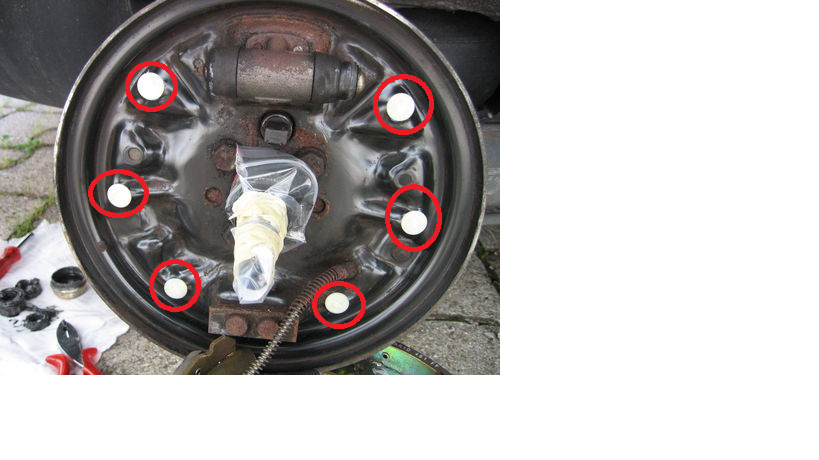

Because the wheel speed sensor pokes into the drum through the backplate, to point at the inner face of wheel bearing.
  • Sponsor
The rectangle just below the wheel cylinder in this image. (Ignore the red-ringed bits, they were illustrating the 'glide pieces' which the shoes rest against.)
ah!  I did not see this as I never removed the bearing, makes sense though.
