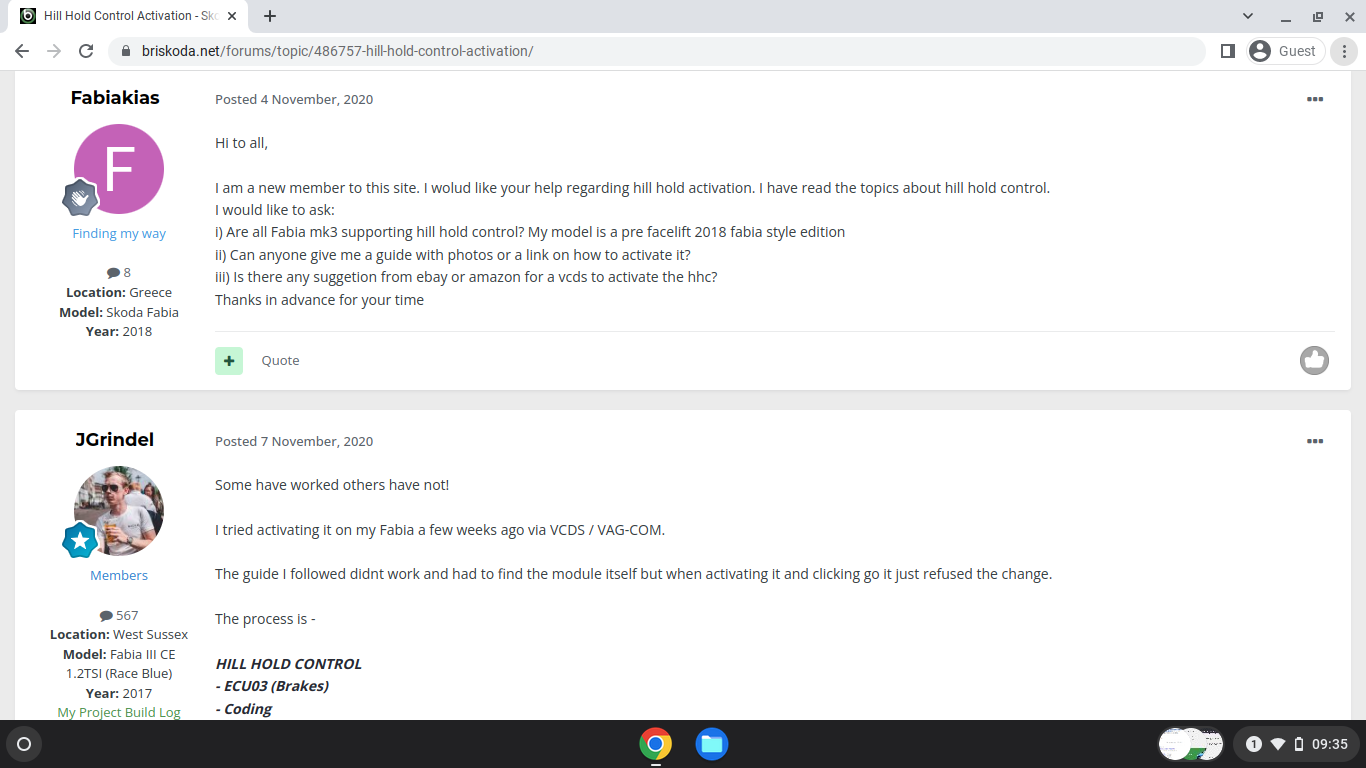

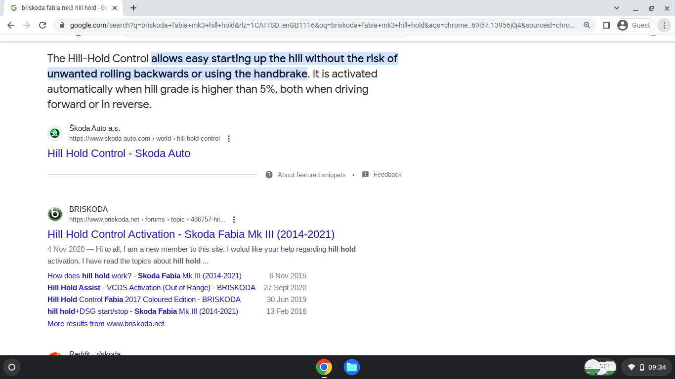

If not activated / working now then there are threads to check out.

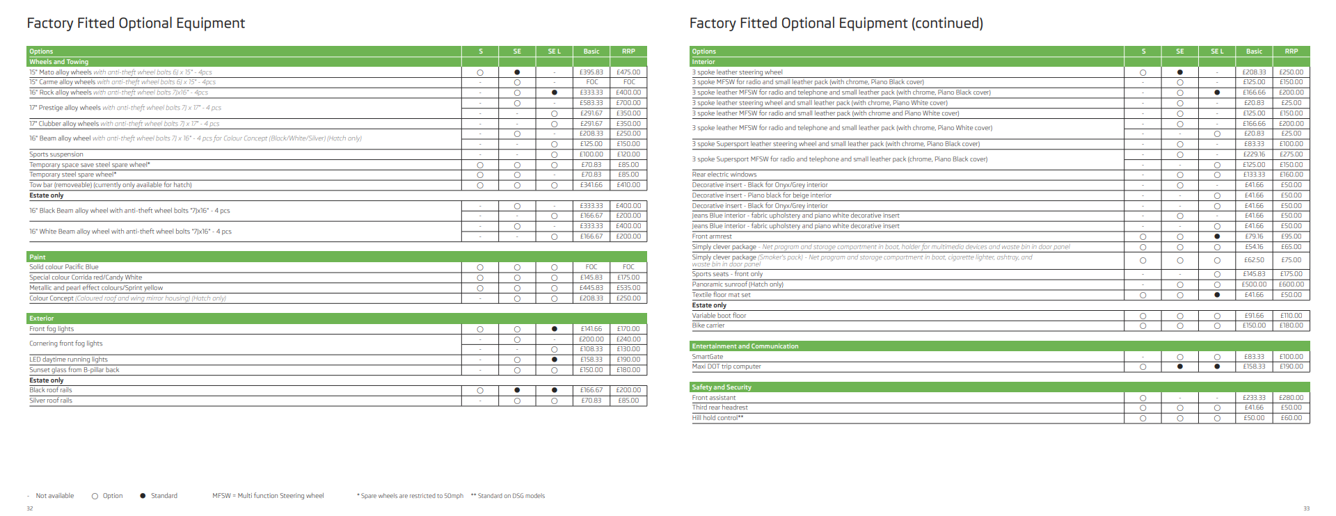

From the Fabia 2015 brochure.  All DSG have Hill Hold as standard (Bottom right option, two astrix bottom for DSG)
We've had four Fabia's from 2011 to 2017. Hill hold has always been standard on the DSG.

I have conducted some tests and our Fabia does have Hill Hold and it works correctly in Reverse and Drive. The slope of my drive is too shallow to activate it - hence it runs back if the accelerator is not pressed. as the dry clutch requires accelerator input to engage the clutches. All working as expected and this driver will now learn to drive it correctly. Thanks to @logiclee for the explanation in the KAroq forum.
