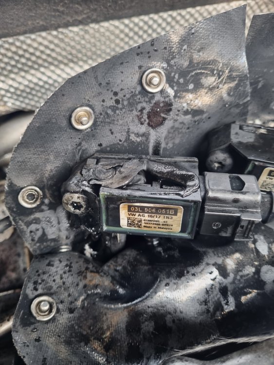

Hi I have a 2017 Superb Diesel LK and I had a cam belt change at a dealer about a month ago.
2 weeks later I get a engine light on the dash and after using OBD11 it pointed me to the DPF particle filter pressure sensor.
Semi melted mess as you can see in the picture.
If I changed this sensor do I need to do anything else? I can't see a setting in OBD11>Engine>Basic Settings>Adaptation of diff pressure sensor particulate.....
Others have seen this but after some research I conclude one of the following is true
1. My car is 2017 and therefore the above doesn't apply
2. I need to fit the new sensor first then perhaps the item shows up on the app
TIA. I don't really want to take it to a dealer as its a simple part to change but will if I have to.
You can just buy the new sensor, make sure it has the same part number, and try it.
After a few 'drive cycles'  you might find the fault clears itself, but you can clear the DTC with your reader anyway.
I didn't have any problem after that, done 10k miles since.
By the looks of it your plug/wiring have survived. You can try disconnecting the plug first to make sure, and give the connector pins a spray with contact cleaner to be sure

Hi
I cleared the fault easily with OBD11 and curiously it hasn't come back despite the state of the sensor.
My concern is more about the ECU losing track of the DPF status if I just go ahead and swap sensor. Some say that not only does it need adaptation but if you don't do this before you start your car you have to buy a new sensor.
I'm hoping none of that applies but need to be sure before I attempt a DIY sensor change.
£70 for the part from ECP but it'll probably be double that at Skoda, fitted.

I'm not one to claim to be an expert, I can only tell you my actions and how it was successful
The DPF values with a faulty sensor are now invalid, and the next time it tries to regen it will declare a fault. The sensor is still working or you would have had an error saying the signal is implausible, so it's just reading low pressure. If you replace the sensor it will start to read valid outputs from the sensors again, and could restore the previous values. I certainly don't see why it would lose all values, as if by deleting them, just because of a short period of unusual values.
I did a forced regen but I don;t think it was really necessary, and it will take a few drive cycles and at least one attempted regen before it will realign it's status.
Either way a new signal is better than what you currently have so I don't see what's to lose by changing the sensor anyway, and if it doesn't work you'll need to do the other processes anyway all the same
I'd start with a £16 sensor off ebay. As I did that already and it already worked
