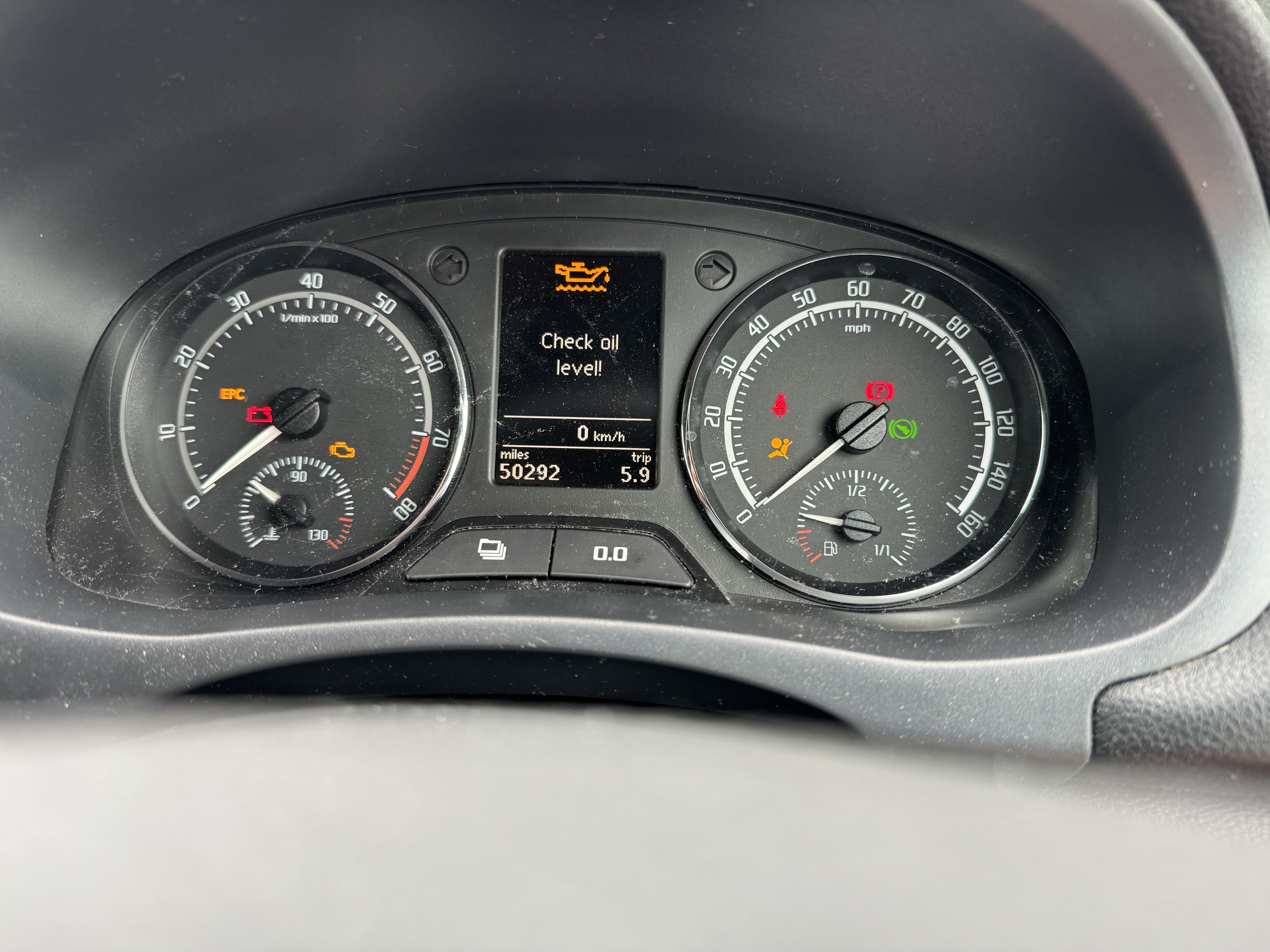

Check oil level!
This message came up yesterday so I checked the oil and it was low.. I put in about 600ml of oil and the dipstick was showing on the higher side of it. Ever since it’s kept giving me this message upon start up (no dash light) just centre screen. It disappears after about 2 minutes of driving but I don’t want to see this every time I get in my car.. do I have to have it read and cleared or is this something I can do DIY?
Thanks
Jack

Thank you for the quick reply! I have opened the bonnet and it’s still there but it does disappear after a couple minutes driving 😟 pesky car 😅
A couple of minutes is fine.

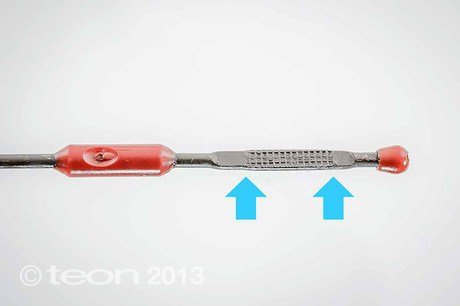

Dip it when stone cold, and again after the oil has got to 90*oC and you have parked for a few minutes.
post-86161-0-06277400-1446204589.jpg.2fe088b95ed948e128d768fd0b3bdb41.jpg.460fcd1b70f85e344c1d4eea4dc4911c.jpg

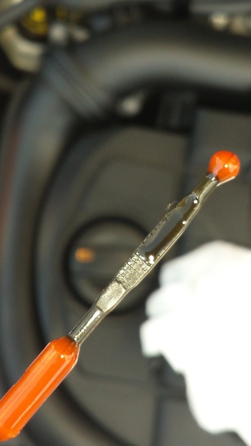

It’s the 1.4 twin charge, I checked it both times and it was at the top.. could I of put too much in there or not enough? I’m going to take a steady 20minuet drive shortly so I will check when I get there then check when I get back to the car.. it does disappear after a few minuets but you probably know it’s irritating seeing it pop up 😅
Where was the oil when you stopped to put oil in?
It can be at the orange ball before a warning on some twinchargers.
I always run with 3.9 litres in from an oil and filter change.
That was cold dip oil at the top of the crosshatch and on the flat part, below the top orange bit.

So if when the engine and oil is hot and parked and flat and engine off a few minutes (4-5 mins)  the oil should be just above the cross hatch, or at the top of it.

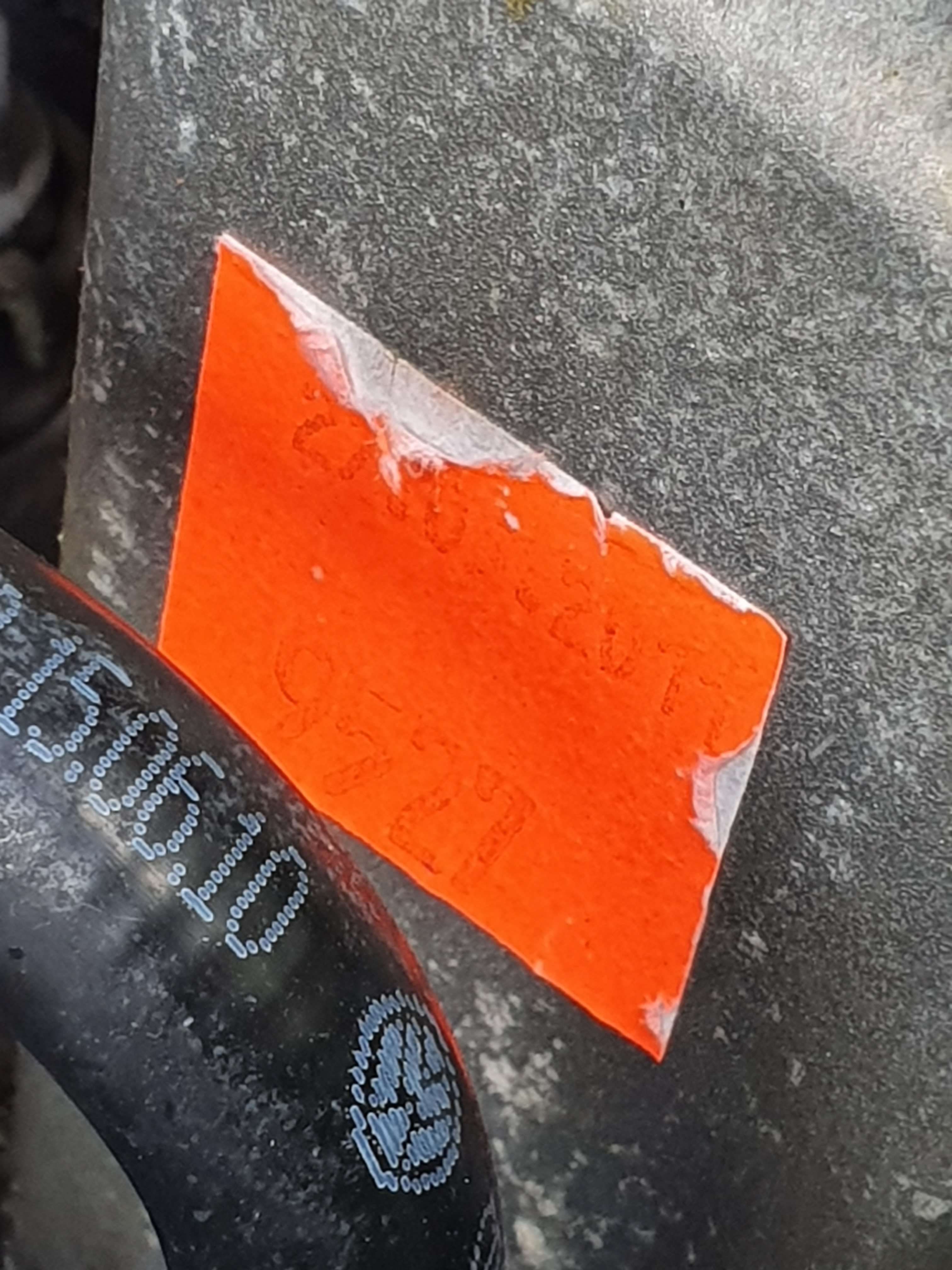

What is it, a 2010-12 CAVE, or 2012-2014 CTHE?
How would I know? Sorry for the dumb question 😅
Just seen some invoices in the car and it’s a CAVE395720
They stopped fitting the CAVE engines late summer 2012.
Then it is CTHE engines fitted.

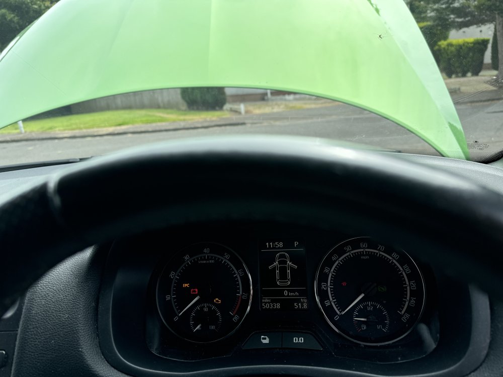

15599270944498809506439597364809.jpg.643cfe77878ff17ea71bba869fb9cfd7.jpg.97a7941bd9d2e0644145ff829a6918b4.jpg
Edited by Ootohere

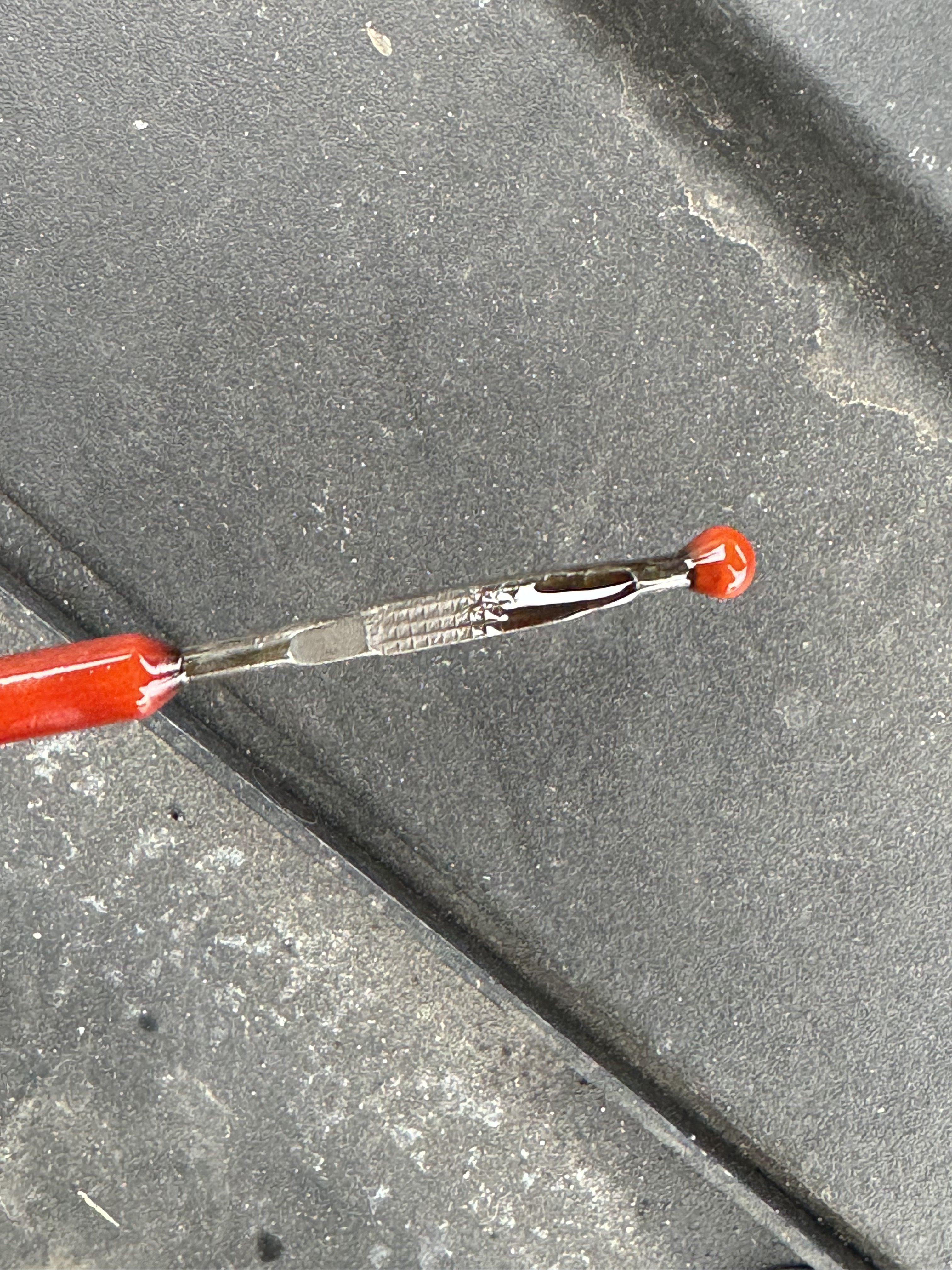

This was after a 20 minute drive, oil temp was 92 degrees. Left for 5 minutes. I am going to do an oil and filter change on payday so I know she’s fresh, I used 5w30LL from what was used in its last service so I didn’t cross contaminate the oil 😊
Edited by Jackhodge998
Too low.
Get it to the top of the cross hatch when topping up cold.

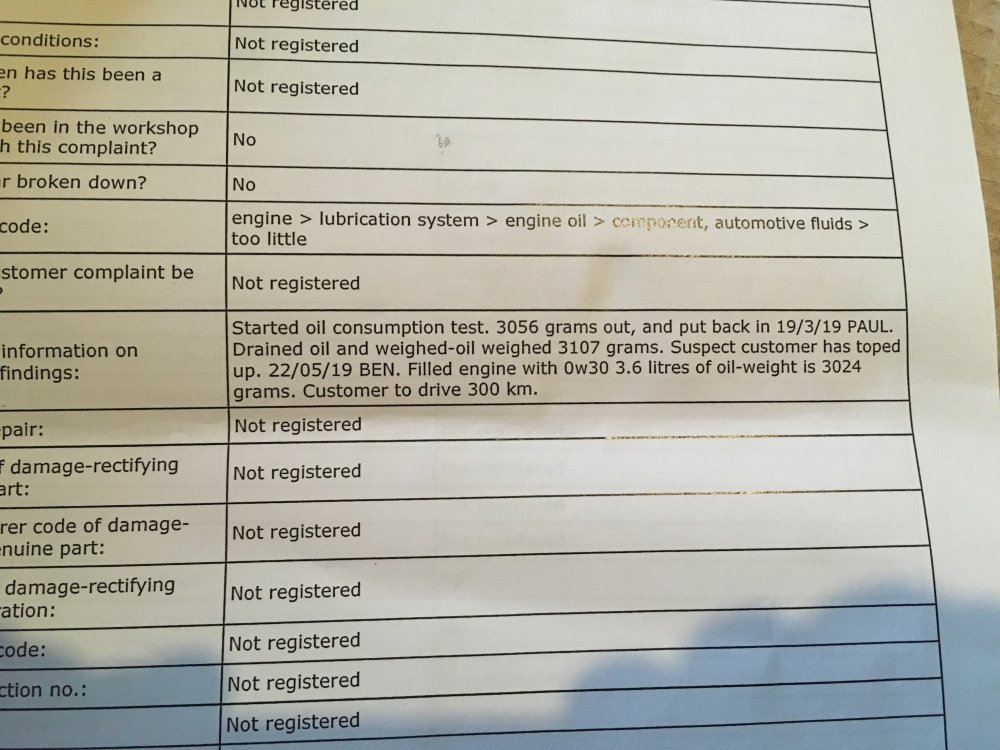

The engine oil volume from 15*oC or so to 92*oC is very little changed.
As we know from previous tests with Twin Chargers and official Oil Tests and weighing and measuring in a container and heating.

The official quantity of 3.6 litres is not much which is why some use 3.9 or 4 litres.
