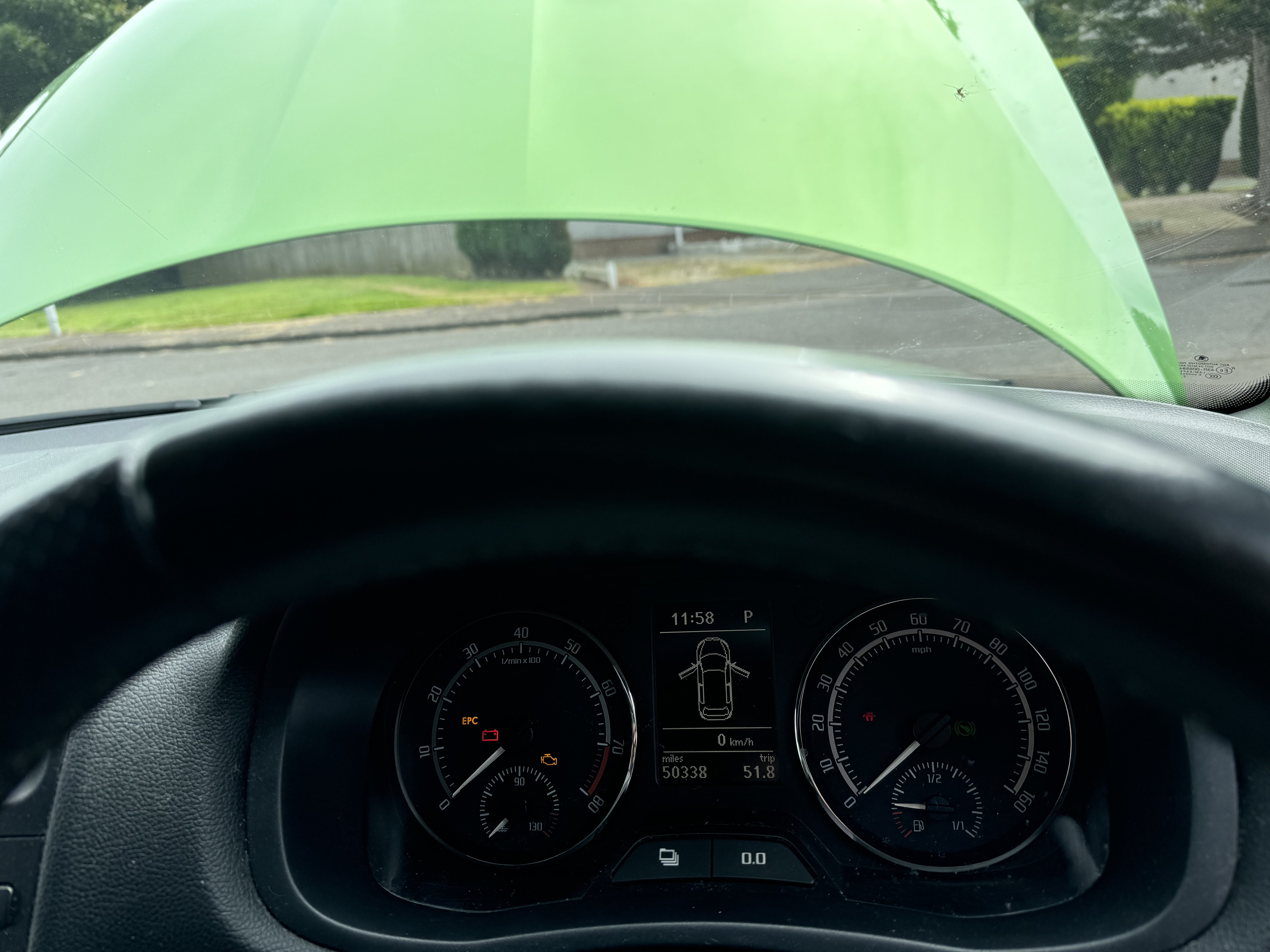

Yeah the can comes up whilst driving and on start up when ignition is on, I'm glad it come on but I've sorted it and its still there lol

Would it show on the dash if the bonnet is open?it does with the boot and every other door
I'm reading/interpreting what you wrote as " on the dash each door and hatch opened show on up - but when the bonnet is opened it does not show up", if that is the case, then sort out the micro switch and/or lead before looking elsewhere would be my plan.
Edit:- in other words, the car's systems need to know that the bonnet has been opened before it will revisit and clear the low oil level warning, logically, if the bonnet has not been opened then the oil level can not have changed, if that makes sense.

Mk2 Fabia vRS do not have 'Bonnet open' warnings on the dash.  So if there is nothing showing as Bonnet open that is why.
As to opening the bonnet.
Yes the car needs to know the bonnet is open, to reset the Low Oil warning.
Elephant in the room is, even when you do not touch the oil, not add any, the warning stays off for 100 km.
Not Simply Clever, actually bl00dy stupid.

Yup, that would have been an easy fix, but you could always try unplugging the lead to the bonnet micro switch and stuff a paper clip across it, I'm guessing that if its open circuit that equates to "bonnet open" and if it is short circuit that equates to "bonnet closed" - but that is purely a guess as doing that would  make it fail safe for cars that show an open bonnet - like most/all later cars.
If that worked, then the "Low oil level"| light would get reset until you let it run low again.
My logic was, the previous owner kept an eye on the oil level as maybe he knew it "liked" a bit of oil added frequently, and so even if the bonnet micro switch was faulty, it would never have caused any issues, you then bought this car and basically didn't quite keep on top of checking the essential fluids and the "Low oil level" warning appeared - and if the bonnet switch was faulty that warning would never get cleared just by adding in oil.
Edit:- even leaving out stuffing a paper clip into the removed lead as I'd think that open circuit for a few minutes would be enough to reset the low oil level warning - if that bonnet switch was in deed faulty.

Tried finding the switch online but can only find a latch, I’ve had the car 3 days and it was my own fault for not checking the dipstick yes 😒🤦 not my proudest moment I must admit! Could have happened a few months down the line but hey. I’ll have another look online at if there’s a switch and go from there.. if that fails then I’ll just do the sensor along with an oil and filter change

I checked my own car this morning and when I unlatched the bonnet, even with the ignition off, the bonnet open warning shows up (the bonnet turns white on the graphic).

Aye it’s not registering the bonnet being open. I’ll give it a spray with wd40 and see if it releases before I go buy another latch ☺️
Bridged the bonnet switch and it’s not registering the bonnet being open.. next step is fuses but I can’t find diddly on where that would be on a fabia.. there’s one for an Octavia but not a fabia 😟
