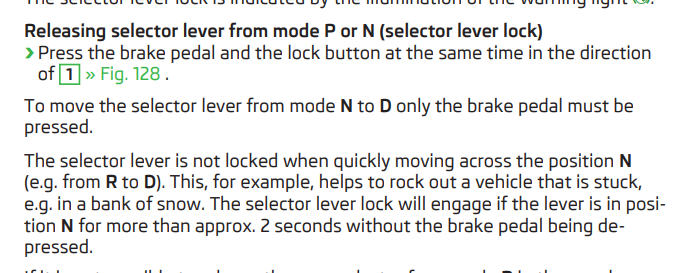

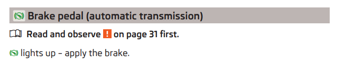

It's purely an indication to tell you the DSG gearbox selector is locked and you need to put your foot on the brake to be able to move the lever into D etc.
Edited by logiclee
