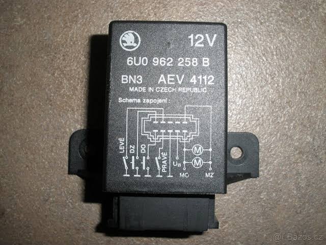

  • It's right on the central locking unit: DO means remote unlock (Dálkové Odemknutí), DZ means remote lock (Dálkové zamknutí). The functions are activated by connecting them to the groun

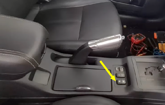

Another example:
I find it useful and ''cool looking". :emo:
you have the same thing
Has you Felicia a central lock-unlock button in the console or dashboard? :blink:

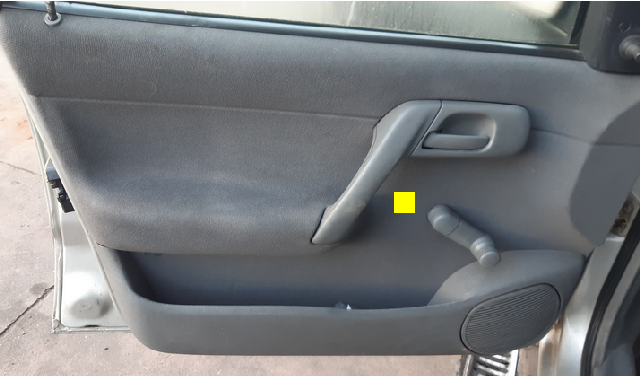

on the door you pull the thingy

Here are two examples from other cars, not mine: if i don't manage to put it in the (side) dashboard
i will put it close to the door handle.
The functions are activated by connecting them to the ground. You need either two push switches or a 3 position switch, similar to window switches.

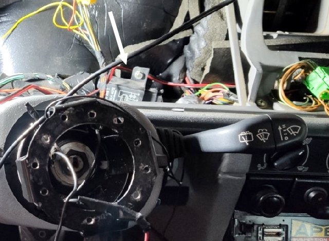

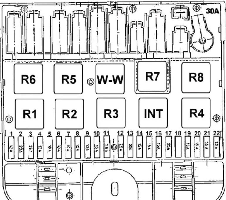

@Papez it's the same relay that
someone sells it as Wiper
https://www.ebay.ca/itm/292272842913
and someone as central lock?
https://www.ebay.com/itm/256251159561
Goes where the INT position is?

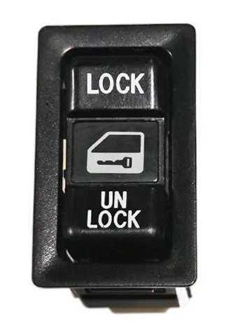

2 separate switches colud fit better here, 1 common ground and 2 commands lock-unlock.

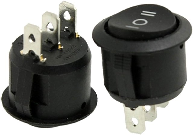

I have a switch like this, 3 position, can do the job?
634d074171249a543b67d333-2x-3-position-onoffon-round-rocker.jpg.2a8aaca78553d2efdf1ef0265ce44f3d.jpg
No, it's on the firewall, behind the instrument coaster.
It must return into center position. There are switches for that purpose, with right diagrams, it'd be best to use those.
Sorry I thought all this was aftermarket parts I had no idea the Škoda stuff was still available (or already in the car).

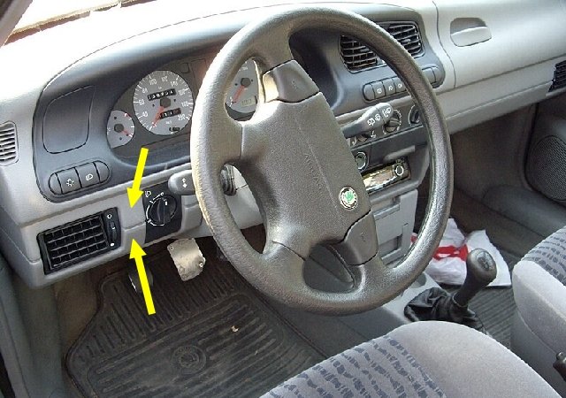

Oh, so i must remove the instrument panel?
is this one pointed by the white arrow?
Correct. You can see part of the wiring diagram.

An alternative would be manipulation with the switch inside the servo. According to the diagram, closing of the switch will send "lock" signal, opening will send "unlock" signal. So you'll need one push button in parallel to bridge the switch for "lock", and one in series to disconnect it for "unlock".
