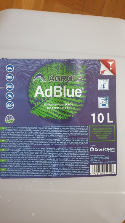

who knows ..ut this is the picture of what I ordered

AdBlue is Adblue regardless of the Producer. It is Trade Mark.  Licensed. ISO 2241.
So as long as nobody sells Snide products it does not mater who produces it.
