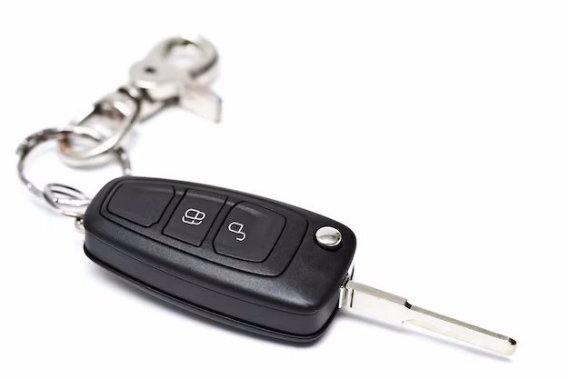

1) I have an old type key with a separate alarm remote control with only 2 buttons something like this:
and I want to make it foldable with a control together like this one here:
new-car-key-with-lock-unlock-buttons_101709-1812.jpg.b4ae4eb20c9fe17c0968f3cfed100b15.jpg

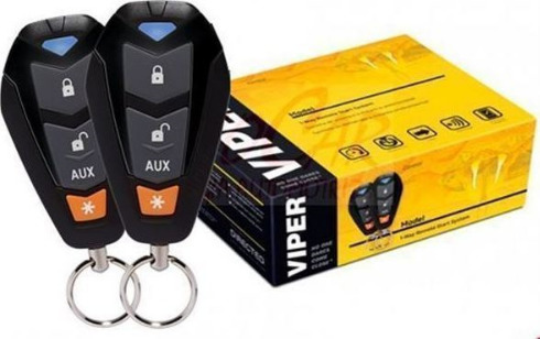

I put another brand (better alarm) for example a Viper
can that controller easily be "copied" to the (aftermarket) folding one?
2) For sure don't have a button for the trunk, to raise the trunk is a matter of the construction of the car or the ability of the alarm?
I have seen brands with they remote control with this capability
https://d.scdn.gr/images/sku_images/022199/22199607/20180913162517_ad8bd3d1.jpeg
Can that kind of alarm work alongside with my car?

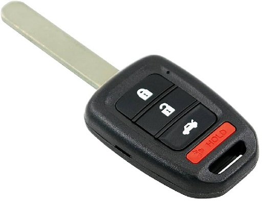

Also i have seen folding ones with 3+1 buttons like this one here:
Can i have (with a different alarm system) a key like this for my Felicia?

  • Don't forget you would need to buy new blank immobilizer chips to put in the new folding key, and then have them copied/coded from old keys.
  • I don't want to take the risk, i will go to a local Locksmith for this task Example: https://keystation.co.uk/car-keys-parts/conversion-cases?srsltid=AfmBOoq4lWz6O1gNd-G5dEag0CsHSdvuaBTlgA-T9g5Sw
  • You can mount an electric motor to actuate the lock to operate it with the remote. Or add a mechanism to unlock the truck with the rest of the car (which Is what I did since Skoda decided to use the s

Yes, I'm in the process of doing this (although I've been doing this on and off for 2 years and still not finished it)
The only thing is that I've used a cheap Chinese system, very similar to this one https://www.ebay.co.uk/itm/150967239571
Also a warning that these cheap "HAA" key blades will eventually snap, so will need changing for better quality blades.
Generally the alarm system has a learning mode to learn the signal from new/additional keys/key fobs (but again that is the Chinese types) It
depends if this "better type" of alarm system allows this or not.
Just thinking, if you have the instructions for your current system, you may be able to have it learn the signal from new key fobs.

I don't know those aftermarket folder keys are durable as the stock?
I there any possibility to crack after few months of use?
Edited by D.FYLAKTOS
The Chinese ones are rubbish.
Yes, they will eventually snap, it happened to me.
Better quality ones are available, and can be swapped over.

Personally I think what you had in the very first photo of this thread is the best compromise but I am biased as I don't like remote locking fobs, I like keyblades only, in mechanical locks.
With my wife's previous car the folding blade of the remote fob broke and my wife insisted on a replacement and on the 2015 Fabia the remote fob just stopped operating and using the "emergency" keyblade in the hidden door lock set off the car's alarm, replacements were expensive and required further installation work or procedure that had to be paid for.  I could have got the part and work done for a lot less on the Fabia but as I have seen even good quality professional have a rare problem with getting the VW computer programs to accept the new parts I wasn't risking it as if there was a rare event and much more expensive parts and work were required it would be on VWŠkoda to resolve, I have limited faith in computer programs, particularly from car manufacturers, bad enough in other products.
To me It is just adding complications to possible go wrong.  Even a mate's Honda S2000, one of the most reliable cars going the (UK added) alarm went wrong after about 13 years, that was the only thing to play up on the car until about 18 years of age when a hazard switch had to be replaced.
