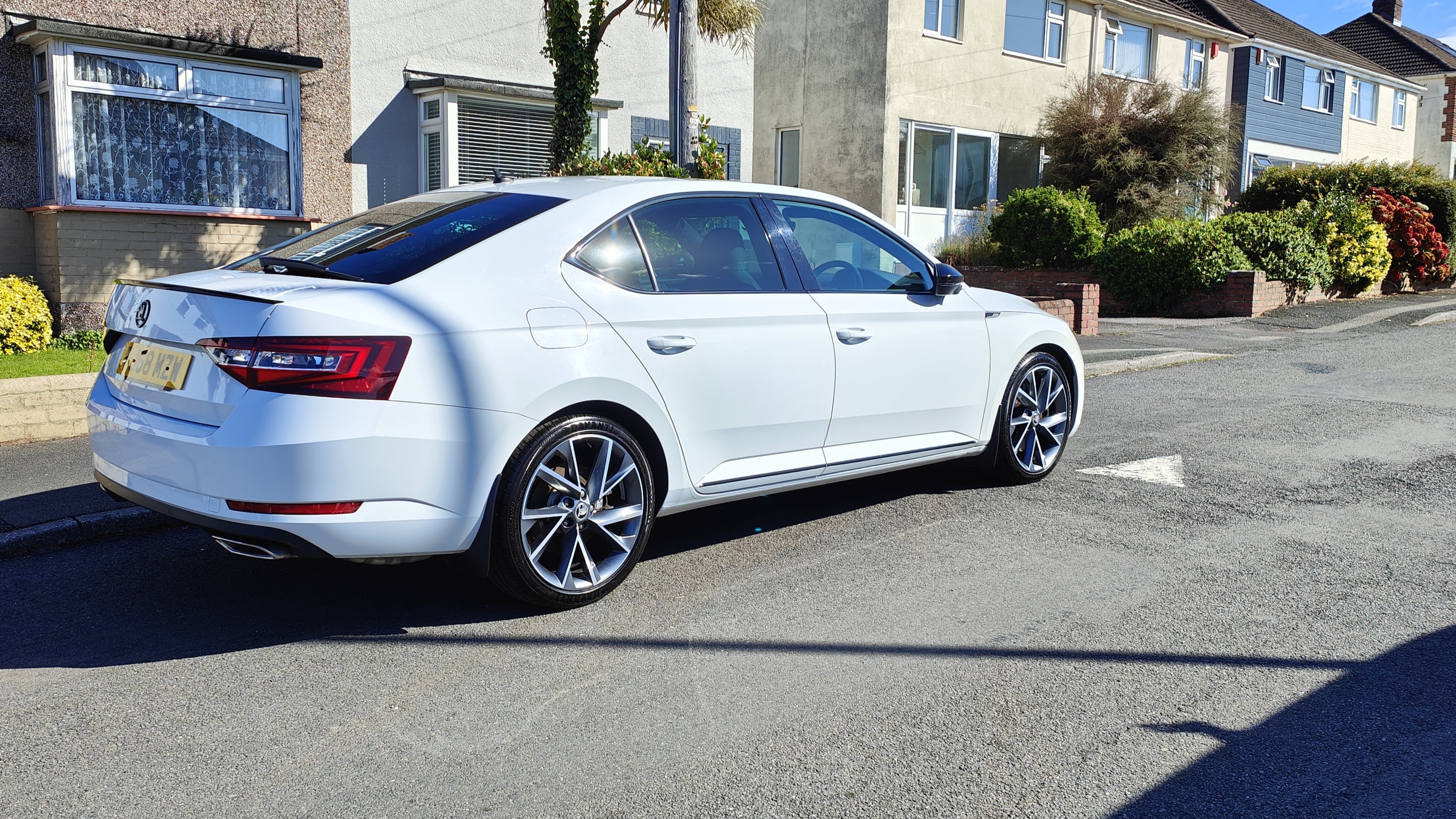

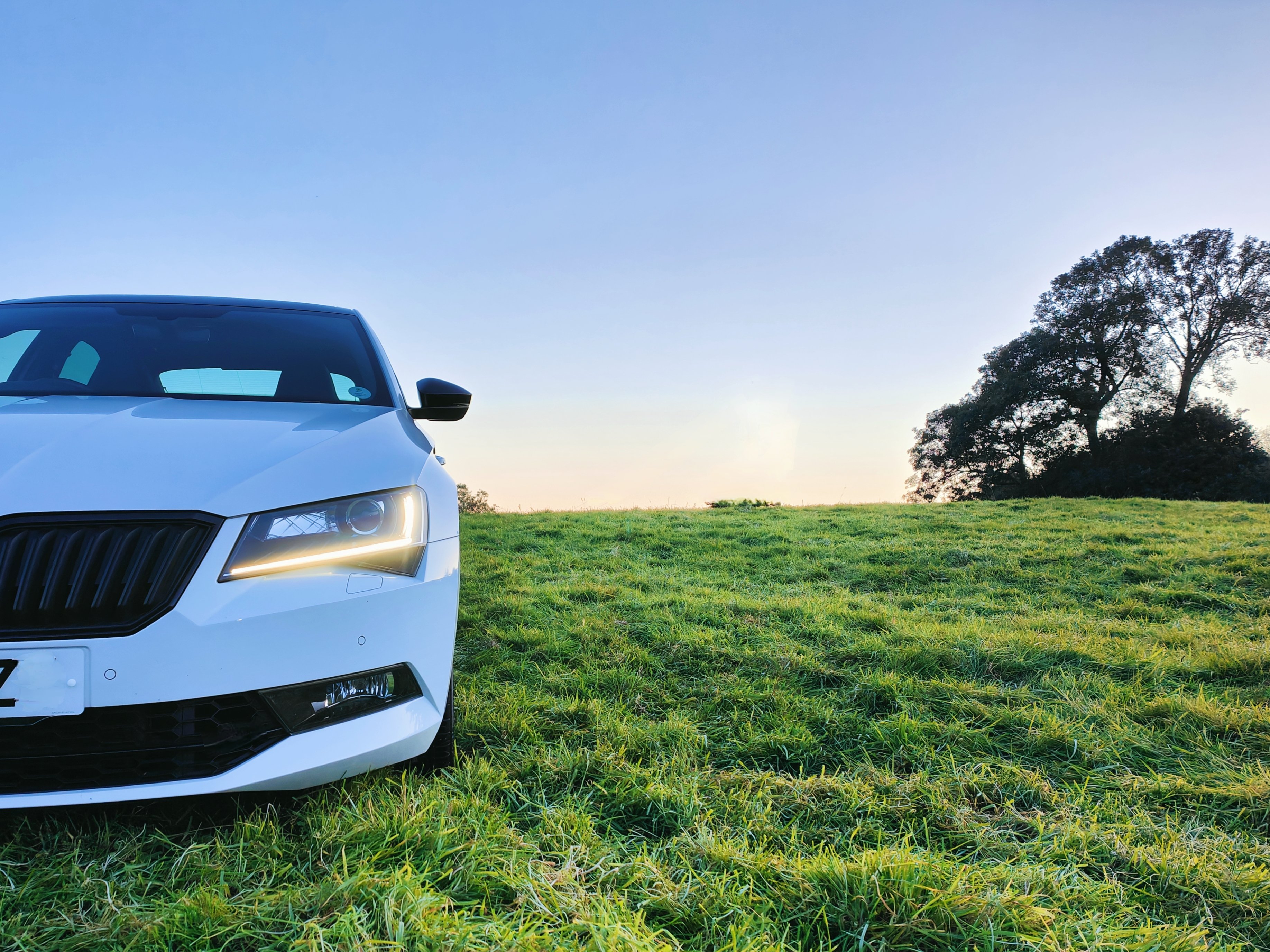

On the day of delivery, bit dirty from the journey (approximately 3.5 hour journey, delivered to me)

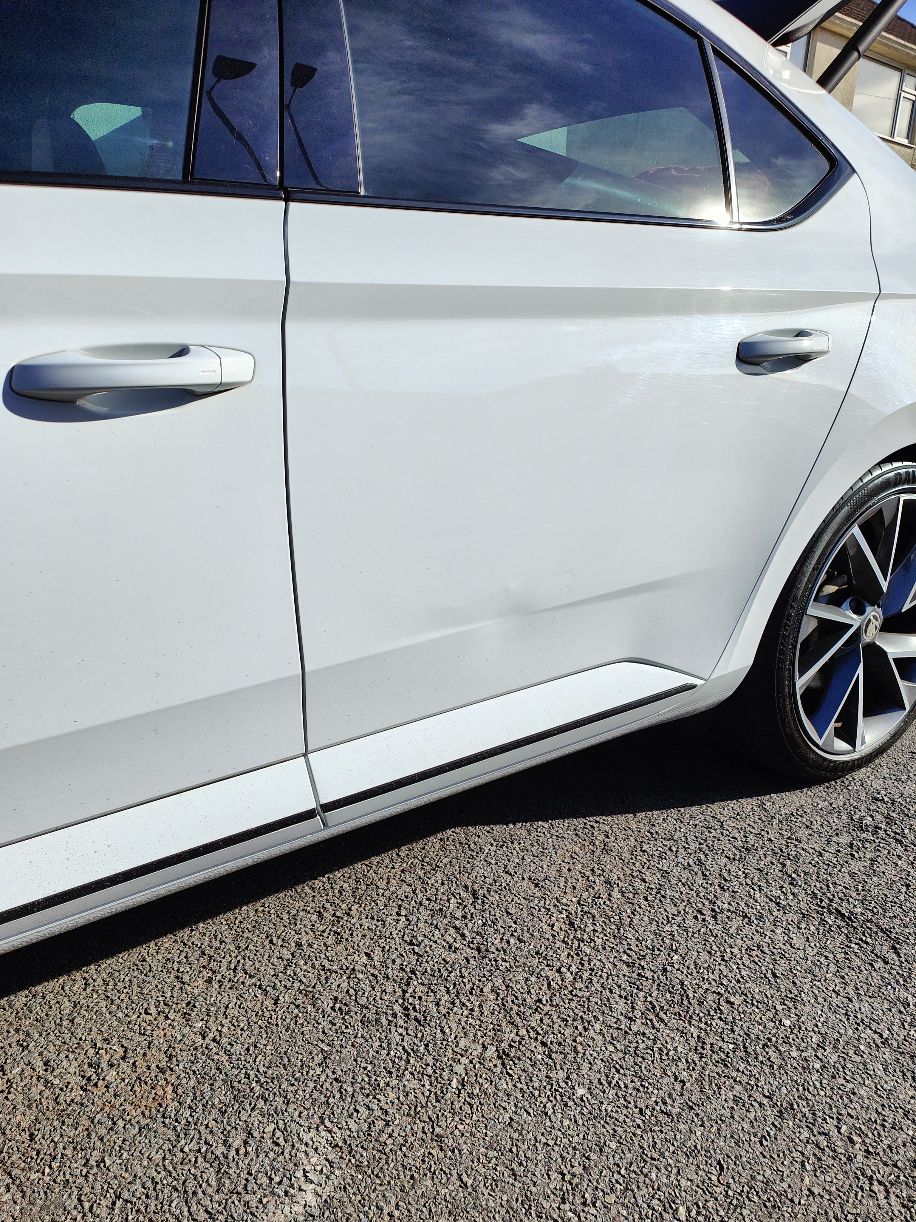

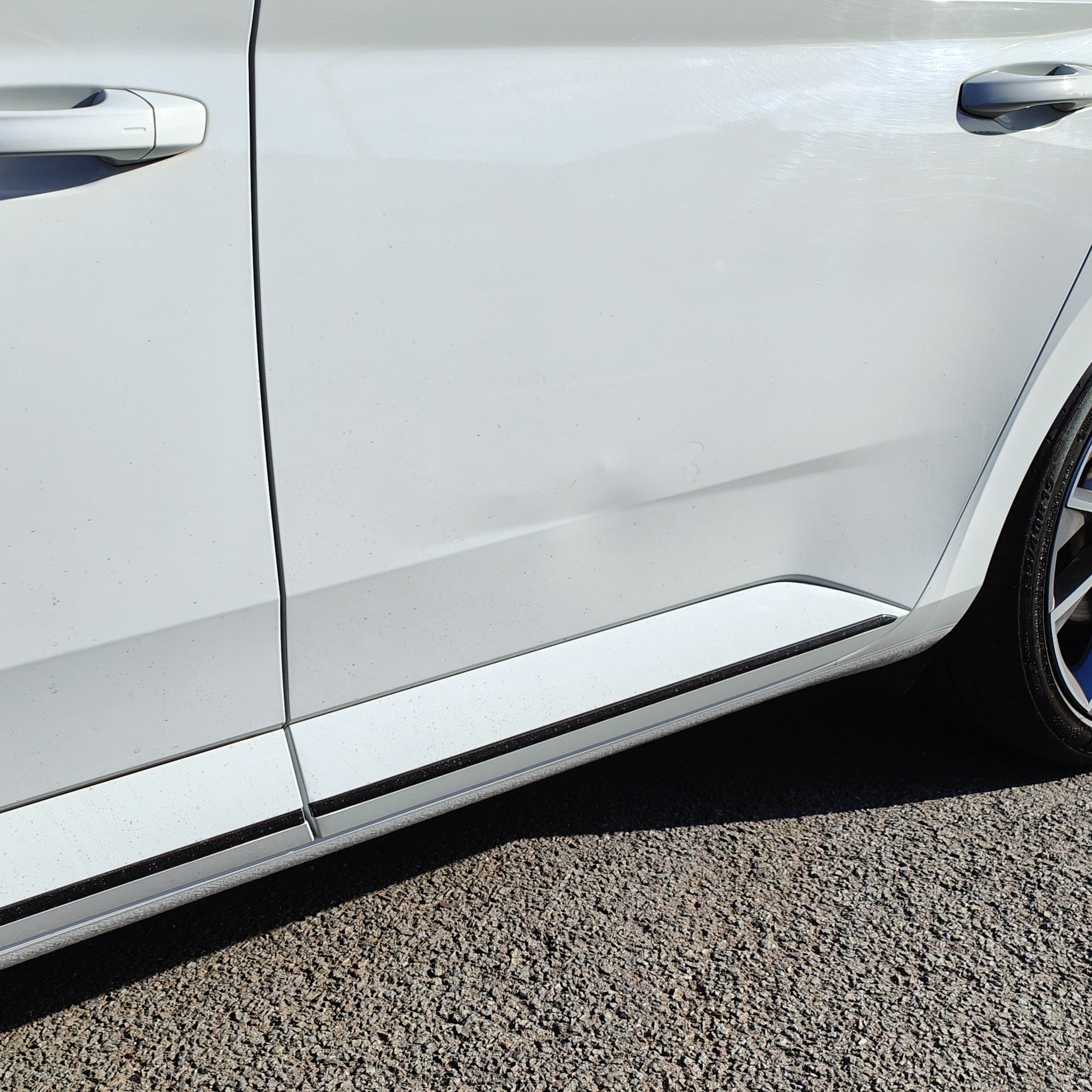

Quickly found out it had a dent in the rear passenger door which wasnt obvious in the photos/video they sent 😞
A phone call to Station Garage and they have told me to get some quotes for paintless dent removal. Its not a guarantee but its positive that they will do the right thing.

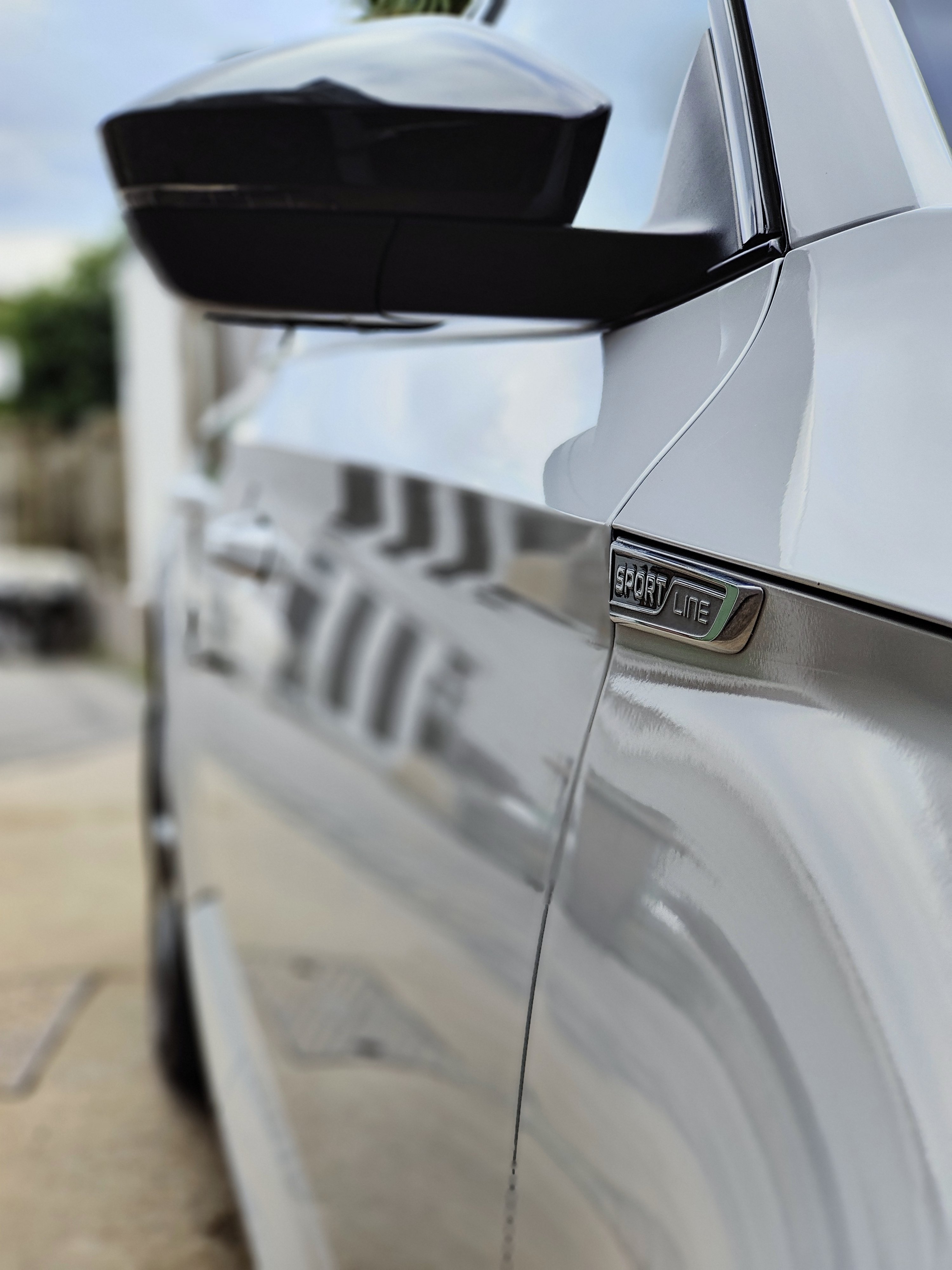

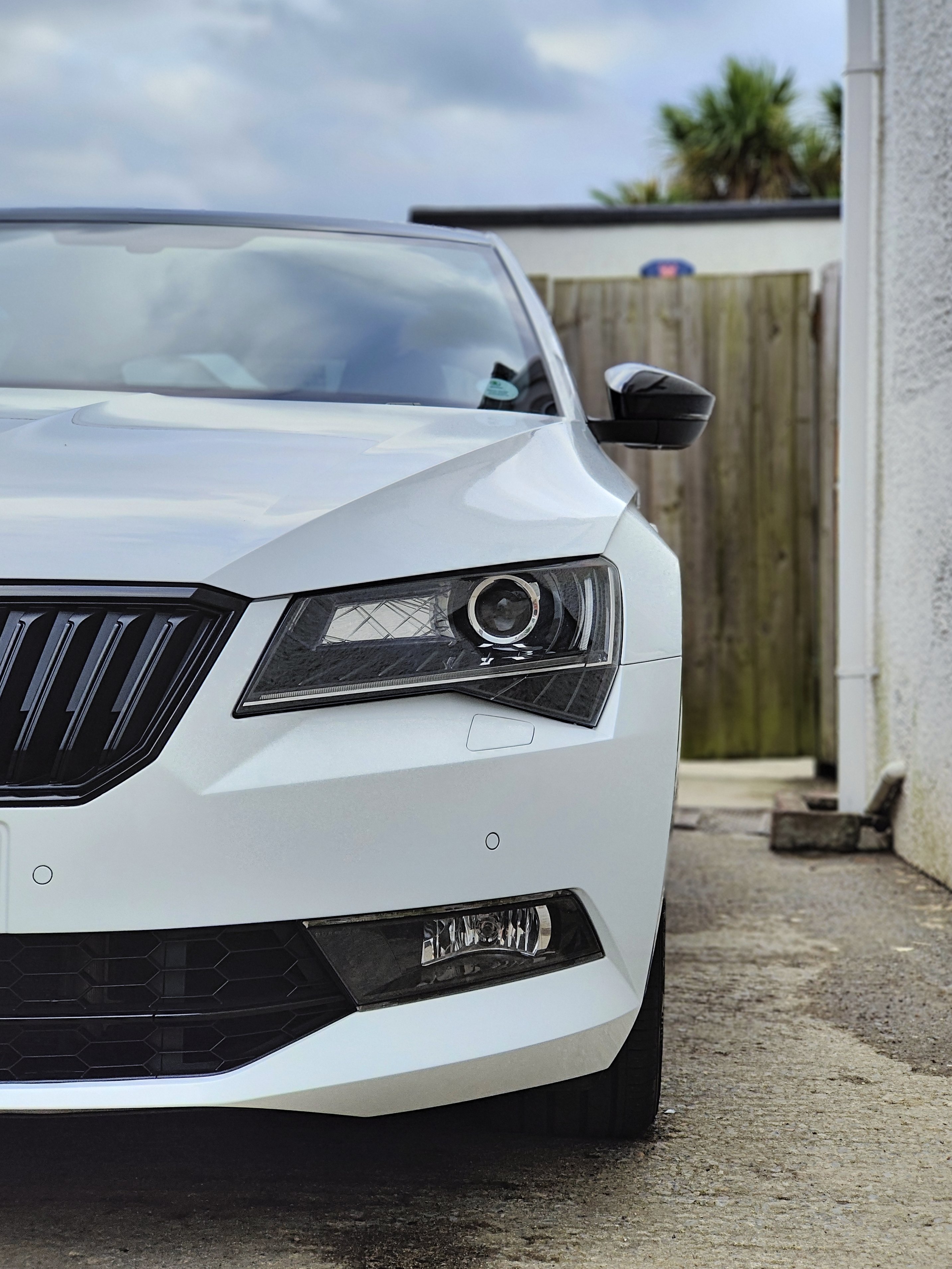

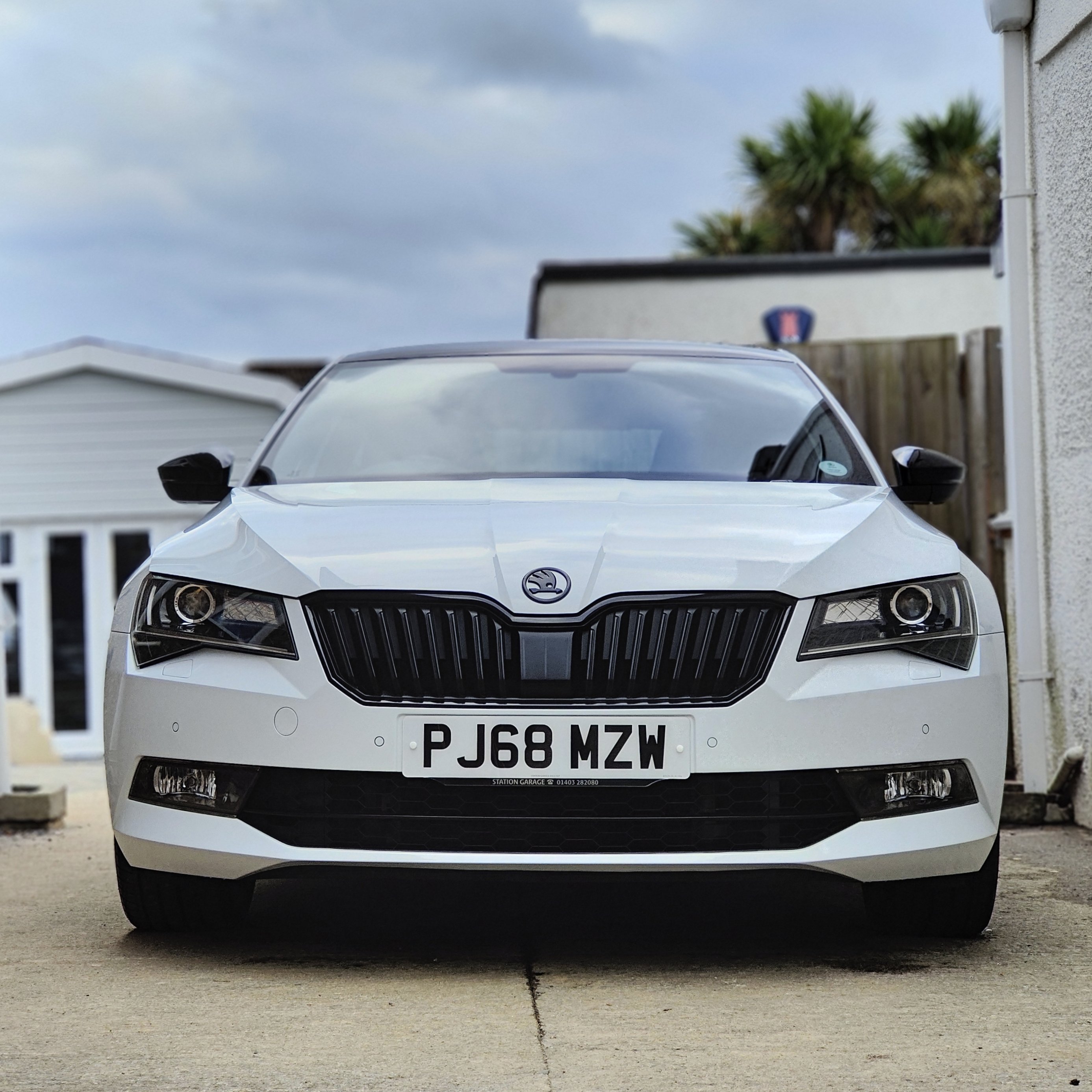

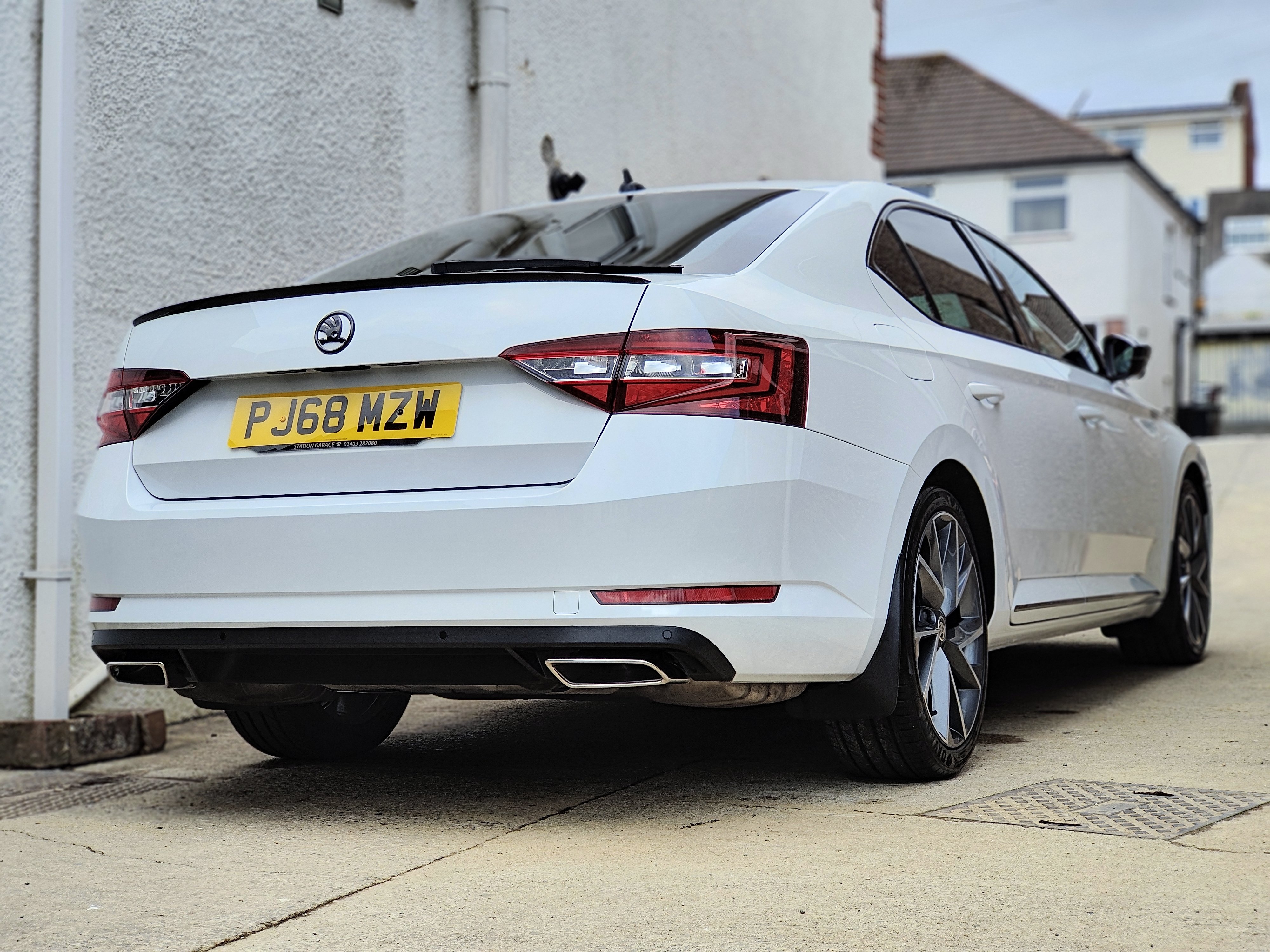

After a good clean, it comes up really well! IMG_20240924_175825.thumb.jpg.8cdb5e205974ea686719a51872912c0f.jpg
Little bit o'love goes a long way 👍

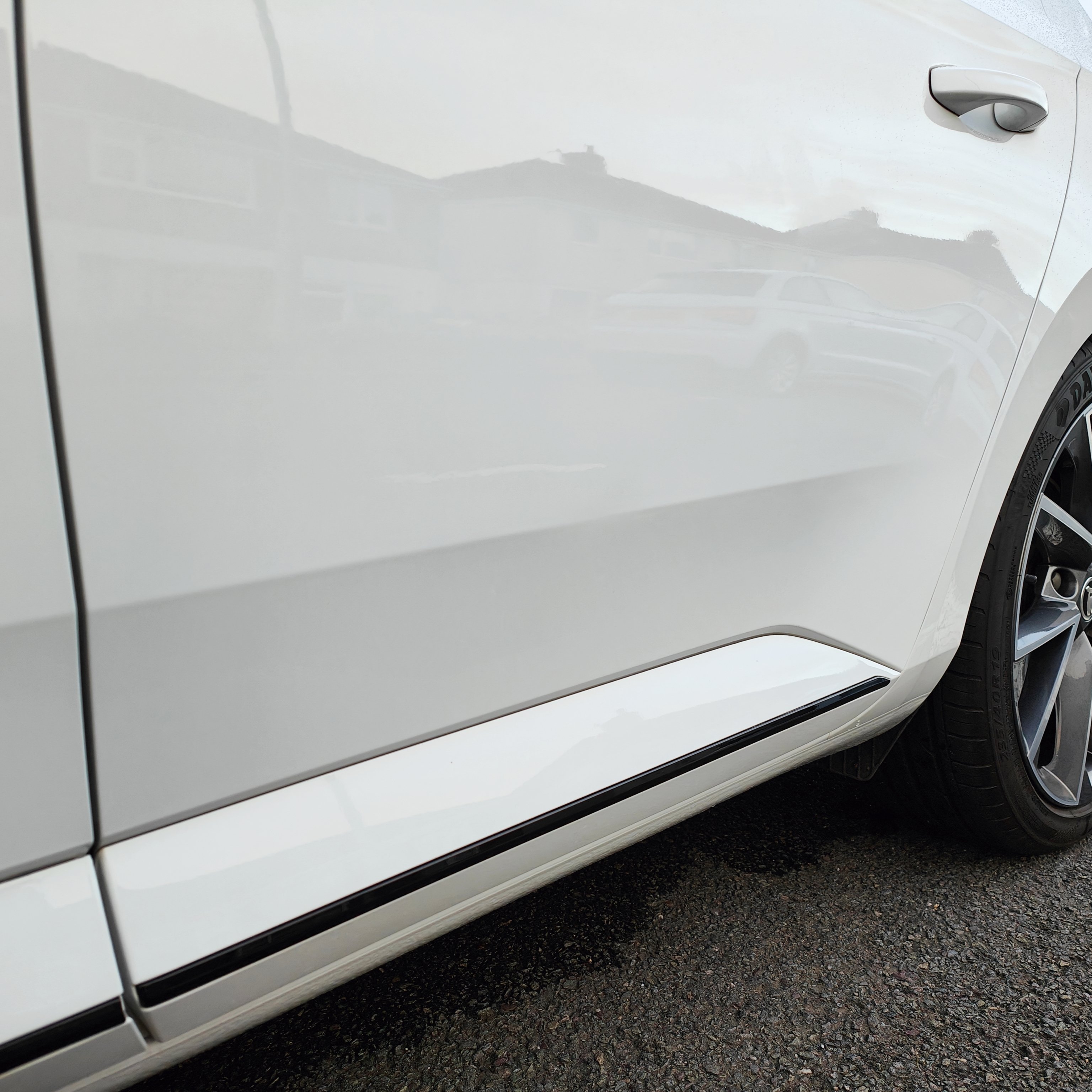

Dent removed! Jason from Autodentz was really friendly and professional, he made it clear that its hard to remove the dent completely without taking out crash structures in the door which is significant work.
The only ever so slightly noticeable bit is the factory crease is a little less pronounced in one area but its a huge improvement.
Before
After

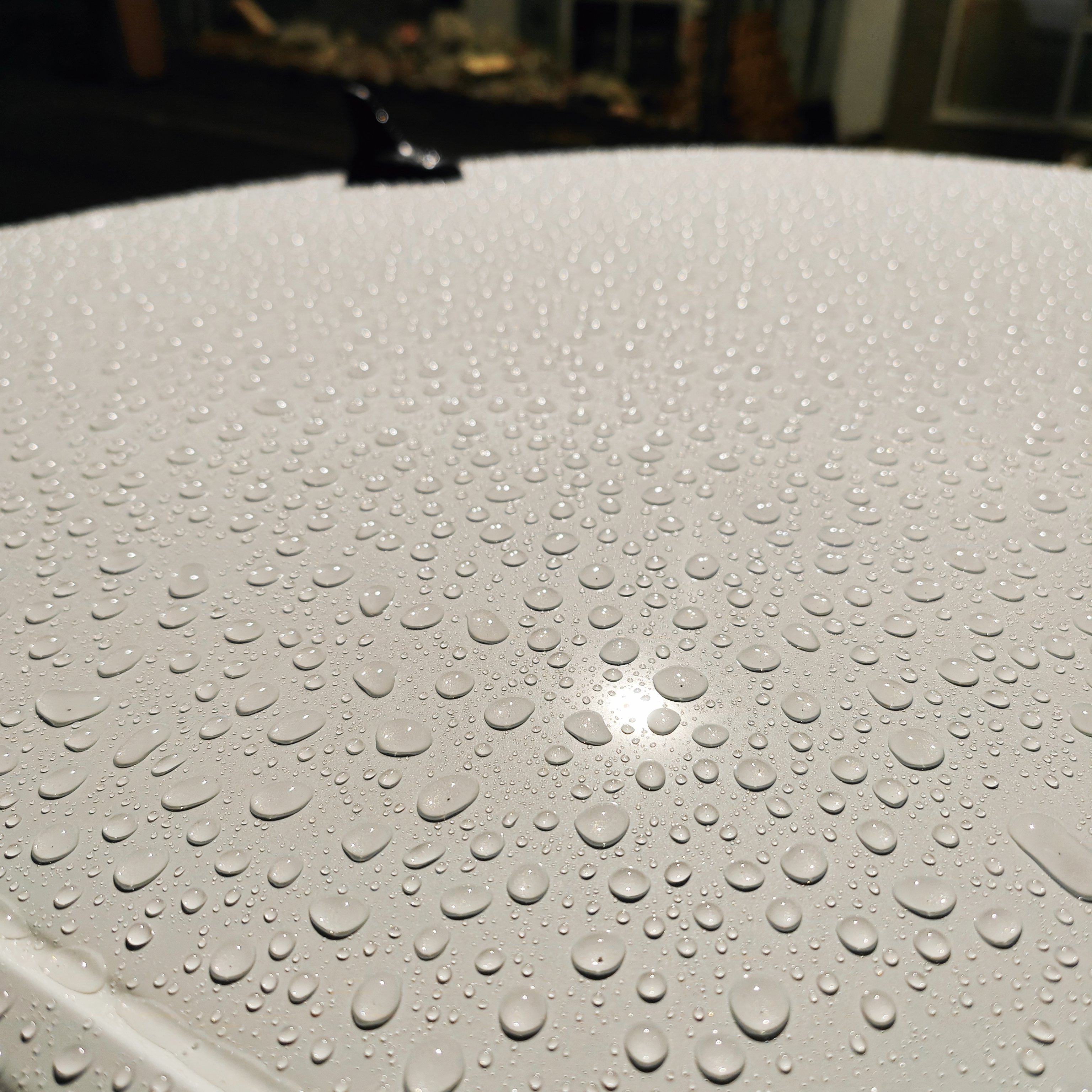

Look at the beading too!
Lovely looker and the beading is looking great too.

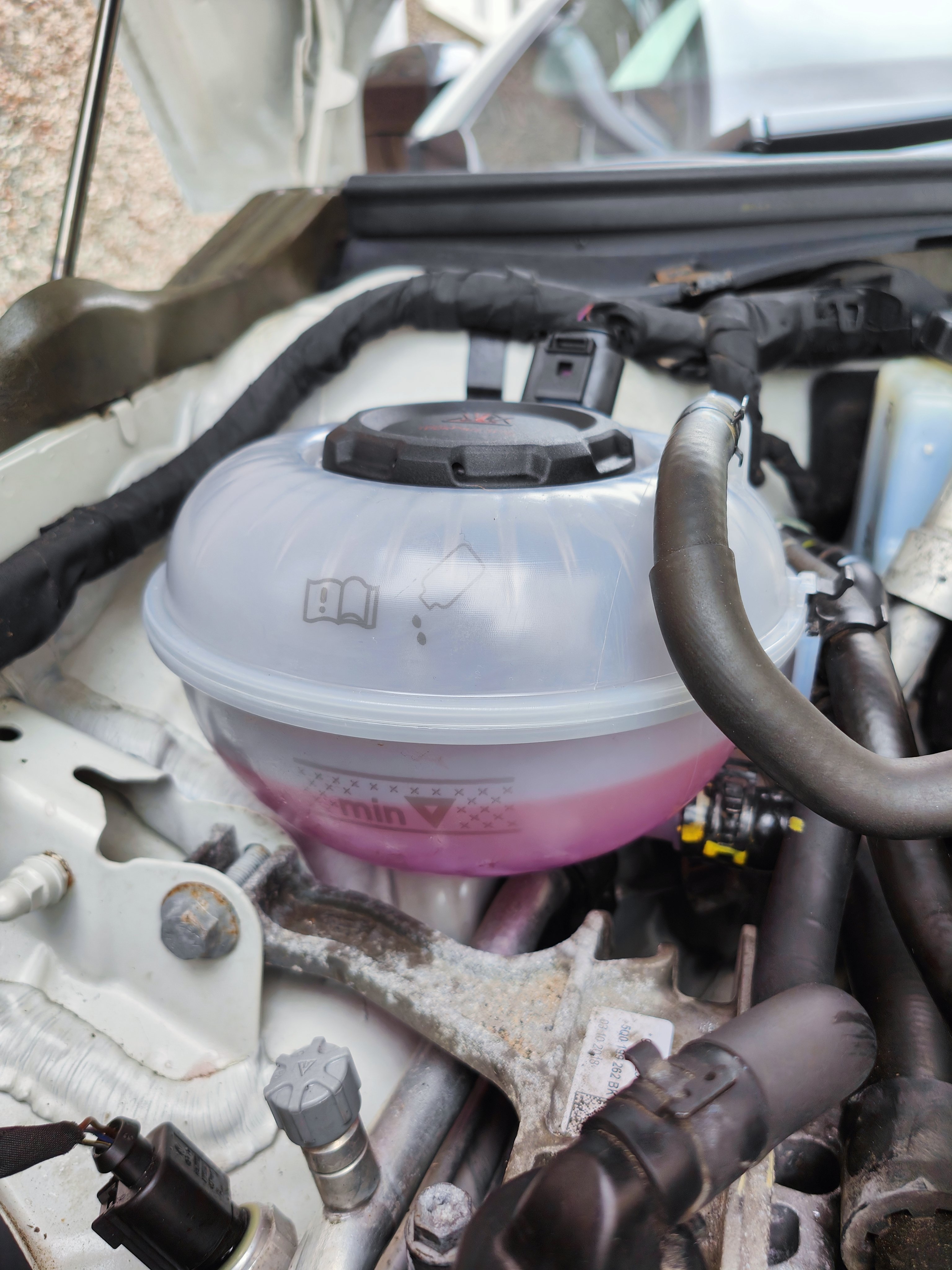

Another job ticked off the list, new coolant reservoir minus the silicone bag, bought from AW Tuning and supposedly a genuine bottle. Part number: 5Q0 121 407 M.
After removing the old one and draining it I could see the silicone bag in the main body so would have been easily removed but I didnt know if it was double skinned and hidden.
Easily fitted and some fresh G12 Evo to go with it too.
Did the old one have mit silkat printed on or look any different?
Yes buddy, it had 'Mit Silikat' on. I still have it, other than being a bit dirty and discoloured its fine though not sure what else to do with it. I've removed the silicone pouch. It looks basically the same.
