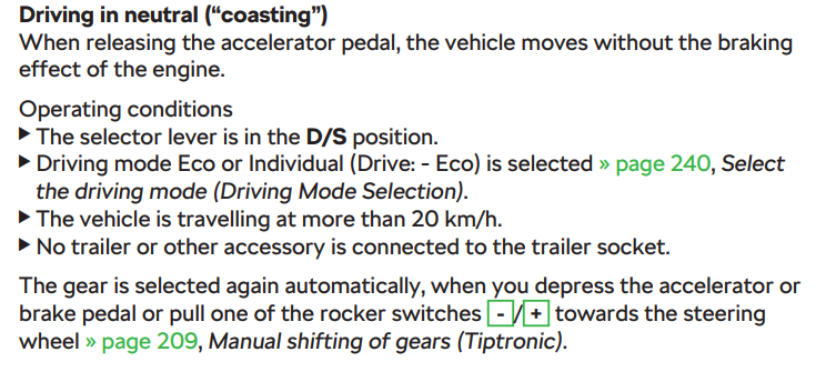

That would work, or if you have the ECO drive mode option you could utilise the coasting function.

Intersting suggestion about using the Edo Coast function.
Apparently the minute you touch the brake the car goes back into gear
