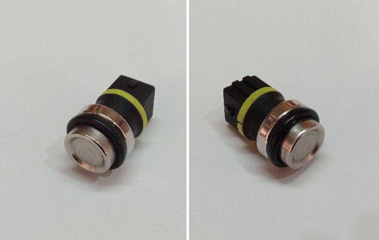

I have 3 coolant sensors with yellow ring, the 2 tested in the road and proved ****, with both of them i had higher coolant temperatures.
Here is the 3rd, take a look, no marks on it, would you trust this garbage?
Install a Blue with indications-part code on it and you will be fine.
