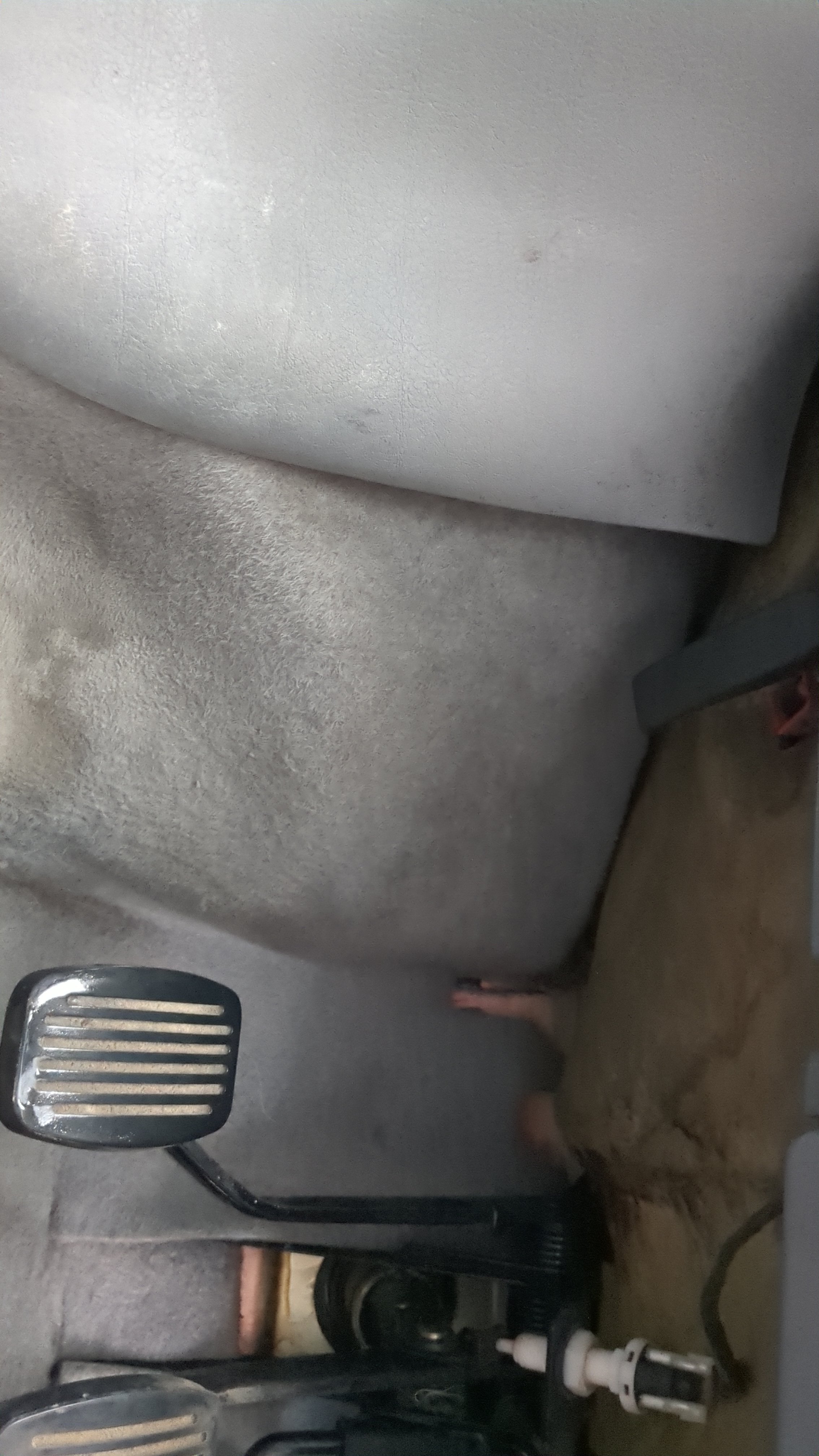

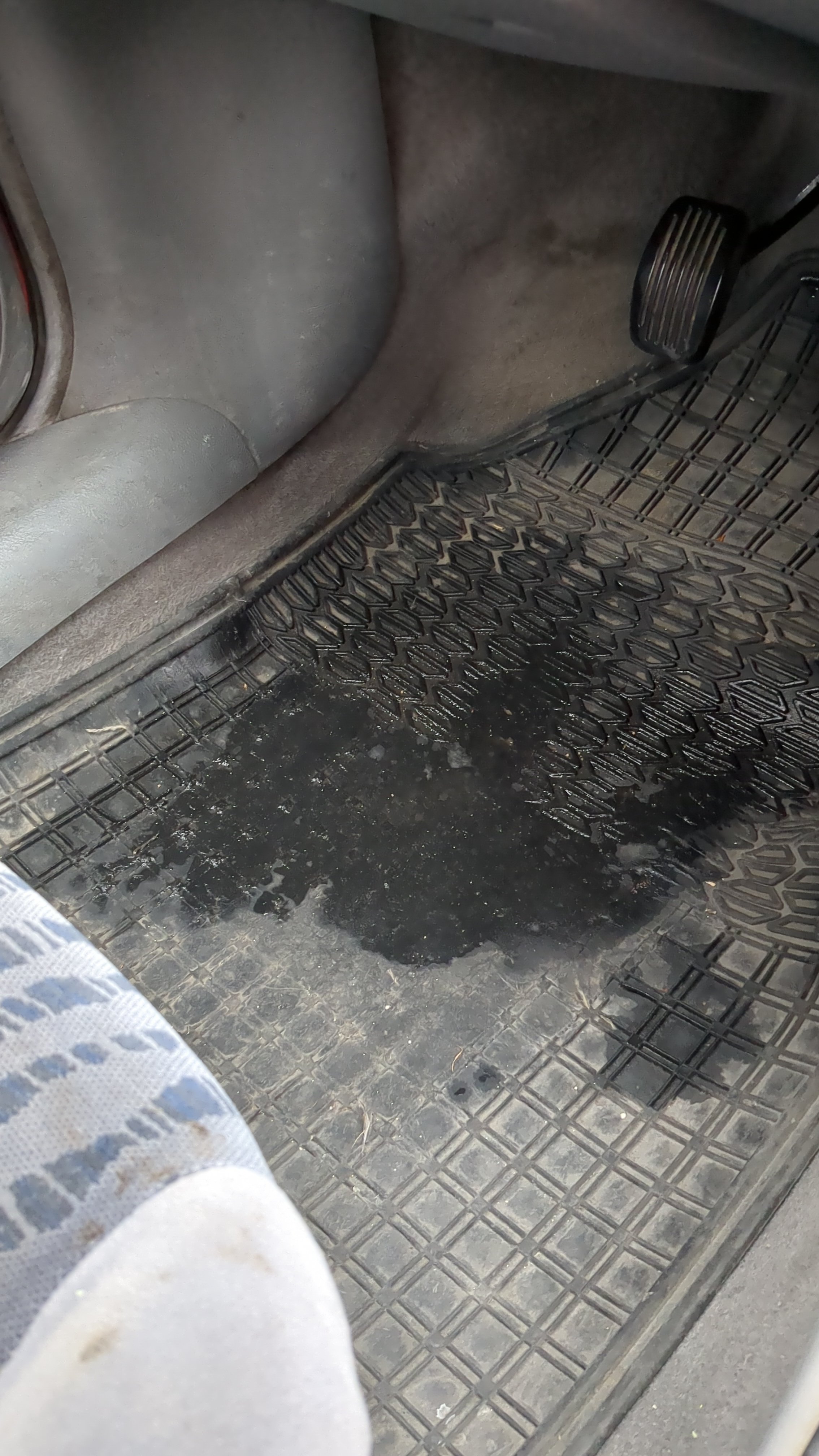

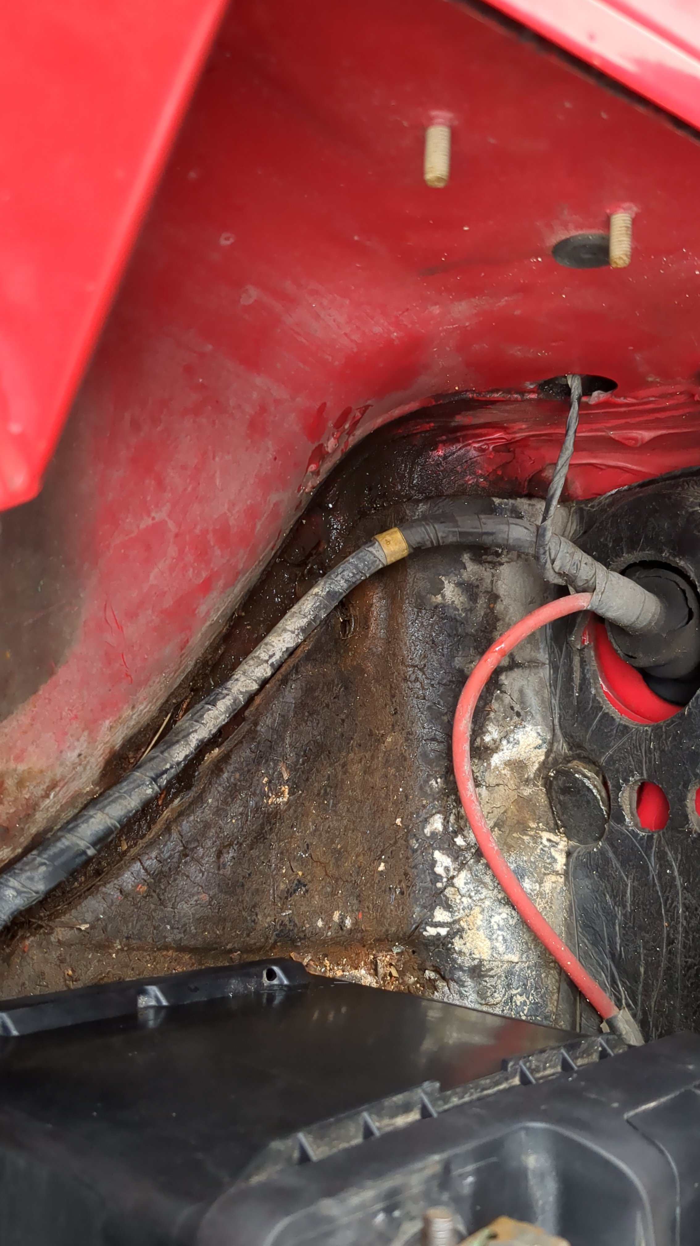

I don't know if it's ever happened to anyone to have water inside the car and with the sponge that's under the dashboard and right in front of the car where the battery and the grille are.
Whenever it rains, water starts to accumulate.
Check photos...
And here..
It seems to come from that hole in the blinker light.
Check inside the car..
Check here too
Sometimes you can find a tiny amount of water in those areas
because the black plastic cover does not have (like a Corvette) a sealant gasket with the car body.
After many years the gasket (in the oval shape) due to friction with the hood (open-close procedure) maybe will get rubbed and let some water drops to pass inside but ''No big deal".

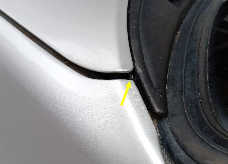

The arrow points the end of a tray which is beneath the black plastic panel in the Felicia.
Water (rain, car wash etc) that goes on the right side goes to that tray and then on the drain channels, water that might goes to the left end up inside the engine bay.
In the past i had ''sealed'' the sides and the front part of the hood like a |___| shape but proved that was a mistake, yes i had no water or dust inside the engine bay but the engine couldn't not ''exhale", the air was not circulated properly and the temperature inside was raised a lot.

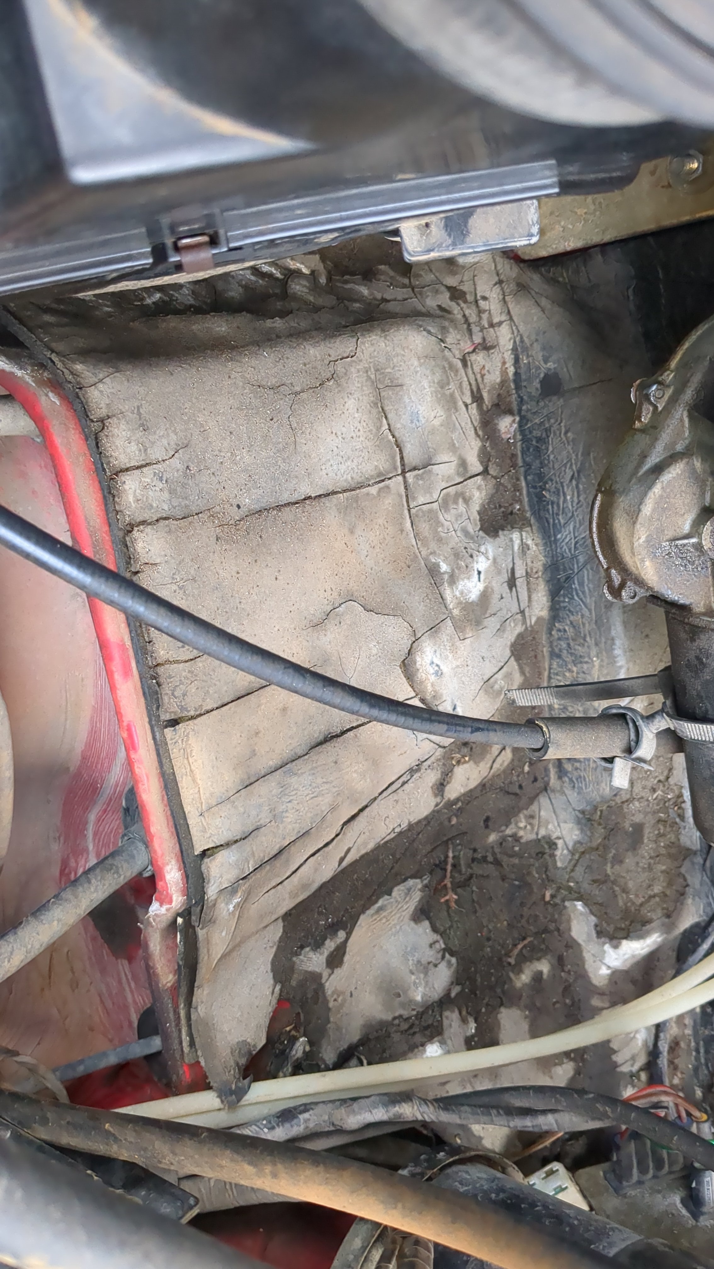

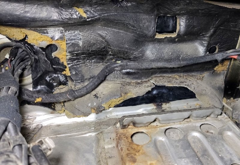

@Joob Take a look an older photo from my Felicia, it's the left side, age-heat-water etc can cause some problems.
Now the insulation has been replaced, i used sandpaper and primary for the oxidation in the base of the battery, the O cover where the cables come out has been repaired etc.
