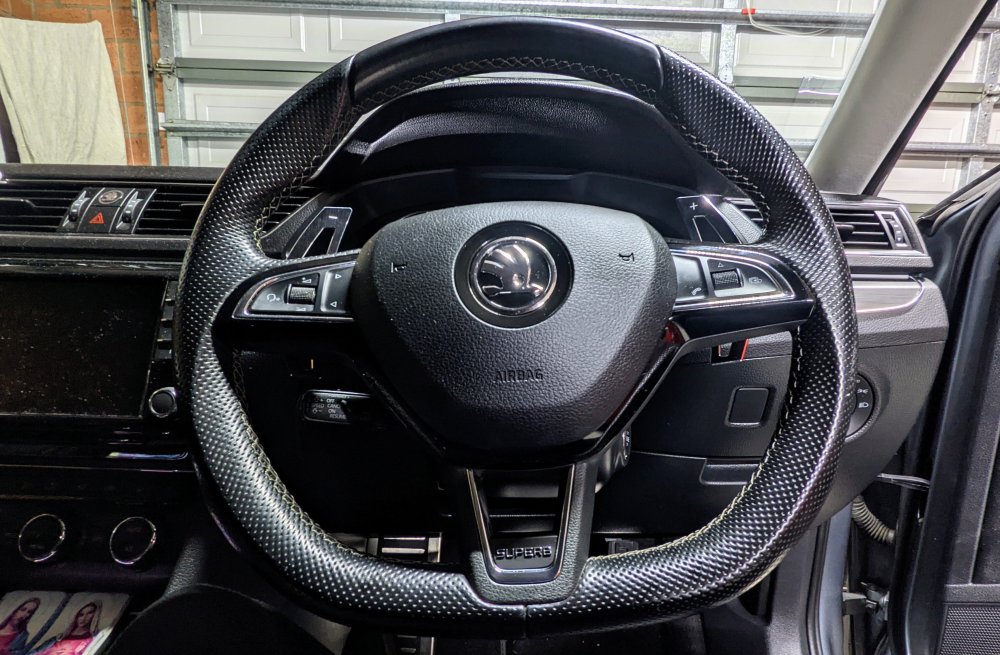

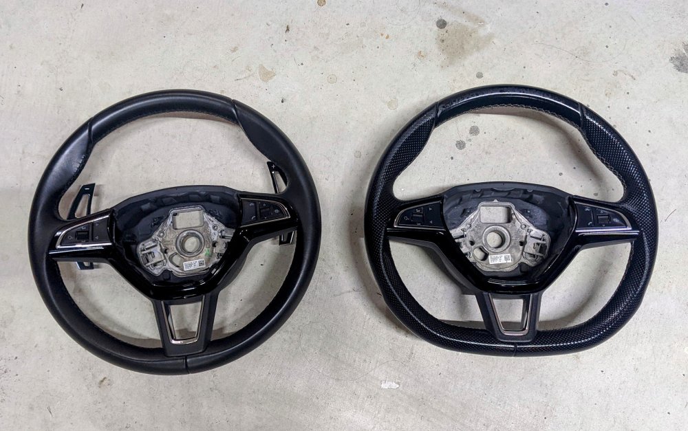

I've retrofitted a flat-bottomed steering wheel from mk3 Octavia RS to my Superb MY17 220.
No issues.
Left = original
Right = secondhand flat-bottomed wheel.
