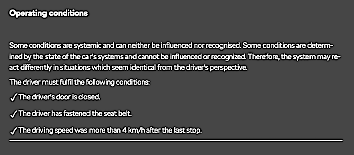

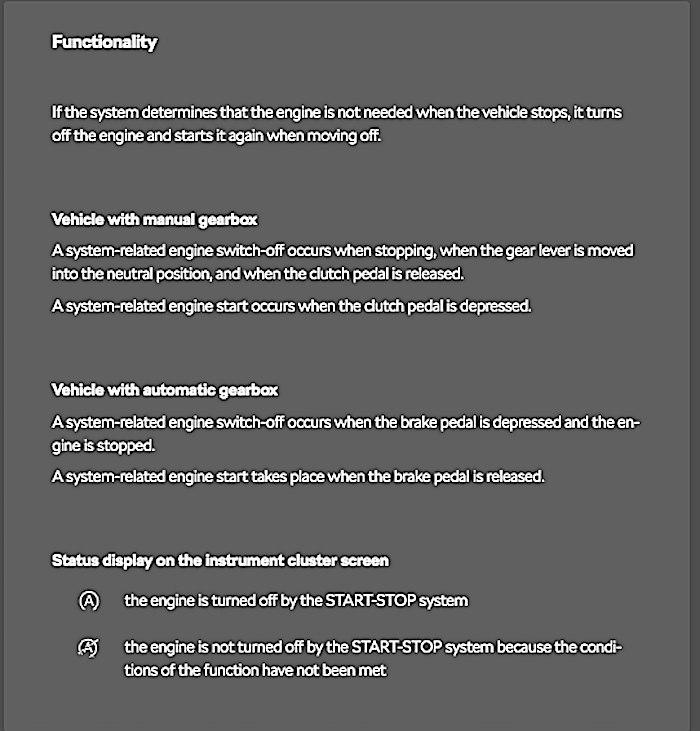

Within the START-STOP section of the Owner's Manual for my 2024 Fabia is this
Basically (rather like the logic of the cranky software I used to write when I was programming at GCHQ) most of the time the Fabia's START-STOP system works as the driver expects it to (and the Owner's Manual suggests it should) except for the times it doesn't!

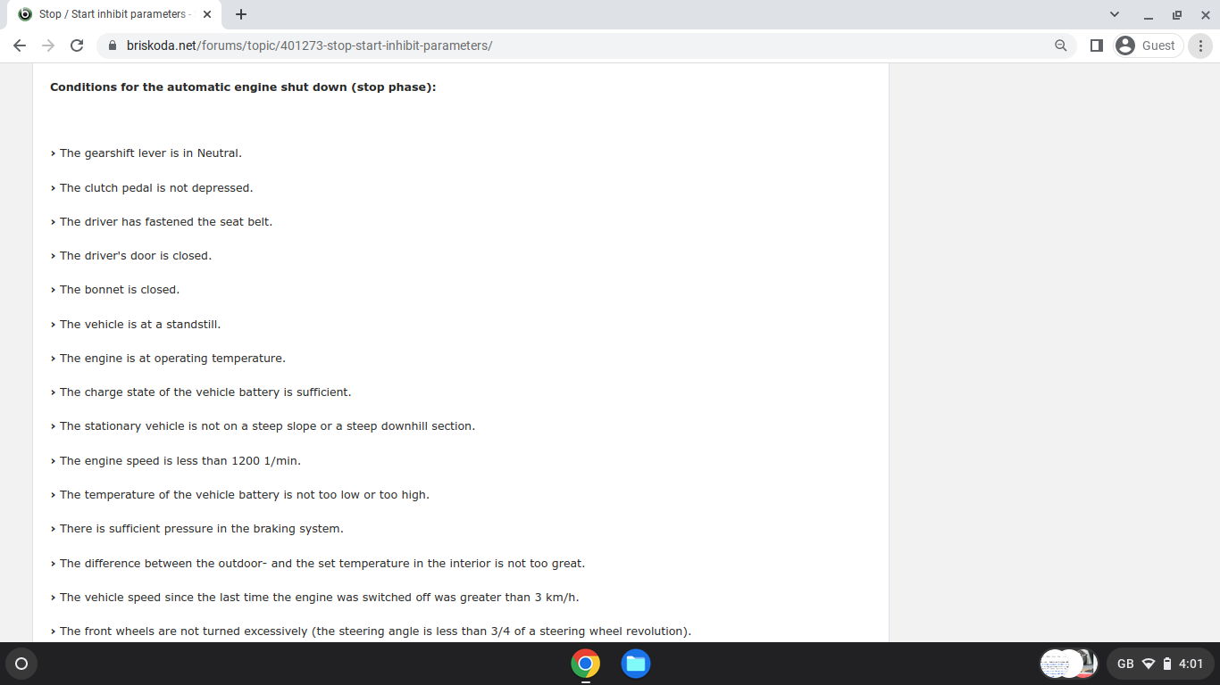

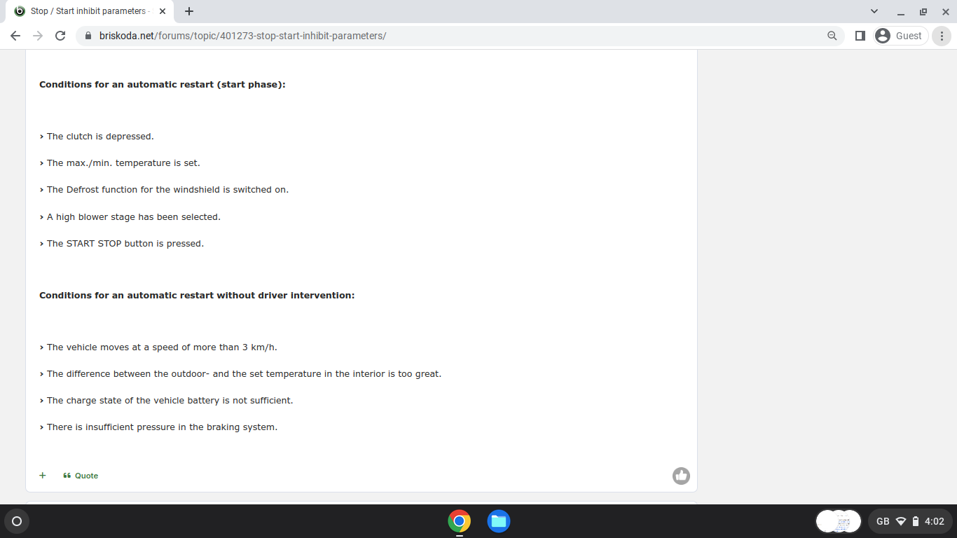

A GOOGLE-Advanced search of the complete BRISKODA forum group, using "stop" "start" "random" as the search criteria retrieves (as one might expect) a shed-load of results. Top of the results-list was this one
https://www.briskoda.net/forums/topic/514550-stop-start-rarely-works/
