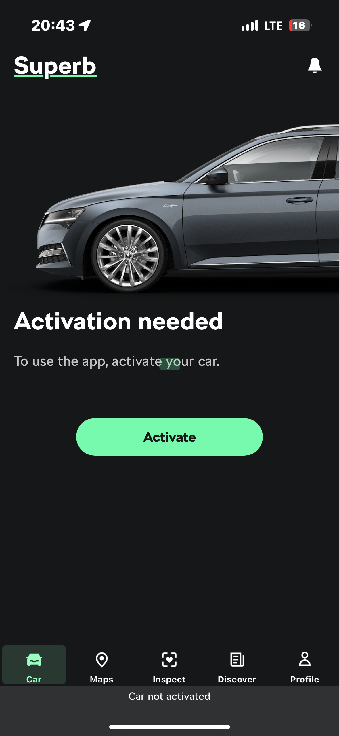

Now i have problem with myskoda connection.
I register car in app and now app show that there is needed activation.
Procedure is now in the car…i have two keys in car as says app.  I am logged in there.  Then i must be the master user so i click on car screen /becom a master user/ And then there is an error. So i cant get to be a master user.

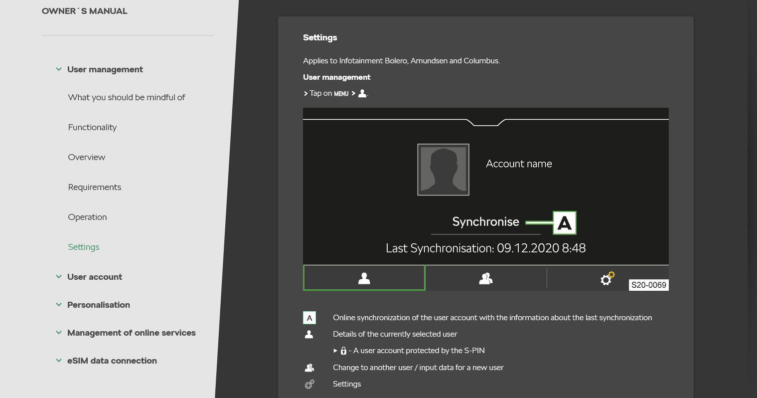

It might help if you go to the Skoda website and look at the user manual for your model year
https://www.skoda.co.uk/apps/manuals/models
Enter your vin for correct manual.
Then look for this page

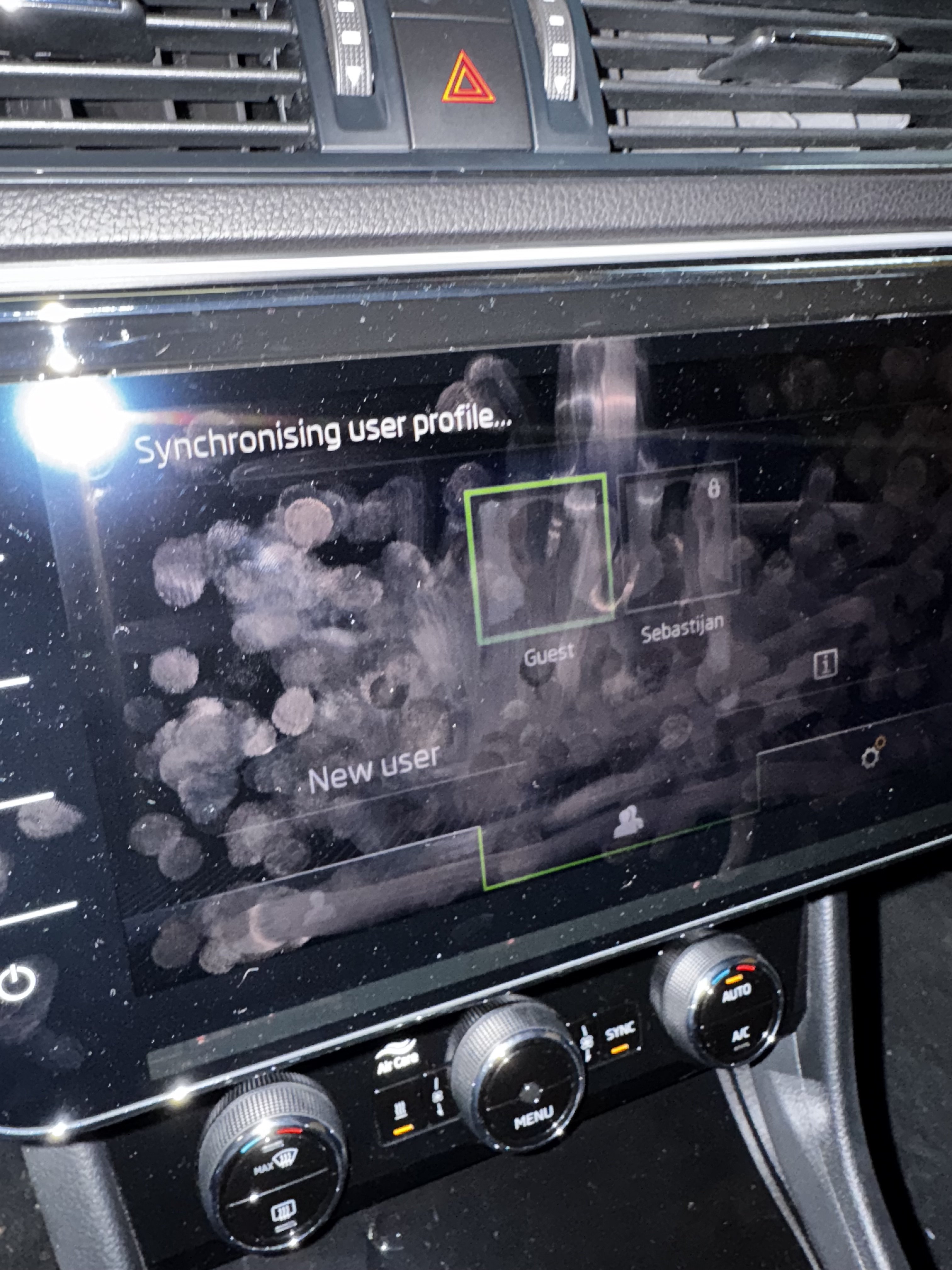

And then shows up welcome Sebastjan.

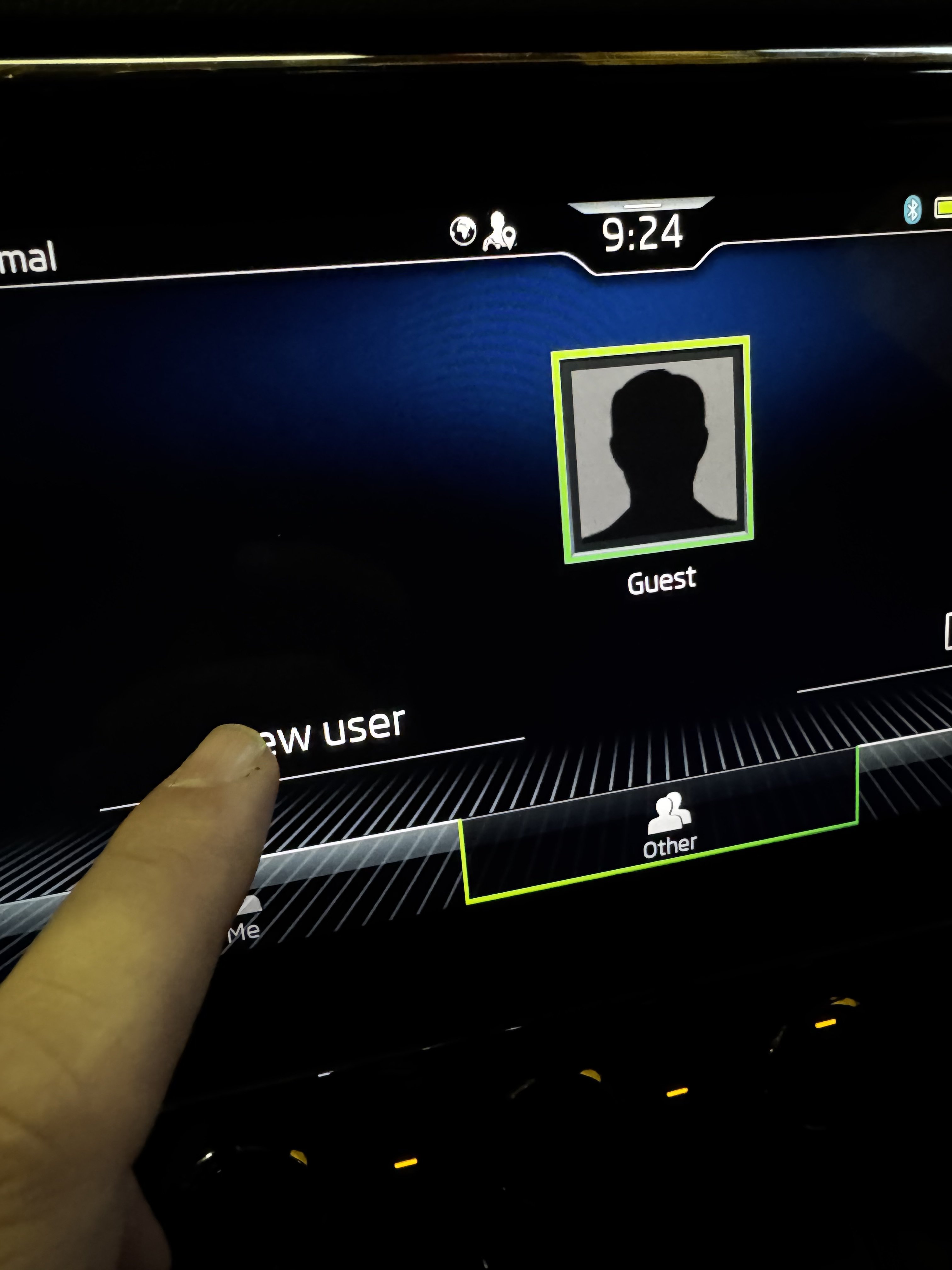

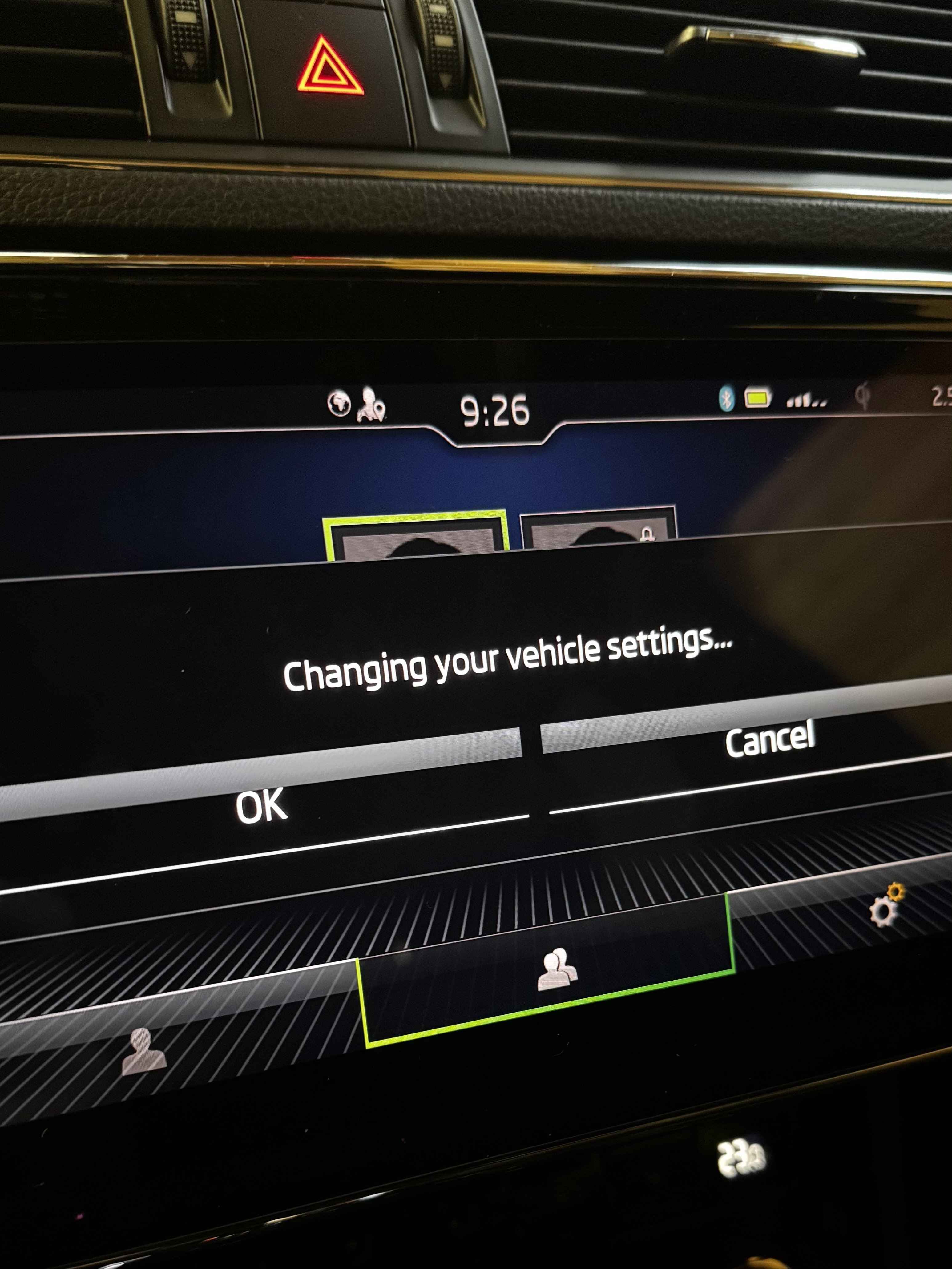

And afther that :
This vehicle has no primary user.
Would you like to become the primary user of this vehicle?
And then i click yes  and circle come in (loading)  for more than 15-20 minutes.  And then says error.
and thats it

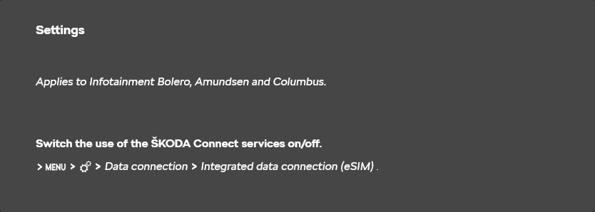

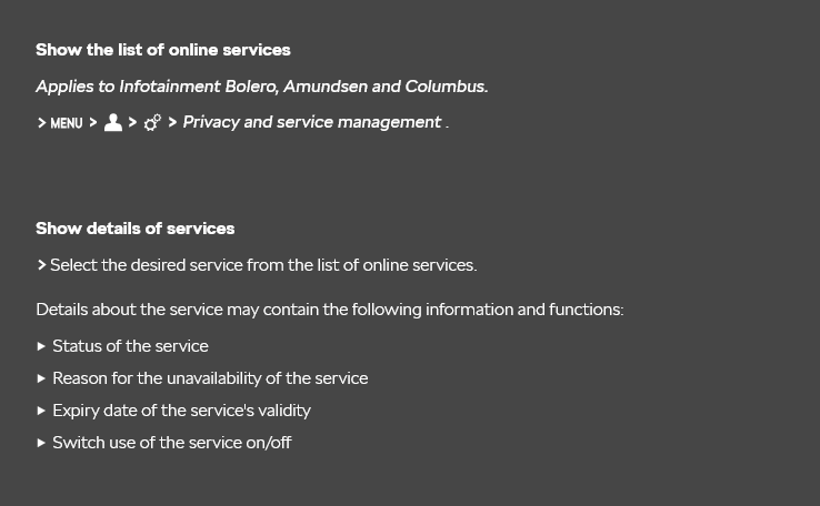

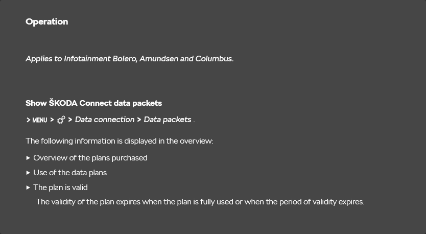

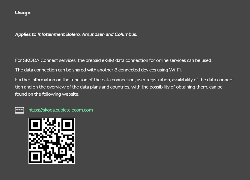

The car may not have a good internet connection you can check here
Hey

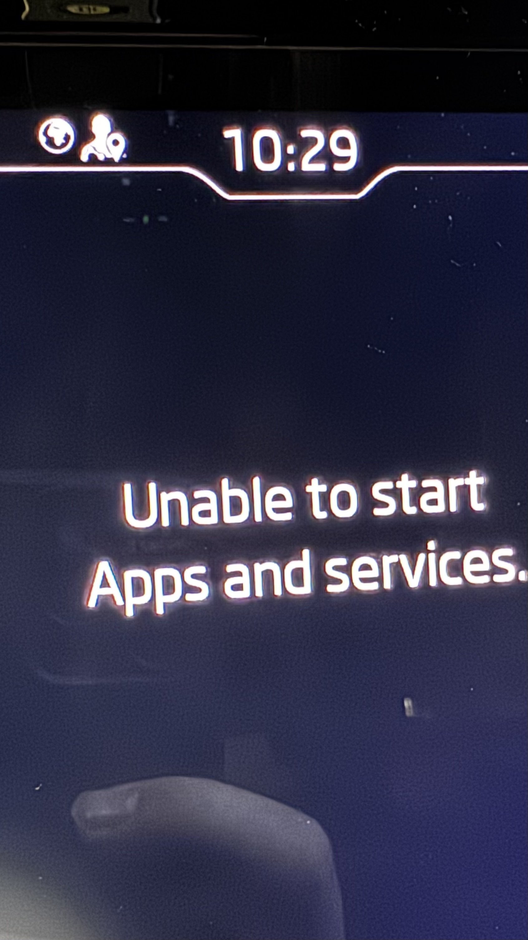

I got this:  Unable to start apps and services.
Edited by Seba800
Should on picture left from the clock be a lte icon and bars for signal?
Screenshot2024-12-01at10-56-16Skoda.png.c890b4b8393984e3ed079323c83d9a90.pngScreenshot2024-12-01at10-56-37Skoda.png.aa67e588479edb332d116728dedd9ada.pngScreenshot2024-12-01at10-56-55Skoda.png.ec08405dd43504fde4b13c18aca6c617.png
Have a look there?

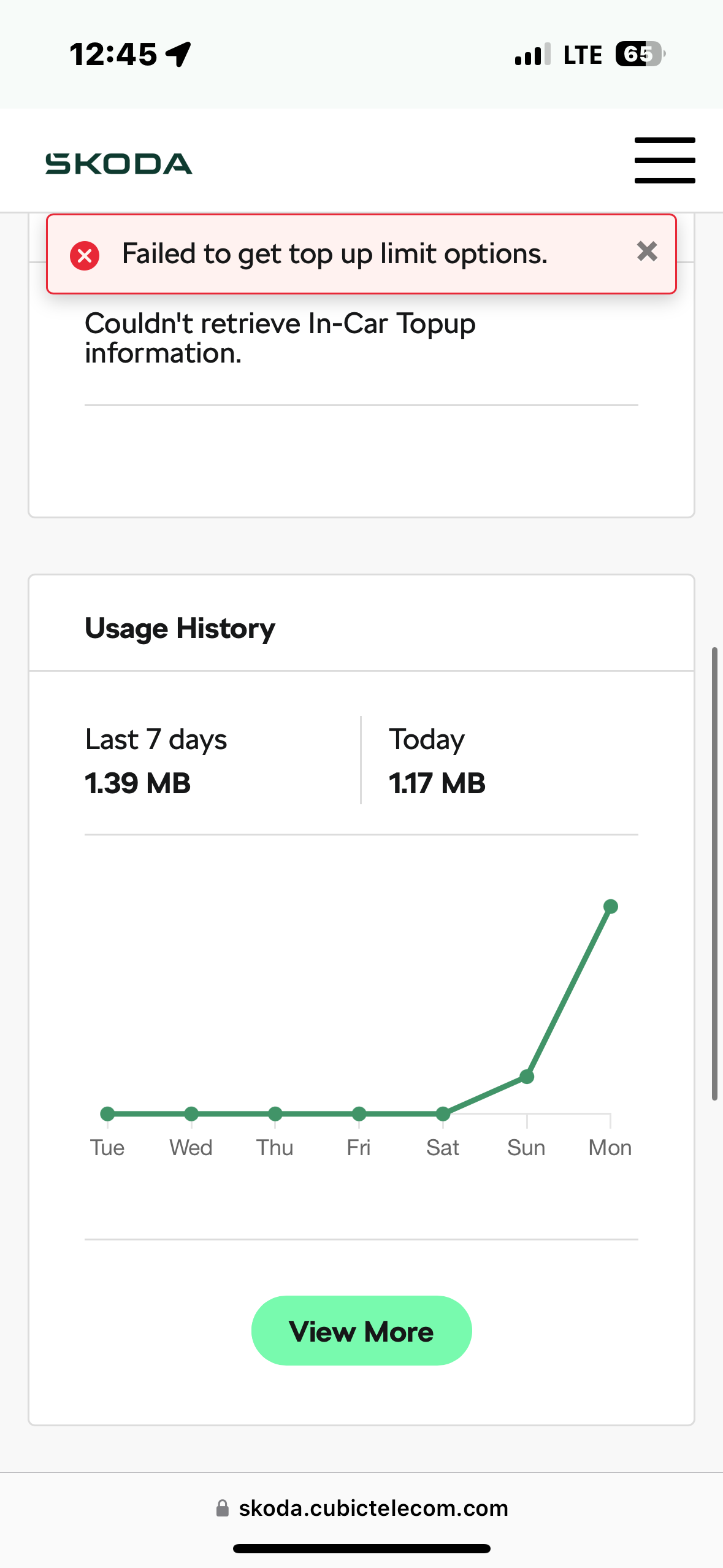

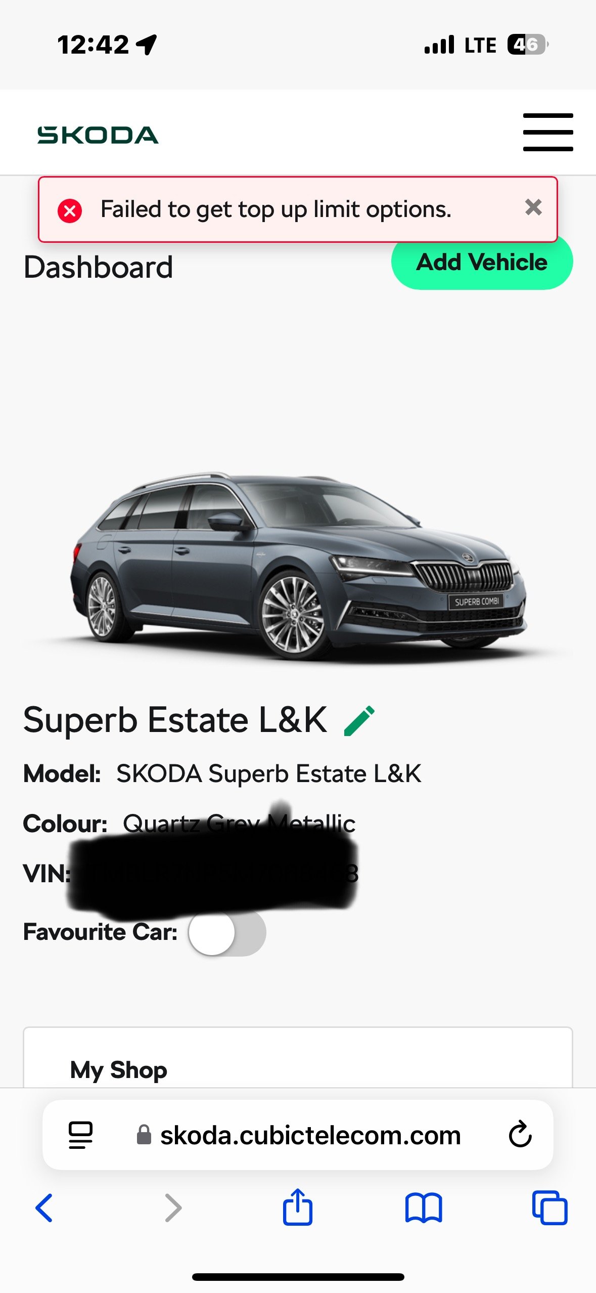

I buy now dataplan for my car.
Transaction was sucess.
But up at the picture is some error message.
And car after i activate is the same. No lte and cannot be master user.
I was hoping you would have started at the top of the screenshot rather than the bottom before paying out any money.

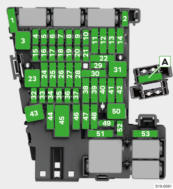

Another possibility to force a reboot of the infotainment and simcard system is to remove fuses 12 and 17 in the dashboard fusebox for a few minutes.
But I cannot find confirmation that it works. Or if it will create other problems.
