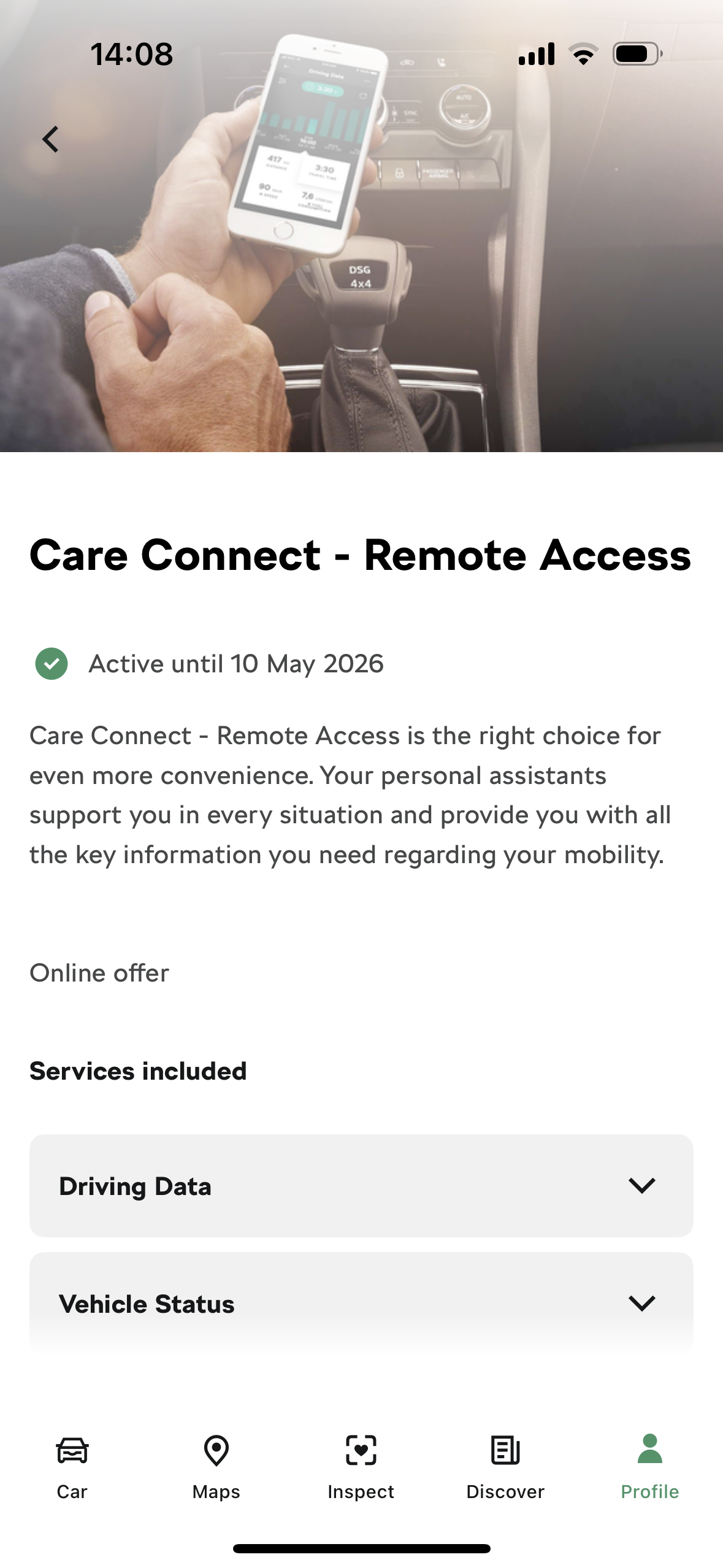

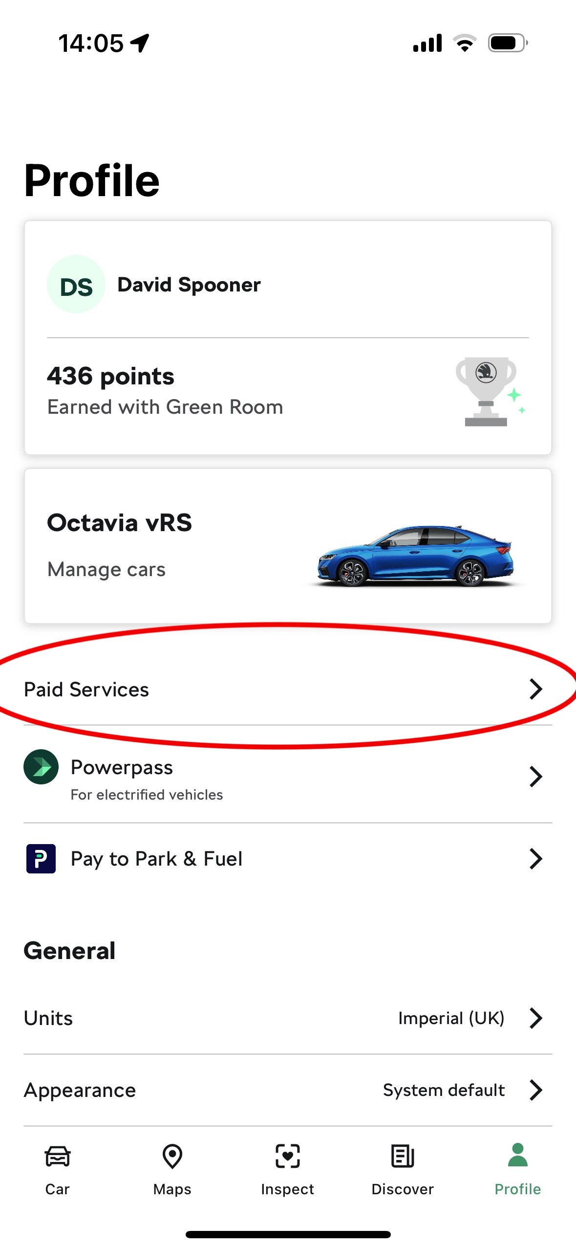

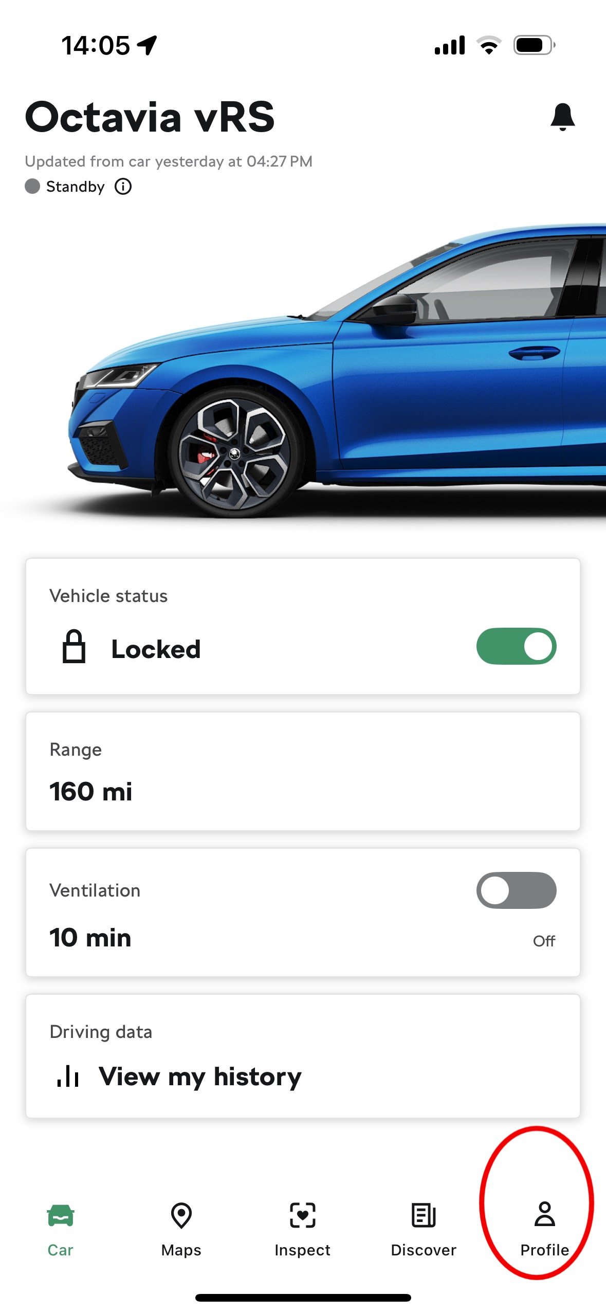

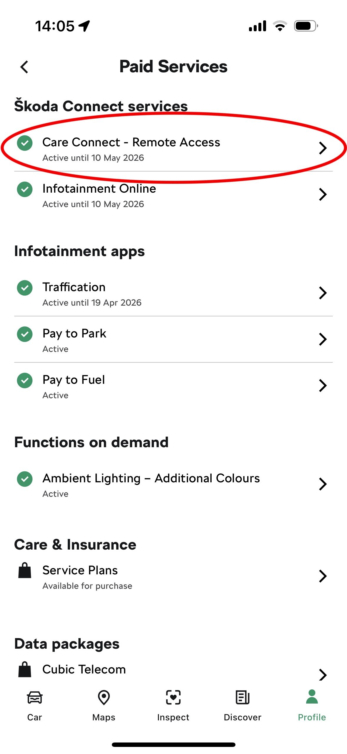

Makes sense....... They are saying your Skoda Care Connect expired on 8th February this year so you need to re-subscribe.... What you have purchased already as we have said from looking at your photos is the Cubic Telecom data package which is something totally different and just means passengers can use your car as a wifi hotspot then use that data to browse the web etc.....  Can you show us via a photo the screen you have that says you need a code to use the Care Connect as you should just be given the option to buy in the app.
In my app it's as follows.....
In the MySkoda app you need to press Profile.
then paid services.....
then it will show what status your Care Connect and other services are.......
Then if you touch Care Connect it takes you to Care Connect screen with details of what it can do and should give you a button to purchase (I don't get that button as I am already subscribed).
